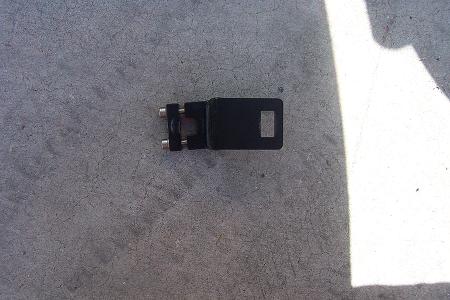

Here's pic of the new arm.
It's typical Rodney quality. Those of you who've ordered from him know he makes great products, reasonably priced, and he ships things fast. In short, my favorite Fiero vendor. The scratches you see are from me installing the arm and then taking it back off for pictures.
A pic of the OEM arm installed:

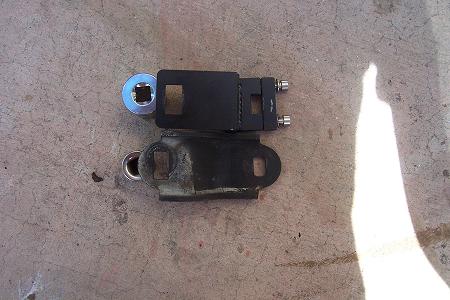

And a picture of the OEM arm and Rodney's side by side:
You can ignore the sockets, I was just using them to prop the arms up . As you can see, Rodney's arm is shorter than the stock arm, and it has a slight angle compared to the original arm. According to Rodney, the new arm is angled because the OEM arm has one of the holes cut at an angle.

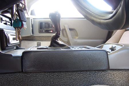

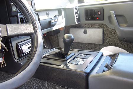

OK, here's some views of my shifter with the original OEM arm installed. I don't take the world's best pictures, but hopefully they'll give you an idea. I'm using an 84-style shift lever, and this view is 1st gear:

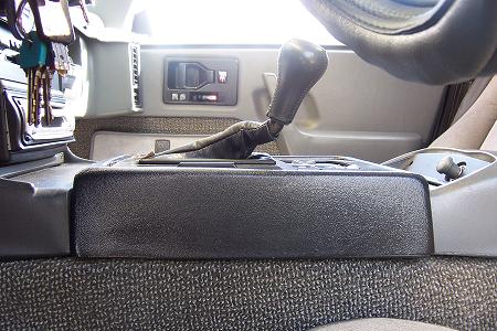

And here's 2nd gear:
Another view of 2nd with the OEM arm installed:

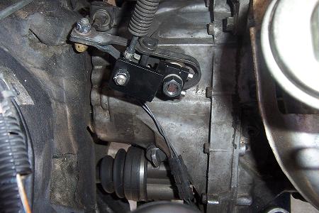

And a shot of Rodney's new arm installed:
Installation is SIMPLE. Just remove the nut and washer holding the shift cable to the arm, remove the nut and washer holding the arm to the tranny. Install the new arm, and tighten the hex screws. Then just bolt the arm to the tranny and the cable to the arm. Takes all of 5 minutes.

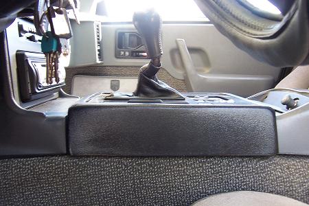

OK, now for the moment of truth. How much reduction in throw am I going to get? Here's a shot of 2nd, with Rodney's arm installed:

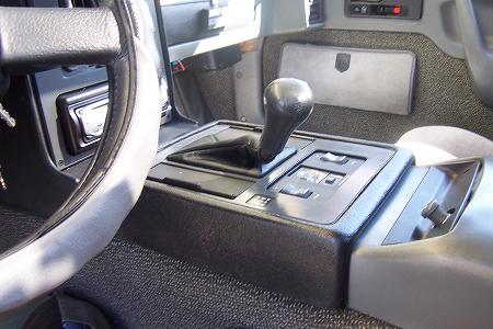

And a different angle of 2nd:

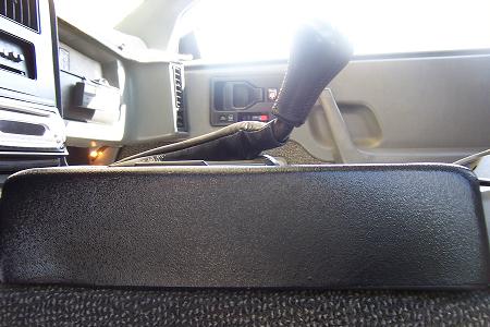

And for good measure, a view of 1st with the new arm:
Using some tape and string, I measured the throw with the old arm, then again with the new arm installed. And I also dug out my original, longer shifter lever, to compare it to the short 84 style I'm currently using. I'm getting just under an inch of reduced travel from 1st to 2nd, with both shifters. That may not sound like a lot, but it really transforms the feel of the gearbox. It feels much tighter and more precise than the stock setup. There's a *very* slight increase in shifter effort, almost not worth mentioning. I also don't have to reach as far when the shifter is in 1st, 3rd, or 5th. That makes for a more comfortable shifting position.
I wanted a 2nd opinion, so I had my wife try it out. One of her biggest dislikes with Fieros has always been the long shifter throw, so I wanted to see what she thought. She didn't even notice the increased shift effort, it's that minor. But she really noticed the reduced throw. Her comment was "now it feels more llike a sports car, and not like our pickup truck."
Here's the 2 views of 2nd again, the 1st is with the old arm, the 2nd is with the new arm:
Overall, this is a really nice product. It's built well, it's easy to install, and it works as advertised. Great work, Rodney, and thanks again for letting me try this out.
