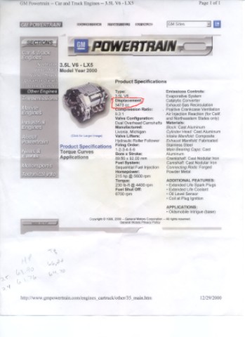

Wow that is a cool list of engines for swaps but I saw a mistake in it.
You list the 3.5 (LX5) Short Star as being 3423cc, then in the section of HP per L you list it as being 3.589L and pnly having 61.42HP per L. The actual displacement is 3473cc for 61.90HP per L. So the torque is 66.20 per L
Also you have the 3.4 (LQ1) as having 215HP but it is only listed as having 210 HP for 61.76HP per L. With 64.70 TQ per L
I know not a big deal, but the power curve is much better in the 3.5 S*. It starts making more power sooner and keeps making it after the 3.4 starts to fall off. And then the 3.5 has a much longer life with better fuel economy
Rickady88GT QuadCam 3.5 V6

Report this Post02-04-2004 09:05 PM Click Here to See the Profile for Rickady88GTSend a Private Message to Rickady88GTDirect Link to This Post
You made a mistake. you listed two different displacements for the 3.5, 3423 under displacement and 3.598L under HP/Liter. But acording to GM powertrain.com the actual displacement is 3473.
Sorry about the lame pic but I scaned the info because it is no longer on GMpowertrain.com

linenoise
Posts: 3789
Total ratings: 121
Report this Post02-04-2004 10:35 PM Click Here to See the Profile for linenoiseClick Here to visit linenoise's HomePageSend a Private Message to linenoiseDirect Link to This Post
Ok you got me, glad it's still a work in progress.
