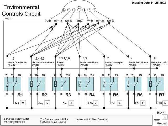

Wow, this is the first ever thread directed at me, and I almost missed it.
Ironically I have been shopping on eBay looking for a set of environmental controls that would work better than the firebird.
Reason is that the rotary switches that I was able to buy only have 7 positions, that's not enough to line up perfectly with the Firebird controls. I believe the Grand Am has 7 so that might work better.
Also, I prefer having a separate switch for the A/C compressor, (firebird doesn't have that). On my GT I used the rear window defogger as the A/C switch but that wouldn't work as well if the car actually has a rear window defogger.
My circuit that I built converted the rotary inputs into Fiero logic. It's not particularly sophisticated, but it was a pain to build because it has a bunch of relays and diodes.
I'd be more than happy to share my design with anyone who wants to build one...I don't know about actually selling them, to make it commercially viable the cost would probably be higher than anybody would be willing to pay.

jscott1
21676 posts
Member since Dec 2001
You can see what I did here:
http://home.houston.rr.com/jonm/firebird-10.htm
I need to made a CAD drawing of my circuit and post it. I'll do that now, since I have a little time over the holidays.

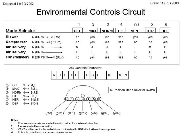

Report this Post11-27-2003 12:00 AM Click Here to See the Profile for jscott1Send a Private Message to jscott1Direct Link to This Post
I just made these, hopefully they will be useful to someone contemplating a swap.
I realized after looking at my drawing that I used a 6 position switch. I didn't implement the "VENT" position because it's identical to "NORM" but without A/C. Since I have a separate switch for a/c it would be redundant anyway.

Report this Post11-28-2003 08:00 AM Click Here to See the Profile for 1986GTV8Send a Private Message to 1986GTV8Direct Link to This Post
Wow, more infor that I expected!
Thank you!
Though I am still a little leary of doing the controlls. Just a thing that I need to get over....
John
