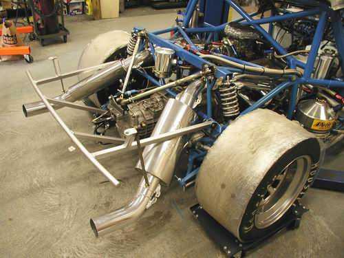

I’ll start with the exhaust. After two separate one week delays, Brett (custom exhaust fabricator) committed to a Sunday drop off date of June 12th, Father’s Day. The plan was to trailer the car to Chicago and leave it with him for a week to fabricate the exhaust. I would then pick it up 6 days later on Saturday in order to gain as much fabrication time at home as possible. I arranged to leave the trailer up there to save fuel on the way back. When I got there, we unloaded the car and pushed it in. Unfortunately, I had a dragging PS rear rotor at the time that made it really tough to push. I was so bad in fact that it took me nearly 4 hours to load her up! Anyway, we discussed the layout and the direction the 1 ¾” primaries and 3 ½” collectors would be located. We decided that the pipes would need to go on the high side of the heads and through the triangle opening in the removable rear shock tower support. Kind’a tight. Each of the Borla XR-1 mufflers would need to be angled at about 45 degrees back and to the side to fit. All of the connections would be slip-fit and I told him I wanted the entire system ceramic coated. Since he and I had been planning for a while, he already had the materials in house to perform the task. I told him again that I must pick the car up on Saturday. After our discussion, he showed me some of his “toys”. He and his group make a Lola T70 kit car that they hope to sell to the public in the near future. This car took 1st place at Carlyle just 3 weeks before. He also showed me a 67 Mustang fastback road race car running a 351 with over 600hp! They had built the car from the frame up and claimed that it had a perfect 50/50 weight distribution both longitudinally and transversely. Next he showed me a Porsche 914 he had built with a SBC. He was selling it for a new project. Last he showed me his Fiero that he was putting a 3800SC in. This is one of the reasons I agreed to let him do my car. Not only was he a kit car builder, but he was also a Fiero fan!
Brett worked on the exhaust all week and when I came to pick it up on Saturday, he had not gotten the tubes TIGed together yet. Only the tack welding had been done. After I examined the construction, we disassembled it so he could TIG it together that coming Monday. As I had guessed, several things needed to be changed to get the headers to fit. Along with other items, I would need to move the oil filter location away from one of the primaries. Separate from the exhaust issues, it was also pointed out to me that the front brake duct outlet would need to be relocated to help cool both sides of the rotor more efficiently. This could be done by aiming the outlet near the hub and blocking off the open holes through the rotor mounts. This would in turn force the air through the 48 vanes of the rotors and cool both sides. After the information exchange I connected the trailer and we loaded the car. Brett would send the headers to LOKO in a suburb of Chicago to get ceramic coated and then they would be shipped directly to me. It was estimated that it would take a week. Naturally I was concerned. At the time I was planning to take the first week of July off as a last ditch effort to get the car ready for the CFOG-I 20th event. One week meant that I would get the exhaust on Thursday of that week with only 3 days to spare before the planned startup date. Luckily they arrived on Wednesday and by the end of Thursday, they were installed. As a side note, they were very difficult to install. The slip-fit was tight and the tubes seemed to move during the final TIG welding. I will correct this problem the next time I take it apart otherwise it will be a chronic problem for years to come.

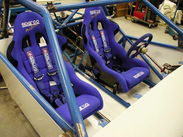

During the wait time for the exhaust, I was fabricating several other systems including the coolant lines. I purchased some aluminum tubing from HRP. I purchased several 90 degree bends and straight tube sections in both 1 ½” and 1 ¾” sizes. I cut the bends to the proper angle and hose clamped several tubes together to form the correct shape. Using a tip from John Callies, I drilled holes in the clamps before use so that the aluminum could be tack welded together. That way the clamps could be removed to allow for a full TIG weld around the seam. After figuring out what tubes needed to be made, I disassembled all of the smaller pieces and packaged them to be shipped to John. He had offered to bead the tube ends that would have tubing clamped to them. Since beading machines are hard to find, I took him up on his offer. One week later, they arrived on my door step completed. Thank you, John! Next I took them to a local welding shop that specialized in welding pressure vessels. They did a great job. After that, the installation was simple. Since the tubes were the correct shape, all I had to do was connect them to the hoses and components, and clamp them. This final install of the tubes also took place during my time off the first week of July.

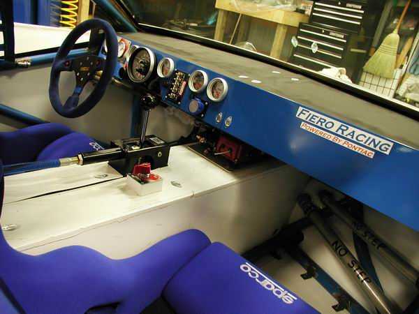

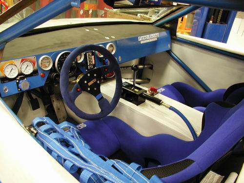

As part of the electrical hook up, I fabricated the dash board. The goal was simple; make a dash that was easily removable and easy to read while putting the controls at a minimal reach distance. Setting up the dash was far more difficult than it appeared. I decided that I would need to put the seat and steering wheel in place to determine the driver’s view. From there I positioned myself in a comfortable driving position and traced around the blind spots caused by my hand and steering wheel location on the blank dash with a pen. Now I knew where NOT to locate the gages. I set up the dash so that the switches and knobs were close to the steering wheel but out of view during normal operation. Switches can be operated by feel. The gages were located so that the most important ones were viewed inside the steering wheel, while the less critical ones were outside the wheel view. After determining the instrument location, I cut the panel and test fit the knobs and gages. Once I had everything where I wanted it, I took it all apart and painted it flat black so that glare would be reduced from the windshield. The instrument side of the dash was painted blue to match the tube frame.
After, all of the electrical was complete, I decided to install the battery and check to make sure that everything was working properly. My first try was unsuccessful. In my infinite wisdom, I had forgotten to plug in the dash. Take two. I turned on the ignition switch, nothing. This time I forgot to turn on the master power switch. Take three. Ignition, GO; fans, GO; fuel pump, GO; start…… She turned over! I was bouncing off the walls! I thought for sure that with all of the wires running around everywhere, I would have missed something. Fortunately I did not. Or at least that’s what I thought. Later I would find out that I had no ground hooked up to my water temperature sensors. A simple fix. Now that I knew it would turn over, I focused on getting the fluids to the engine. The plan was to have a couple of friends come over on Sunday July 6 to help me put in the fluids and start her up for the first time.

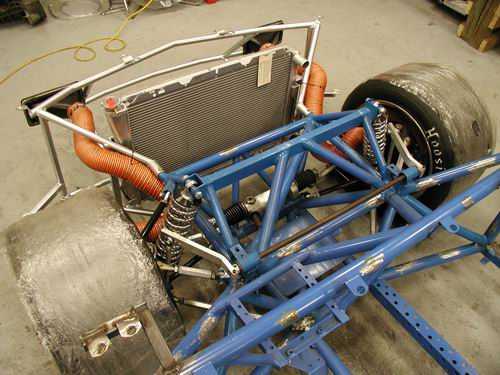

Next the oil and coolant was added to the system. This was done simultaneously. Mark and Dana added a mix of water, water wetter, and coolant to the radiator. Once it was full, they moved to the back of the car to the surge tank fill tube. Interestingly enough, as completely different as this car is from the stock Fiero, the coolant system is basically the same. There are two fill points and the motor must be running to top it off correctly. While Mark was working on filling the surge tank, Dana and I were filling the oil. We started by adding 10 quarts to the oil reserve tank. With a dry sump system it is necessary to prime the system while filling. Dana poured oil into the tank while I was under the car with a drill spinning the dry sump motor. The final count, 15 quarts. She was thirsty. Last but not least, the fuel. As I have mentioned before, this 645hp beast drinks normal 93 octane pump gas. Wow. It sure seems like a lot of horses for 93 octane.

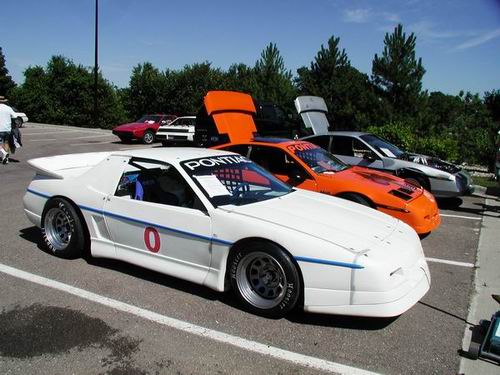

oh yeah.. here ya go!
LOOKS BEAUTIFUL!! Can i ride in your car? You should take it to the run-offs at mid-ohio, it would be right at home i have a feeling!

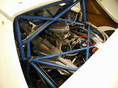

Thou speakest too soon... (or without using the search feature at least) https://www.fiero.nl/forum/Forum1/HTML/024333-2.html
The engine has many impressive specifications that I'll share. The parts list reads like a Winston Cup car; 412 ci, Callies crank, JE pistons, Comp cam, and prototype Pontiac 867 heads. That's right, I said prototype.
Again, there has been another original part put into the car. Best of all, now I can say that the car is "powered by Pontiac"! As it turns out, the heads he sold me with the motor were heads that he received from Pontiac Motorsports (John Callies) in 1984ish to use as development for Winston Cup racing. This set of heads lays claim to the following firsts; the first "hot burn" chamber, the first 60/40 heads, and the first high intake.
Other helpers around his shop couldn't believe that he was selling these heads. Paul said "well, it's my personal engine, and they come with the motor." Don't worry, I'll take good care of them Paul.

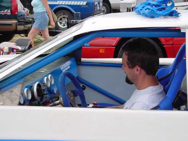

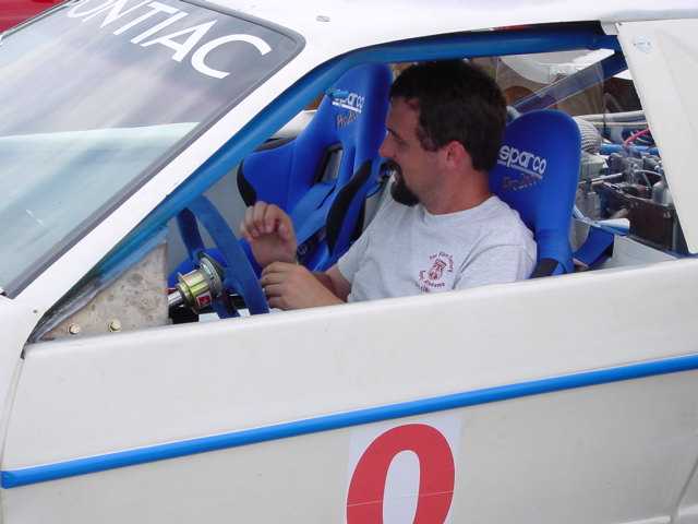

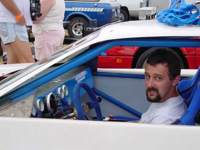

Naw, it sucked. Here's a sequence of pictures - you tell me if I had fun.
Receiving orders from Paul:
Ignition!
High on the fumes of race fuel! Yeah!!
That's when Paul said "Stab it again!", so I did!

And that's how I felt when it was all over:
Thanks again Paul! It was a pleasure to finally meet you, and an honor to get that close to your car! Next time we meet up, I'll toss the keys to the pro street to you so you can take her for a spin.

I got the seats from ....... (hold on, looking for the receipt)....
Seats are from: OG Racing (703 257-0009) www.ogracing.com
Steering wheel is from: The same place
I had to look in my receipts. I cant tell you how many, but at least 200. The seats and seats and steering wheel would take some modification to fit in a stock Fiero. You would need to be best off to buy one of their front/back tracks. Also, notice the high sides. These are true racing seats. (read that as you need to set in them from the top and (foomp) squish your way in. Great for comfort and lateral G-force. Downright impossible for dayly use. I also got the harnesses from the same store.
Hope that helps,

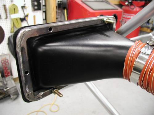

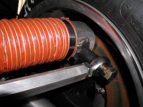

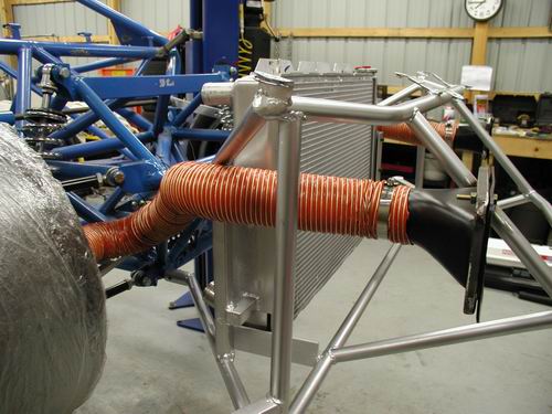

Can I see how youre are ducting the front brakes? I am having some clearance issues with mine.
85 GT 4 speed 2.8L auto X'er
[This message has been edited by red85gt (edited 08-30-2003).]
R Runner
Posts: 3703
From: Scottsville, KY
Total ratings: 98
Report this Post08-30-2003 09:20 AM Click Here to See the Profile for R RunnerSend a Private Message to R RunnerDirect Link to This Post
Sure thing...
Not the same as stock, but you get the idea. As for the outlet location, I could have done better. I found out later (after copying the IMSA prototype) that I should have blocked off the opening around the center of the hub and focused the air that direction instead of at the surface of the rotor. In my case the rotors are vaned and therefore draw air from the center near the hub. With my current setup, I am only cooling one side. Naturally it is better to cool both. Another project I plan on getting to this winter.
Paul
