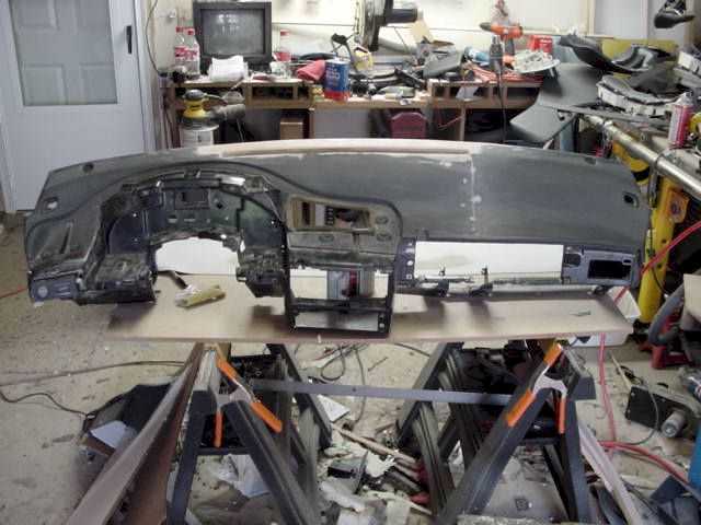

Initial pics are here. I can shoot some of the completed project if there's interest, but I don't want to hijack this thread. It involved cutting two dashes in half and sectioning them back together, then recovering with vinyl from Mr. Mikes. Also needed to make custom door panels to clear the dash corners.
09:21 AM
Songman Member
Posts: 12496 From: Nashville, TN Registered: Aug 2000
Gary,
I'd love to see the finished product. Your initial pictures don't show how you integrated the console or your door panels.
Roy

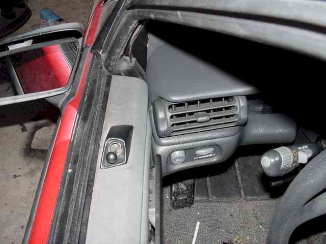

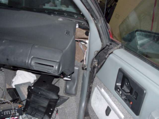

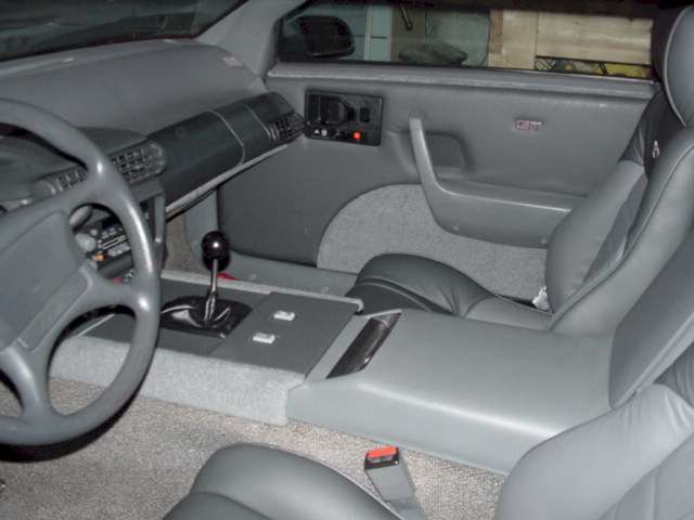

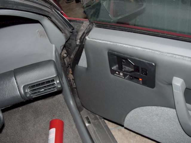

OK, you asked for it. Dialup users can go get a snack, it's gonna be a while. Here's what I ended up with by aligning the dash with the steering column and the center console
Door won't close
Other side:
Big trouble!
So, we do this:
(don't mind the mess)
Final fit driver's side:
Passenger side:
Bonus!
This also shows the shifter console I built to tie the dash to the Fiero center console.
The whole package:
Many thanks to Mr. Mikes
The entire steering column is from the Grand Am. Everything is complete and working, including headlight switch, high beams and cruise control on the left stalk, intermittant wipers on the right. None of it was compatible with the Fiero wiring, but it all was wired to spare Fiero pigtails, so I can go back to stock if desired.
I'd say I put at least 100 hours into it, much of that in the electrical changes. If anybody wants more details, ask away.

DAMN, that looks pretty darn good! So you extended the Dash from the passenger side with a strip of the spare dash? Also did you try to use the GA's Door Panel? Cause I took a look at the 99's Door panel and I see where your problem was and I'd like to find a way to use the 99 Door panels with the Dash. Gary, you wouldn't mind helping me out if I have any questions would you?

Ask any questions you like. It's better if you email, I'm in the middle of moving and I don't get on the forum very much these days.
I had the GA door panels. With the map pockets on the bottom, they stuck way to far into the car. They hit the seats and blocked the parking brake handle. Take a look down along the side of the seat thru the window with the door closed. There's about an inch clearance, and the Fiero door panels are just about flat. Also, the door handles were in completely the wrong location.
To extend the dash, I found a area where the contour didn't change much over a 4" length. I cut the main dash in the middle of the glovebox hole, and cut the second dash 4" to the left of the same line. Using a similarly contoured plastic strip from the scraps, I epoxied the two pieces together. There is a piece of 1/4" plywood all along the windshield edge for reinforcement.
I also forgot to mention that the curvature of the GA windshield is radically different from the Fiero. I had to trim almost 4" off the front edge of the dash, where it meets the glass. This was also necessary because the top of the cluster would have hit the steering wheel otherwise. In the construction picture, you can see the new defroster vent I had to cut.
