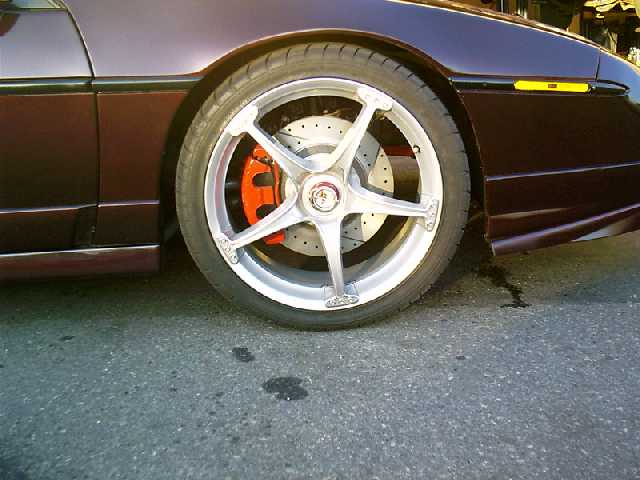

Just wanted to share my latest mod. Although the 88 brakes are far superior to the pre-88 Fieros, I wanted to upgrade my brakes and was inspired by West Coast Fiero’s 88 brake upgrade kit. http://www.westcoastfiero.com/Brakes/Brakes.html The beauty of this swap is that you are only swapping to a bigger diameter rotor. The 88 Fiero caliper is retained which means you are also retaining the emergency brake. The Fiero disc brake pad is the correct size for the C4 Corvette rotor. The 88 Fiero rotor is a 10 ½” diameter but the Corvette rotor is a 12” WCF could not supply the rotor I wanted so I decided to make the kit myself. Most brake upgrade kits run $1000 to $2000 so the WCF kit is a bargain at $595 for all four wheels. Too bad it only works on 88 Fieros.
At the Fieros at Carlisle show, I found out that Rockcrawl had already done the swap by himself also. Thanks to Rockcrawl and Akursked I was able to figure out what I needed to do. Rockcrawl has a great web page about his brake swap here. http://www.fieroaddiction.com/brakes.html While talking to Rockcrawl he assured me the brake swap has impressive results. AkursedX also had a good thread about his experience of installing the WCF kit. https://www.fiero.nl/forum/Forum1/HTML/030023.html
I wanted some rotors that would really catch your eye as well as superior to a solid rotor. I found some sweet drilled, slotted, silver plated, directional Corvette rotors from Parts Authority. They are out of Rockville Centre, NY and their phone number is 516-678-3900. They cost $75 each but shipping was $60 total for the four being $360

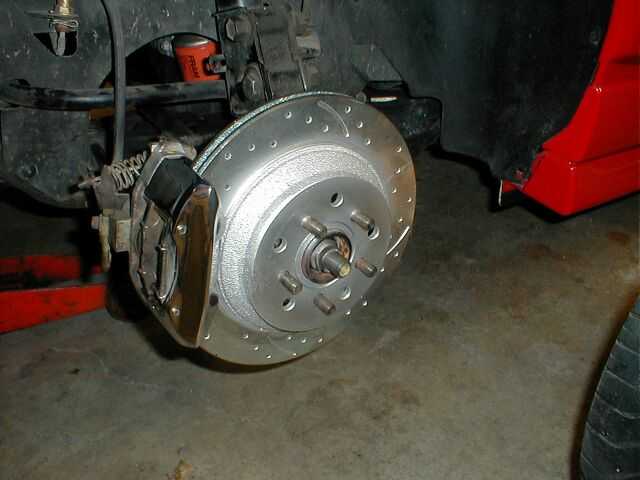

Here is one side by side with a stock Fiero rotor.
I sent the rotors out to a local machine shop to redrill the rotors from a 4 ½ bolt pattern to a 4 ¼ Fiero pattern. The machine shop also made the needed centering rings. The centering ring is tapered on the back which matches the taper on the Corvette rotor. The taper prevents it from falling out and the centering ring was also machined to have a friction fit through the center of the rotor. All that worked only cost $60 for the four rotors.

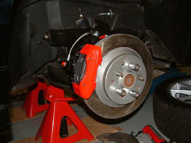

I spent a lot of time on the caliper adapters. I tried a few prototypes to see what needed to be done. Finally I decided the only precise way to do this was using computer aided drafting CAD. I teach AutoCAD at a high school so I felt this was the best way to design them. I spent a day taking measurements from rotors, spindles and calipers trying to decide the best layout. I then plagued myself by cutting some 3/8” steel attempting to make them. I stopped in to check on the rotors and asked if they could make the adapters and they said they easily could. I brought my CAD drawing to them. Wish I would of done that first. LOL They only charged me $30 for the brackets and were already to be put on since they tapped them for me as well. I picked up all my parts yesterday afternoon and was keeping my fingers crossed it would all fit.

This morning I took the car for a drive. Damn….. Holy Crap do they stop. I can see why WCF recommends putting more braking bias it to rear brakes. The brakes remind me of braking a motorcycle with only the front wheel. I need to break the rotors in quickly so I can drive it to the 20th Anniversary show.

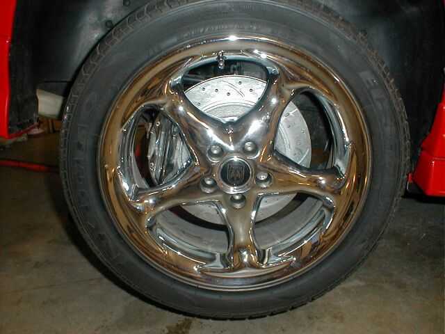

For those that might be wondering about the chrome caliper brakets let me explain them here as well. I felt that with the chrome wheels that the brackets should be chrome too. I found a company at the GM National show that could chrome my existing caliper brackets. They did a even better job on them then I hoped for. You have to see them in person to really appreciate them because pictures don't do them justice. Since my wheels have very soft curves I wanted the calipers to match. I asked them to soften all the curves. I also said it would be alright if they could get rid of the numbers on the ends. They completely removed the lettering on one end on the other the numbers were too deep so they just polished them. It is amazing how much work they did to soften the lines. There are no flat front faces any more. All four where perfectly matched too. Not cheap but I love them. I sent my calipers to the shop and was charged $55 each including the return shipping. The shop also moved my order up in priority to get them to me in time. The shop is C.A.R.S. of Pittsburgh, Inc. Chrome Shop at www.carsofpgh.com

Those look great Ski! I especially like the chromed Caliper bridges behind the wheels. With Akursed, and now you having luck with adapting the Corvette rotors onto the 88, I am even more tempted to give this a shot! Maybe that will be a good winter project.

I see that the inner hub will rest on what you had done @ the shop but I still question the lack of reinforcement within the yellow circles. At high speeds and braking the rotors see tremendous force. Hitting some bumps looks like it could crack or break. Killer mod- I just hope it doesnt become a 'killing' mod. Great Job Ski- OUT>

The redrilled holes appear close but they are only 1/8 inch closer than the original holes. There is a long taper where you drew the circles that starts there and ends on the front so it is not an edge. Besides the rotor is being compressed between the wheel and the wheel hub. When viewed from the front you can see there is plenty of material to hold the rotor safely.
