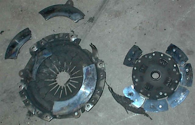

I had the same problem at the track after replacing with CF, after troubleshooting the fault was in the clutch line, from the master cylinder to the slave cylinder. You push the pedal and the clutch is released, let off the pedal and the line had enough restriction not to allow the pressure plate engage quick enough, this didn't let the pressure plate do it's job.

Provided that you don't go overboard with horsepower the LUK brand of clutch sold by Northern Auto is excellent.
True, but if you do.....
this is likely to happen.
