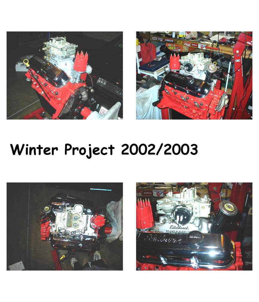

The "Old School" method of getting horsepower.

Hmm.. Pardon my ignorance but did that start out as a 2.8?? Or is it a camaro 3.4 block, etc? I don't know the difference, just some details are in order... hehe.

Hmmm two piece Edelbrock Torker intake with a 390 CFM Holly carb? Nice

204 cubic inches (3.4L)
Custom ground camshaft
9:1 compression
Edelbrock Torker II intake
Holley 390cfm 4-bbl carb
Ported heads
Comp Cams 1.52 rockers
Comp Cams heavy duty pushrods
Comp Cams Springs
Re-curved distributor
Double roller timing chain
Intake and heads port matched
ARP head studs
Estimated output:
215-220 horsepower
225-230 torque
Estimated completion date:
April 2003
(Still need to Assemble the rest of the engine, re-build the trans, re-work the cooling system, and re-work the engine compartment.)

Nice...i just go my edelbrock valve covers 2 days ago. You using the cork gaskets? That be awsome if they had a tunnel ram style intakewith dual quads..mmmm id convert from fuel injection to that in a heart beat

Hey Orief, That looks cool. I was surprised by the HP numbers. I am totally ignorant on Chevy V8s so excuse that but I am comparing it to the 3800 V6 Supercharged which gets 240 HP bone stock. Is your estimate rear wheel power? Is that why there is such a low expectation? Thanks

Hey Orief, That looks cool. I was surprised by the HP numbers... low expectation?
Thats a 3.4 dood
GTFiero1
Posts: 6508
From: Camden County NJ
Total ratings: 109
Report this Post10-26-2002 08:31 PM Click Here to See the Profile for GTFiero1Send a Private Message to GTFiero1Direct Link to This Post
whats this beauty doing on page 2?
yes Ski, thats a 3.4 , note the 3 exhaust ports on each side and short length

I have never seen a carbed 3.4. Looks AWESOME

Turbo would be a no, Would require a custom manifold, But Fageol makes a supercharger that would bolt right on. Just don't have funds now and would require me to re-do the decklid, so maybe later. NOS would be very easy to do.
My only problem now is it has been postponed a few weeks due to recent surgery.

hey orief, what gaskets you using for the valve covers?
[This message has been edited by GTFiero1 (edited 10-27-2002).]
The stock gaskets for a 3.4L firebird engine.
You can also use the stock gaskets for ANY 2.8L except the Fiero. (Blazer, Jimmy, S-10/S-15, Citation, Firebird, Camaro, etc)
If you buy the upper gasket set for the 2.8L you will get a set, the Fiero valve cover gaskets only come seperately. I also have an extra set.
