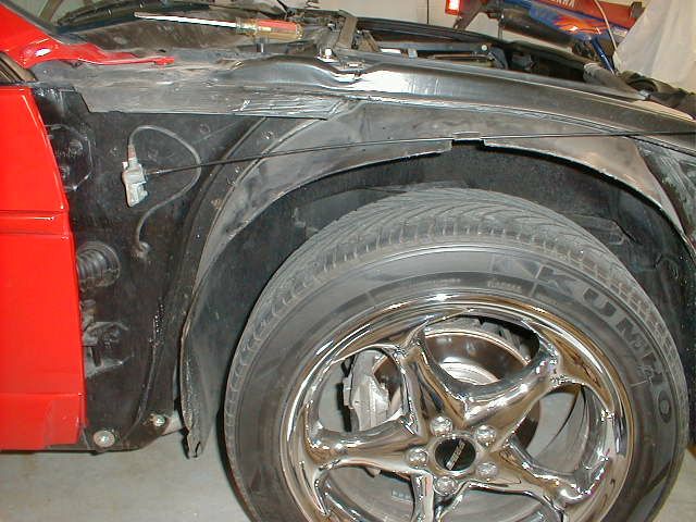

Well I have removed my antenna too. I used the stock antenna mounted below the plastic fender. To be sure the steel sub frame does not block the signal coming from the other side I mounted a second stock antenna below the drivers side fender. The two antennas were then connected with a Y connector before going into the radio. This actually gives a stronger signal than to original antenna.

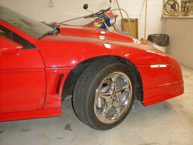

Just want to tell you that is one sweet car always did admire it I was finishing up some body work but that antenna was the pits ang glad to know at least we now have a salution to that problem,are those side scoop a kit?.

Thanks on the compliment. The front fender vents were adapted from an early Trans Am vent.

Thanks, The only additional thing you will need is a 2 inch piece of angle iron or aluminum. I used aluminum so it would not rust. The angle material is 3/4 x 3/4. Mount the antenna to the angle iron and them mount the angle iron to the body. I used the fender skirt to hold the other end of the antenna so it does not bang around. You can see that in the pic.
I thought I might drill a hole in the front frame rail, stick in a zip-tie peg, and use a zip-tie to secure the top of the antenna. Either that or drill a couple of small holes in the fender well and wrap the zips through them.
what kind of "Y" adapter did you use? Can you pick one up at Radio Shack or did you customize something?

Skitime,
Very, very Nice, solution. Your 5 spoke wheels are also very nice. If you don't mind sharing, who makes em and are they 16"s or 17"s. Are they chromed or polished aluminum?
The lip I use to hold the antenna is very secure and keeps the antenna as far away from the steel frame as possible. The Y adapter was something I found laying around. Here are two sites that sell them. http://www.wholesaleaudio.com/metra%20antenna%20adpters.html www.installer.com/antenna Believe it or not Radio Shack has dropped nearly all supplies for car stereos.
BTW The antenna works quite well with just one antenna. You may elect to not do the dual antennas after trying it. TooManyFieros bet me that the horizontal antenna would not work as well as the vertical antenna. We tuned my car to a station that was barely coming in. We then went to our other Fiero that had the same radio in it and a normal vertical antenna and attempted to tune in the same radio station. We could not get that station at all in the car with the vertical antenna. I won the bet and can't repeat what he then said. lol

Don't mind at all. They are Chrome 17x7 Prime wheels, Model 705
