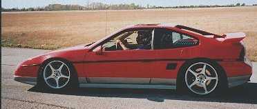

Report this Post10-30-2001 06:45 PM Click Here to See the Profile for Slammed FieroSend a Private Message to Slammed FieroDirect Link to This Post
Did someone say lowered?
My car doesn't bouce down the road. I have lots of friends who cut their springs and have all sorts of problems.
My car doesn't bounce , but rides like a covered wagon
if the pic doesn't show up...somethin is screwed
Jonathan McCreery
86 GT 4spd
Koni's , Coilovers, Big Bars , 17" Trmotorsports Typhoons , 11.25" vented discs, Wilwood 4 Piston Calipers , Pirelli P Zero's, Short Shift, No cat , Cold air induction , Geni Stainless tips, White face gauges , Momo shift , momo pedals, Big Bore TB, 70Hp Shot of NOS Autocrossed , Tracked , Dragged? (soon) abused.
[This message has been edited by Slammed Fiero (edited 10-30-2001).]

so it seems there is some controversy once again in the cut versus lowering springs debate. From what I can tell, there isnt much hurt in cutting a coil, as long as I dont go overboard. I was thinking 1.5 to 2 inches max. any more opinions of cut springs?

Report this Post10-30-2001 07:39 PM Click Here to See the Profile for grinthockClick Here to visit grinthock's HomePageSend a Private Message to grinthockDirect Link to This Post
Originally posted by Slammed Fiero:
Hmmm... Somethings wrong with that.....
Nah I will keep my mouth shut.

Report this Post10-31-2001 12:37 AM Click Here to See the Profile for Slammed FieroSend a Private Message to Slammed FieroDirect Link to This Post
Yeah ..somethin is wrong. If you look at 9 out of 10 of the pics I have ever posted the car is HIGHER. This was taken at an autocross. The coilovers were dropped as low as they would go and the car was trailered to the event.
(my first event with coilovers upfront)
The other pics I have posted of the car it sat .75" higher than it does there. 99% of the time I have the car riding at about 3/4 of it's full drop potential. Espically when I went to Banditbalz's wedding and drove the car 5 hours to my girlfriends house north of Barrie
Another 4hrs To georges Wedding , Back To carries house , back home.. So a total around 20 hrs in the car in a weekend. As it sits there the one time I tried to drive it in kingston that low I ripped the sway bar busings right off the cradle at 7-11 driving over the tank caps. I have also smashed 2 sets of fog lights and have to spend about 1 hour every 1000kms tightening up things becaus the car is so stiff and suseptible to bumps.
I don't even run it that low at shannonville for fear of hitting the apron the wrong way. That autocross was held at CFB mountianview. All concrete airstrip..no bumps.
Being low is cool , but you have to have some height for street use. There is another head on sht of my car at full drop somewhere on the net. Taken in my driveway from the left side.
Pretty easy to lower the car with coilovers. The inner fender liner of my car had to be modded upfront to get it to sit that low.
So thats whats wrong with the pic.
