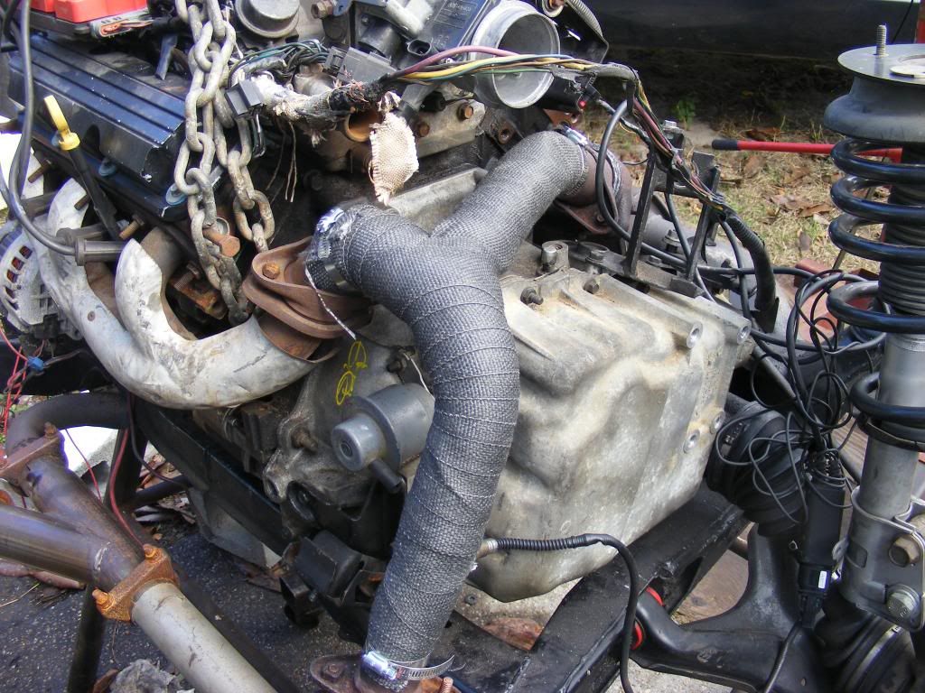

Have not fired it up yet but it was not that hard to do.
Cross over was not bad to make but the header was a little harder. I purchased the ZZP flang and my binds from Summit.
My weldings not the best but it will have to do for now.

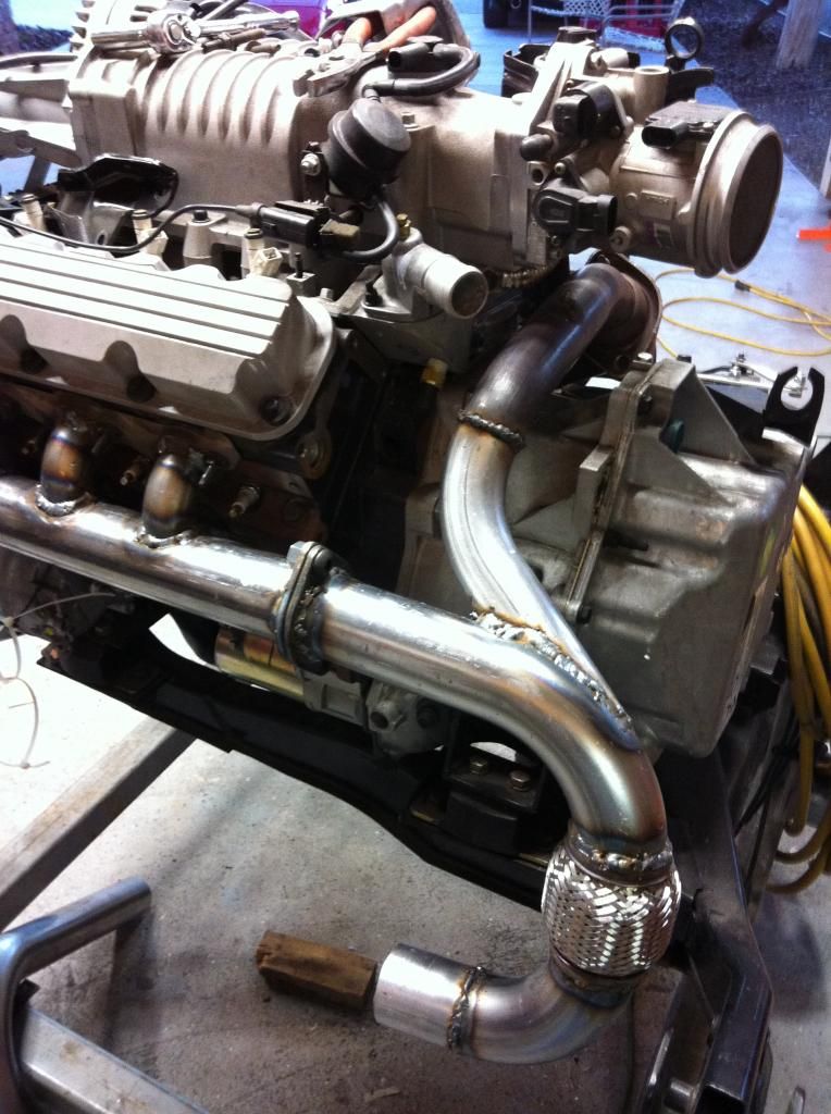

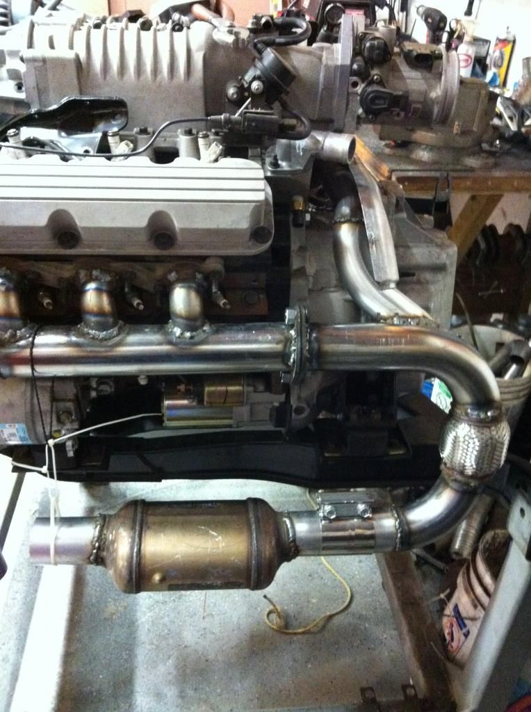

This is what we made for adams fiero. We both use the stock muffler (GT) His car is so quite that at the drag strip I guy asked us if it was a "electric car". It is not THAT quite, but it very quite in the car driving around. BUT it needs the exhaust dump to really flow.
I just got done doing the same thing for my SBC/headers set up. The little I have got to run it ( with the rod knock) , with the new pipes/cross over, it will be fine inside the car.
On my car the key is the electric exhaust dump.

Nice plumbing job . How is the clearance to the water outlet hose? That's what I had in mind. I guess that I will need to order some mandrel bends and start piecing one together. Hoping to use a premade Y. I realize that a quiet setup can be had by cutting the trunk and using a 27" L Magnaflow muffler but I am one of those owners who want to retain what little trunk is available. If I make it to the 30th, I've got to take a small piece of luggage and a cooler with me. I am a diehard fan of the spacious Fiero trunk!!

On the one we did for adams car we used the stock 3800 fwd manifolds. the rear one we cut off the stock out let, welded a plate over it. Than we got 2 stock 3800 cross over pipes. For the front side we took just enough of it so that with it turned about 90 degrees to points right at the stock 2.8 cross over pipe. With a nother 90 bend it turns down to the part of the fiero cross over pipe that has the O2 bung in it. Than we used the other 3800 cross over pipe with the front end cut off. This was turned so that it pointed at the top of the bend of the front pipe. We had a piece of pipe that went over the 2nd cross over pipe. We slid it over the rear cross over pipe, slid it out untill it was lined up with the bend. We ground and cut untill it was a good fit to the front pipe. Than we marked the bend, cut a hole, welded it up. Looks a lot better wrapped. We had to run the water pipe out, over it, than down. Adam used a piece of the SS water return pipes from a junk fiero to connect it. In 4th gear, with the windows up of down just cruzing, you can't hear the engine. It is that good. But we are fooled into thinking this is a good flowing, hipo exhaust. Thats what the dump is for.
