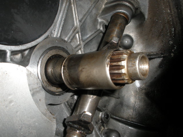

This can't be good.
Is the input bearing assembly still available? How is it put in? Does the transmission need to be disassembled to press the bearing out? Or can it be extracted and replace without disassembling the transmission?

you are screwed bro, I hate to be the bearer of bad news. That part is impossible to get ahold of. I have a leaky input shaft seal, all part of that component. basically SOL. Good luck, maybe find one used or there may be a few running around, if you find a supplier be sure to send me the info so I can order one.

The input shaft bearing/seal unit needs to be pressed out, and the new one pressed in. It requires having the transmission casing split apart.
And to add insult to injury, that particular part is pretty hard to come by. You could try contacting ManTrans... maybe you'll get lucky and they'll have one in stock.

I just went through this about three months ago on a customer's car. You do need to split the case, but luckily for you there is at least one great thread on how to do this. Use the search function and type in "Splitting Case". It's really not that daunting a task to do. As for finding the bearing by itself, that will be the hardest part, although the bearing is still available in the rebuild kit which includes all new seals, and several bearings. The kit part number is BK234 but unfortunately I don't know who the manufacturer is. Any transmission shop will be able to look it up for you though. Here in Canada the kit cost $225. Not cheap but there aren't too many alternatives. BTW you definitely want the shop to press in the new input shaft bearing once you've got the case half in your hands, as mine went in tight. There's a lot of potential to ruin it so leave that liability with the shop!
Edit: Here's the thread by Blacktree... excellent write up with photos. www.fiero.nl/forum/Forum2/HTML/109502.html

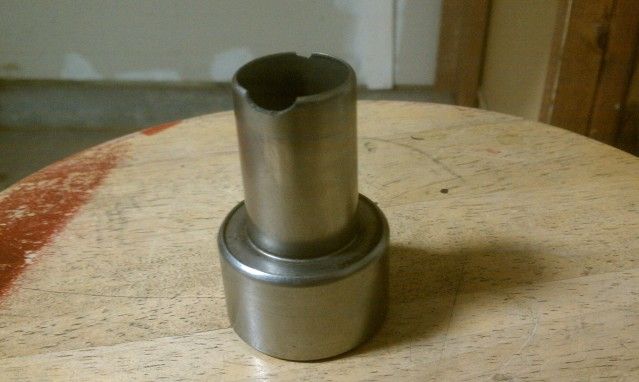

Going through same issue, I just had mine welded this morning, since part in no longer available. I figured could not ruin it any more, if this does not work going to have to replace tranny. Good luck and if you do find one by itself or in a kit hit me up need one bad!!!!

Keep an eye on ebay for rebuild kits. You may be able to find one with the throwout bearing guide sleeve. I did find one a few years back. Many will be for the later transmissions with hydraulic throwout bearings; they have the same input shaft bearing except it doesn't have the sleeve on it. I think I got my rebuild kit from High Gear. You could also try giving them a call.

While we all anxiously wait for Rodney's replacement unit, in despiration I bought the complete bearing kit last January to complete my getrag build-up. I actually bought the kit on ebay, but it is from DT Components. The part number is TRK-550 and their web page is dtcomponents.com. I paid about $300 for it on ebay, but I think it can be gotten cheaper from other sources. I hope this helps all of you who really need this part now.
Additional information: The number BK234 is also on the box label. I checked my favorites and http://www.manualtransmissionpart.com/BK234.html should take you to a distributer for the part. they are selling it their for $256.22.
This is probably a very limited availability item. One could ask how many they have but I would guess it is not that many.
