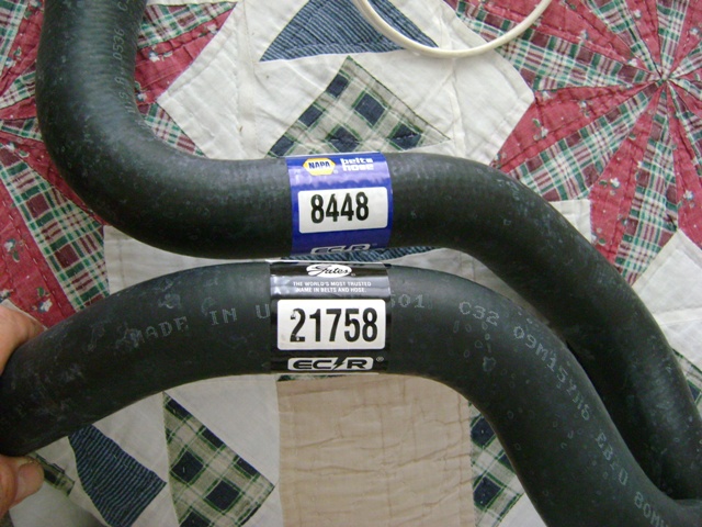

I now have two water pump to passenger side coolant pipe hoses, a NAPA 8448 hose and a Gates 21758 hose. Measuring them with a string they appear to be the same length. If you put them side by side one will be about 1.25" longer than the other one when sides are swapped over. I will put these both on the engine after I install the engine and cradle into the body. We will see if one fits better than the other.

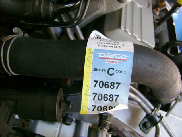

Thermostat to crossover pipe Dayco 70687:

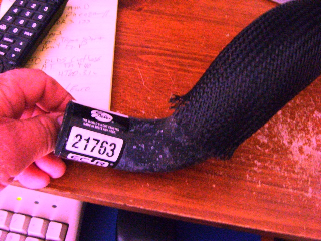

Crossover pipe to drivers side coolant pipe Gates 21763:
