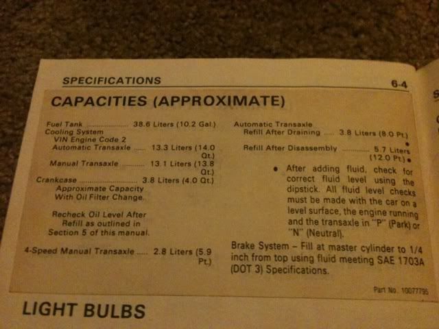

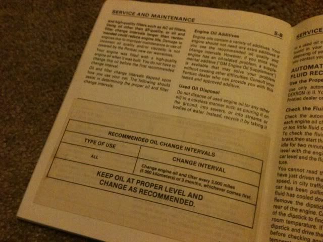

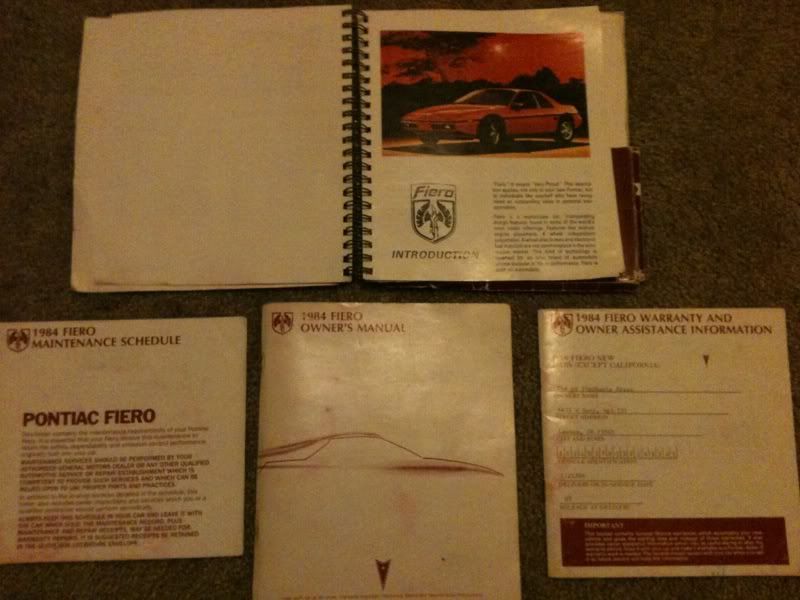

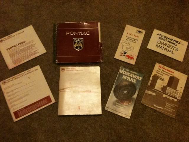

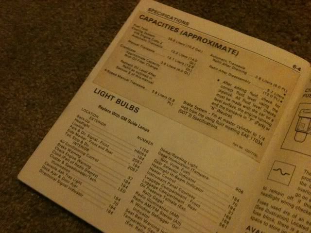

Report this Post12-27-2011 08:50 PM Click Here to See the Profile for Fiero84FreakSend a Private Message to Fiero84FreakDirect Link to This Post
Fiero84Freak
4787 posts
Member since Feb 2002
So here you go, for anyone that maybe has never seen this before.
This is how a typical 1984 owner's manual packet looks like. Yes, for '84 it was actually a spiral bound packet. Everything fits into that maroon Fiero logo booklet. The booklet itself has pages showing the unique features of Fieros. I believe the Pyramid deck manual and Firestone tire packet is not what originally came with these, but everything else did. And I'm sad to say the back portion of the spiral booklet has separated with the passage of time.
So here's the important thing in the middle - the '84 owner's manual.
Here's the first sign of recall you come to - Recall Part # 10077794. Basically, this doesn't really change anything that wasn't already stated on this section. I think the only thing it did was add "KEEP OIL AT PROPER LEVEL AND CHANGE AS RECOMMENDED" in very large and bold lettering, just to tell you something you probably should have already known. It also changes "Type of Use" to "ALL", and I think this was done because underneath the sticker is different recommended types of oil to be used in the crankcase.
And here's big daddy - the Capacities section. Recall Part # 10077795. This sticker corrected one VERY large error in the original manuals that stated that the full capacity of the crankcase was only 2.8 liters or 3.0 quarts - obviously well below what should be ran in the iron duke, and thus if you were burning oil, you were running REALLY below what you should have been running. Since this capacity is what was posted near everywhere, it was followed a lot by places that changed the car's oil and by Fiero owners themselves.
A closer look at the recall sticker. And it's a bit hard to see, but under "3.8 Liters (4.0 qts)", you can barely make out the old capacities below it. It's easy to see when held to a light, but it was hard for me to photograph.
So hopefully maybe someone can get some shots of some of the external items that were part of the recall, but this I've posted is what was done to the manual itself. Obviously there's issues as to why many of these manuals may not have survived. Many owners frequently discarded their owner's manuals by the time recalls were done. Additionally, since so many '84 cars have been lost and owners over time simply didn't bother with such trivial things it was kind of hard to know for sure if this was done.
The big reason why this package was instrumental in me immediately knowing that recall work had been done the instance I got the car is the Warranty information booklet and manuals has the VIN of the car typed onto them, linking them to the car.
