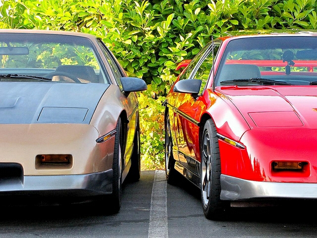

From an earlier thread...
Originally posted by Patrick:
I cut off two complete coils from both the front and back springs of my '84. The back was fine, but the front was definitely sitting on the bump stops. Made for a rough ride! I got some assistance from Fiero club friends of mine (with welding equipment) to cut and weld the metal cones. I had read that removing .75" was ideal, as removing more could possibly lead to the shocks bottoming out. Not a good thing!
Pictured below is a cone on my parts car to show how long it is before being shortened. The rubber bumper was removed prior to this picture, but on my '84 the rubber bumper was reinstalled after the cone had been welded back on. The metal cones are now 4.5" long.
That's my '84 on the left with 205/55R16 front tires, just to give somewhat of an idea of where/how it sits.

{EDIT TO ADD} thos are the stock 14" rims with 215/60r14s. i bought some 86GT 15" rims. there on the back for the time being until i redo the other rims.
See I want to just hackles 2 off so bad after seeing you guys'. My tires in front are 225/45/18.... a bit taller then I will run in the future. Makes me wonder if they will hit in turns. They were cheap takeoffs
[This message has been edited by redraif (edited 10-12-2011).]
