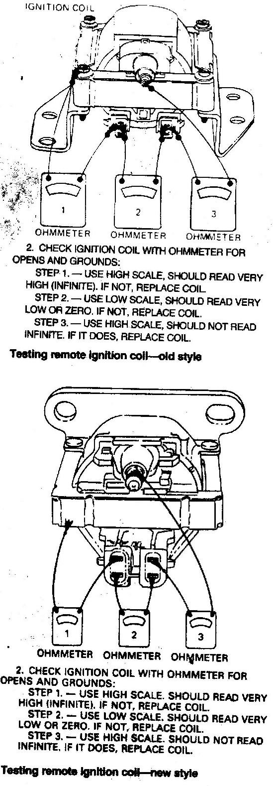

You can test your ignition coil with a multimeter.

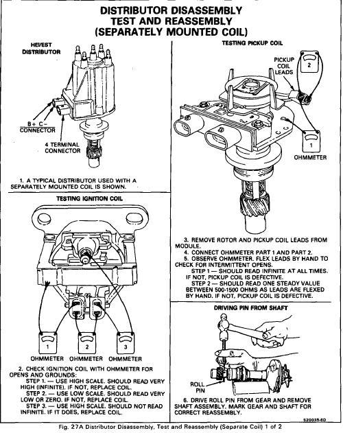

Sounds like the pickup coil.

So, does that make it the pickup coil? (again?) Heh.. if you remember, I replaced it last fall after much troubleshooting.

Did you do the resistance tests on the coil?

Ill go check the wires now.. the resistance tests were inconclusive on the 3 coil tests... dont know if I am doing it wrong..
And I dont think I am.. but the tester I have is a real pain in the butt since it "automatically" switches between high and low testing and there is no manual way to switch it between hi and lo, you have to rely on it to do it for you... anyhow, when I did do the test, I got no "hi" on the hi/infinite tests.. it just sits at 0000.00, so I am starting to believe its the coil. I do get "lo" on the 2nd test, though.

Ohm out the pick up coil. - You don't need to remove the distributor to test it with a meter. You do need to remove it to replace the coil if it tests bad however.

Report this Post08-12-2011 07:30 PM Click Here to See the Profile for phonedawgzClick Here to visit phonedawgz's HomePageSend a Private Message to phonedawgzDirect Link to This Post
Originally posted by tbone42:
What do you mean make a spark? Am I supposed to still have a plug in my distributor to coil wire while doing this?
Additionally, do you mean check voltage on the pink wire I just unplugged from the coil, or another wire (like the 4 prong that goes into the diz..)? A little confused.
With the two prong connector unplugged from the distributor. Yes the other end of the pink/white harness should be plugged into the coil, and the engine harness should be plugged on the coil, and the key should be on. And you should have a spark plug attached to the distributor end of the high voltage coil wire, and that plug should be laying on the engine.

Ok.. here's what i just did.
Tested for spark on coil to diz plug wire with a sparkplug in it. No spark on EITHER coil, and I am getting 12v DC at the pink and white harness wire going into the coil.
Tried it with different spark plugs, too, no spark. also checked the resistance of the short wire itself and got 4.5k steady.
Sooooo... with 12v going in, but no spark coming out, that HAS to be another bad ignition coil, right?
Going to do the pickup coil tests now, but if the above is happening, that is pre-pickup coil problem, yes?

tbone42
8489 posts
Member since Apr 2010
Just checked pickup coil.. its fine. I got no fluctuations while flexing, it held steady at 850, and infinite (I think.. meter said O.L) when grounded.
HOWEVER... just for giggles I pulled off the rotor. There was a melted spot by one of the pieces of metal, and a little piece of what looks like a small cylinder magnet BROKEN OFF rolling around in there. After further review (heh) it came off the bottom of the plug in the middle that the wire from the coil plugs into.
Looks like I know what I need to get next, cap and rotor.

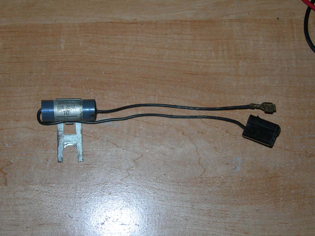

This thing under the dipstick. No continuity through the link. Sitting right on top the engine block, the heat probably killed it since it had no shielding around it at all.
Now the question is, where do I get another one ?

Just found this wiring diagram for my problem, figured I would post it here so someone else may get some use out of it.

That looks a whole lot like the tach filter. The tach filter prevents the tach from shorting out the ignition system. The test is to unplug it and see if the ignition system then works. Having it unplugged will disable the tach while it is unplugged.
Rodney Dickman sells replacement tach filters.
http://rodneydickman.com/ca...h=21&products_id=165

Oh no kidding! I guess it is! Looks a lot like a fusible link, too.. heh ... anyway, it has no continuity.
Glad I took a pic of it! Thanks!

It shouldn't have continuity when tested with a meter. It has a capacitor in it to block DC voltage. it however is designed to pass AC voltage. The tach signal from the ignition to the tach is an AC voltage.
So the idea of the tach filter is to prevent the tach from killing the ignition (block DC) while allowing the tach signal (AC) to pass through to the dash.

Ok, I made a 5 question post to keep it easy for you to answer, P.
1) So how do you test tach filter to see if it still works ? I did an ohms test on the tach filter, and it was 15.65k. My tach was not moving while trying to start it, so it still could be bad. Will having a bad tach filter keep me from getting spark?
2) I am getting a spark when I do the "key on" paperclip test, but ONLY a spark at the paper clip where I ground it.... not at the sparkplug end.
3) To do the resistance test on coil, does the ignition coil have to be mounted to the frame? It would be nice to test the new one BEFORE I install it.
4) Will not having a working tach filter prevent spark? (Since the white wire does go into the coil...)
and
5) (Its a longshot, but...) I just installed a new stainless dashkit right before this happened. Removed the old bezels, so its just metal around my dash instrument gauges overtop the clear plastic. Could this in any way be shorting me out/preventing spark or kill the tach filter? I know this sounds dumb, but I am at a loss for reasons why I still cant get spark and I am trying to brainstorm any reason why this happened so suddenly.

1 - There are two ways the tach filter could be bad - It could kill the ignition - It could be bad in a way such that it doesn't pass the tach signal. To test for the first, unplug the tach filter and see if the ignition comes back. To test for the second, replace the filter and see if the tach works. Since you have done the first and that doesn't bring the ignition back, it can't be bad in the first way. I would wait till the ignition is working to worry if the second is potentially the problem.
2 - You should get a spark at the spark plug end. Grounding the white wire is what the ICM does to generate the spark. If you aren't getting a spark then, you trouble has to be ignition coil, the small white/pink cable, or no power to the coil. This test needs to be done with a spark plug in the distributor side of the high voltage wire, and that spark plug laying against the engine. Because the rotor may be pointing towards any spark plug wire, or may be inbetween plugs, you want to do this test with the spark plug attached directly to the coil. It is possible for the coil to pass the resistance tests but still fail this test.
You can eliminate the short white/pink wire as a potential source of the trouble since you are actually getting a spark at the paperclip. That means the white wire must be a solid wire, and it means you have at least some voltage going to the coil. So it sure looks like your coil is bad.
3 - Yes you can test the new coil's resistance with the coil non-mounted.
4 - Having the tach filter unplugged eliminates any possibility of the tach filter or tach killing your spark. The tach & tach filter 'moniter' the ignition signal but are not needed at all to generate it.
5 - If your tach filter is working correctly, anything you do past the filter should not affect the ignition. So no, if it is working you can't kill the spark by shorting the signal at the dash. That is why GM put a tach filter on the engine.
