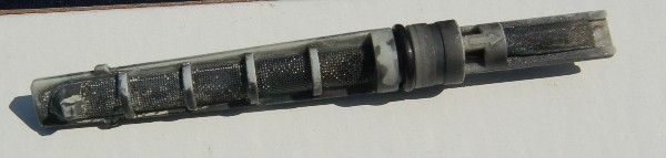

I would seriously recommend NOT using any of the A/C stop leak products.
Here is a photo of an orifice tube removed from a 87' Fiero GT A/C system that had stop leak added to it:
(Yes it was out of my car and NO I wasn't the one that put the stop leak in )
Note that the majority of the orifice tube screen material is now blocked by stop leak goop.
The photo was taken *after* the part had been rinsed in solvent. Prior to that you couldn't even see the screen material through the goo built up on the end.
This is *not* the "black death" caused by a seized or failed compressor, it's simply an mess of "stop leak" that effectively shut off the filter screen on the orifice tube.
Choking off the filter screen resulted in the A/C system going from "just leaking a little somewhere" to being completely inoperative.
The short story is, If you have leak, find it and FIX IT properly.
The stop leak products are very likely to cause you more problems judging from what I have seen.

Great list Randye, I used it myself and everything works great THANK YOU!!!
I really like the variable orfice as it smooths out the cool output trhough the vents when at idle.
Thanks Again
Thanks Again
Kevin
I'm glad it all worked for you Kevin. Thanks for the compliment.
When I started tinkering with my A/C system I didn't have a clue what I was doing really but I was sure I could learn.
Having every commercial shop give you ungodly estimates all the way up to $2000 was all the motivation required.
I found that none of the A/C work was difficult, just tedious in some places, and the satisfaction of feeling that COLD air coming out of the vents and knowing you did it yourself is...well.....COOL
