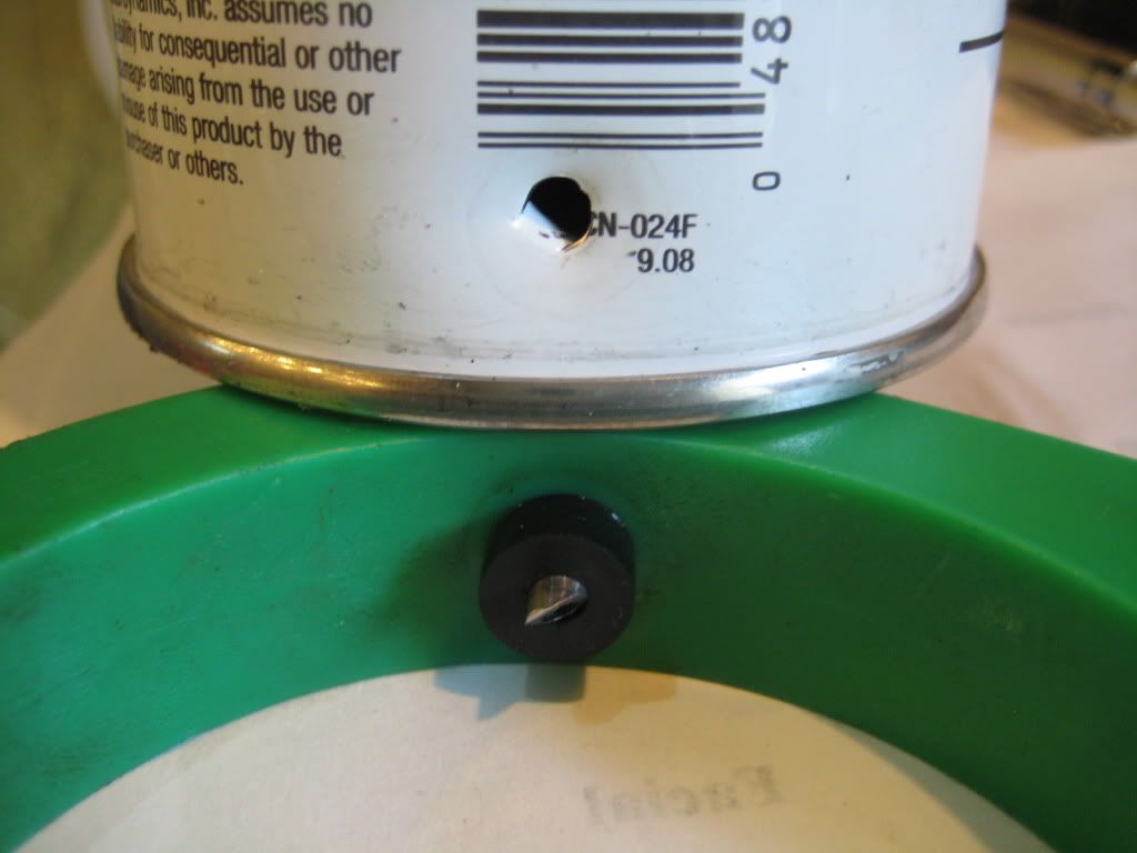

I just decided to share this knowledge with you.
What you already know.
When switching to R134a it's best if you flush the system. Don't Flush the Compressor, just drain it's oil.
Switch all O-rings to 134a Compatible rings.
Replace Orifice tube
Replace Accumulator can
Lower turn off pressure on Low cutoff switch on Accumulator. (Small screw between the terminals back it out almost a full turn... I think)
Refill with 134a compatible Refrigerant oil that your COMPRESSOR IS DESIGNED FOR! Use the proper amount!
Now somethings you may not know. Each can of 134a is not 1lb... its 13 oz. And on top of that it's also got close to 2 oz. in oil... so that's 11oz in the can.
You do know that each can can be anywhere between $9-16 and that ain't cheap.
So you've been told to fill with the proper amount of oil yet each can you add will add 2 more oz. of oil.. Why did I say that?
Because of what you DON'T know R134a comes in a much cheaper supply and it's DRY.
Here's the MSDS of the off the shelf can of Johnsen's R134a cans.
http://www.johnsens.com/uploads/files/6312.pdf
this says it contains 1,1,1,2 TetraFluoroethane ... And yes that's what R134a is.
Now let's do some searching.
Goto wally world and read the can of computer duster spray. 1,1,1,2 TetraFluoroethane...... Hmmmm R134a!!! and it's cheaper....
Now how do you get it in the systerm... Easy. A CAN TAP! One that punctures the side of the can, just be sure to do it near an end so it's supported a little more.
