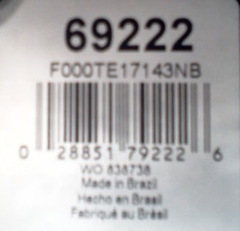

The fuel pump is in and I just got back from a test drive.
The pump is so quiet compared to the old one.
I was able to dial it down to 5.5 psi and its nice and steady there.
Here is the pump part number.
[I didn't know where it was made till it came in]
