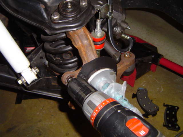

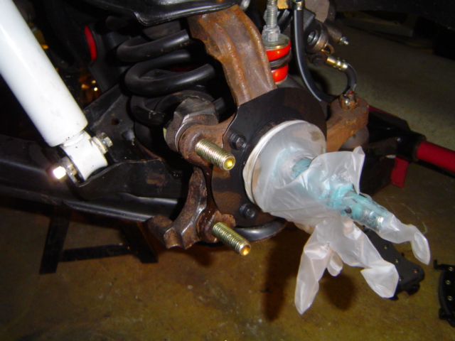

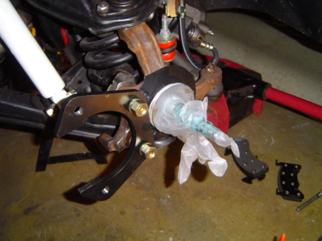

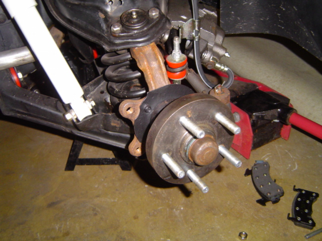

BrewCheese
Posts: 1809
From: NW Indiana
Report this Post04-19-2011 07:03 PM Click Here to See the Profile for BrewCheeseSend a Private Message to BrewCheeseDirect Link to This Post
I took my old caliper brackets and cut off the caliper mounting points. I also tried to find some long metric bolts and had no luck. To fix that problem I drilled out the threads on the spindles to the same size on the brackets and ran a standered grade 10 bolt through the 11.25 bracket, spindle, & old caliper bracket and put a lock washer and nut on the back side.
