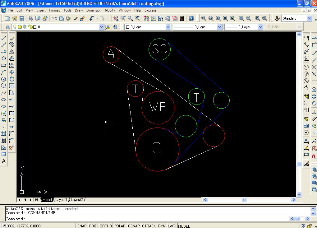

To tell you the truth Im not exactly sure, the motors not at my house. Here's a picture with the belts off if that can tell you anything or not.

Yup, you will need to change your tensioner pulley to a ribbed and route it like in the diagram I posted.

Thats a smooth one too, you need the same pulley in ribbed.

Base on the drawing the water pump also require a ribbed pulley? Is there a part number for that?
Watter pump rides the back of the belt and keeps the stock pulley.
