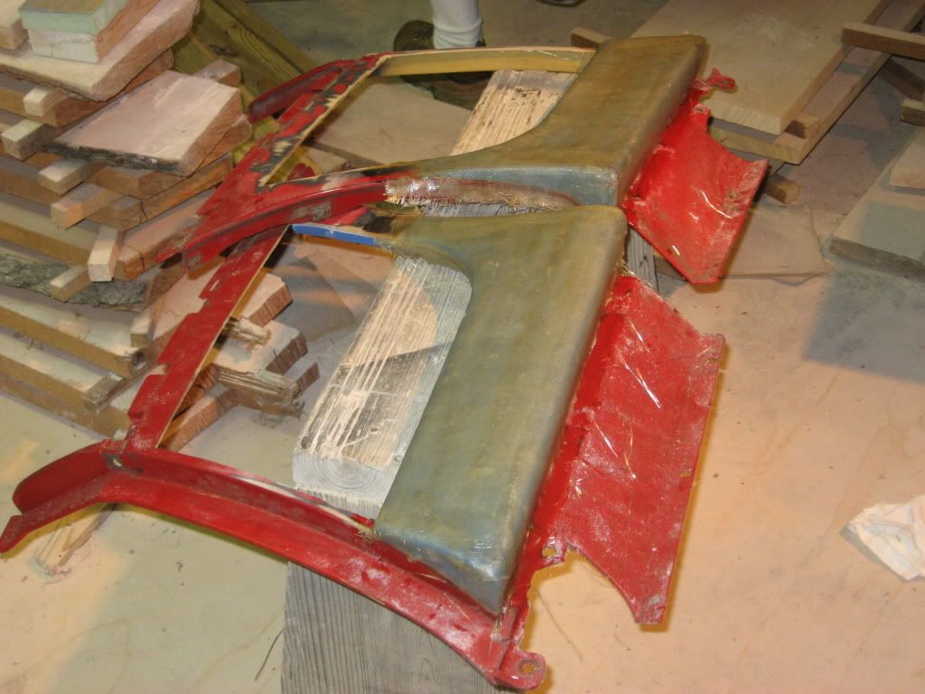

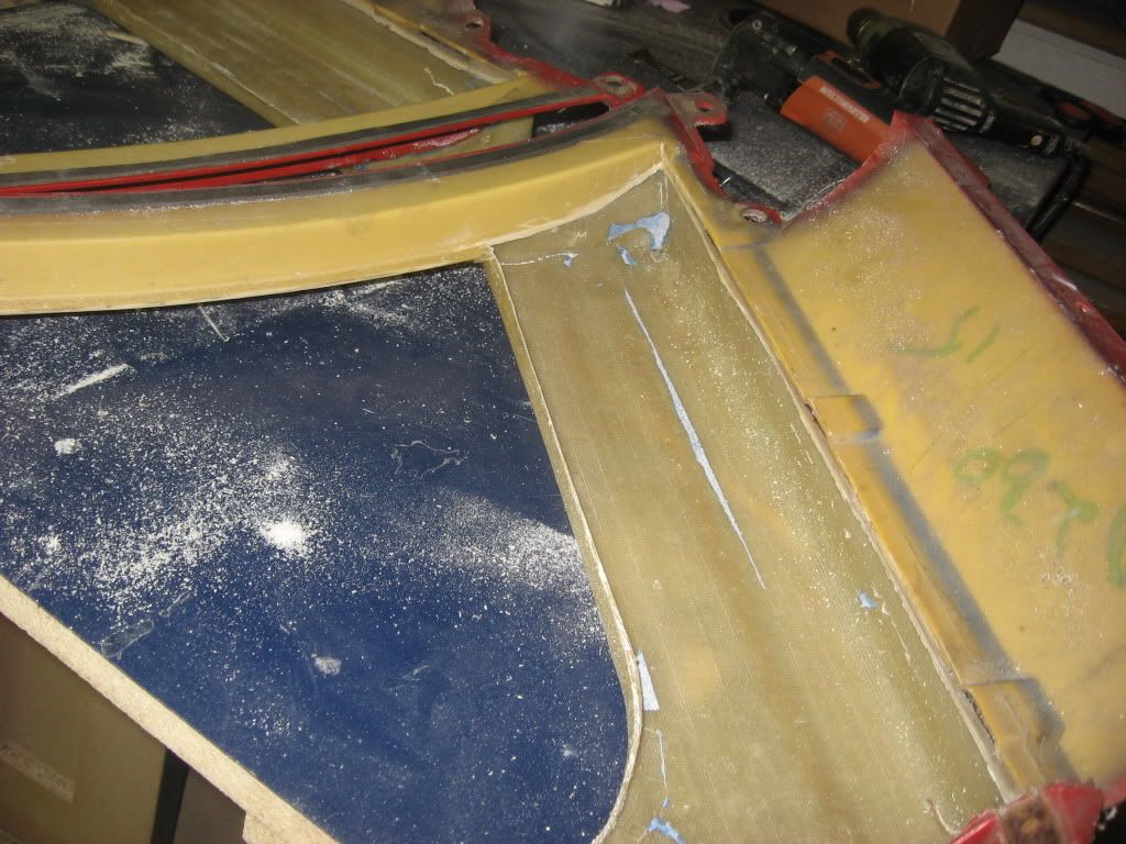

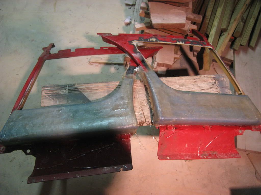

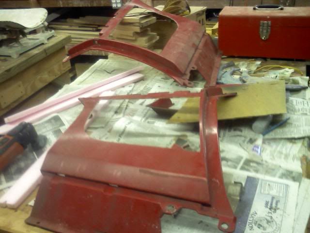

the donor. took them off the parts car. they're cracked so had to patch them up first

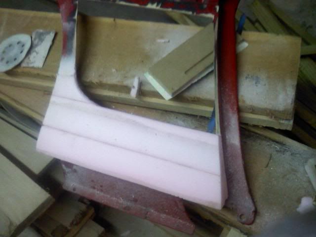

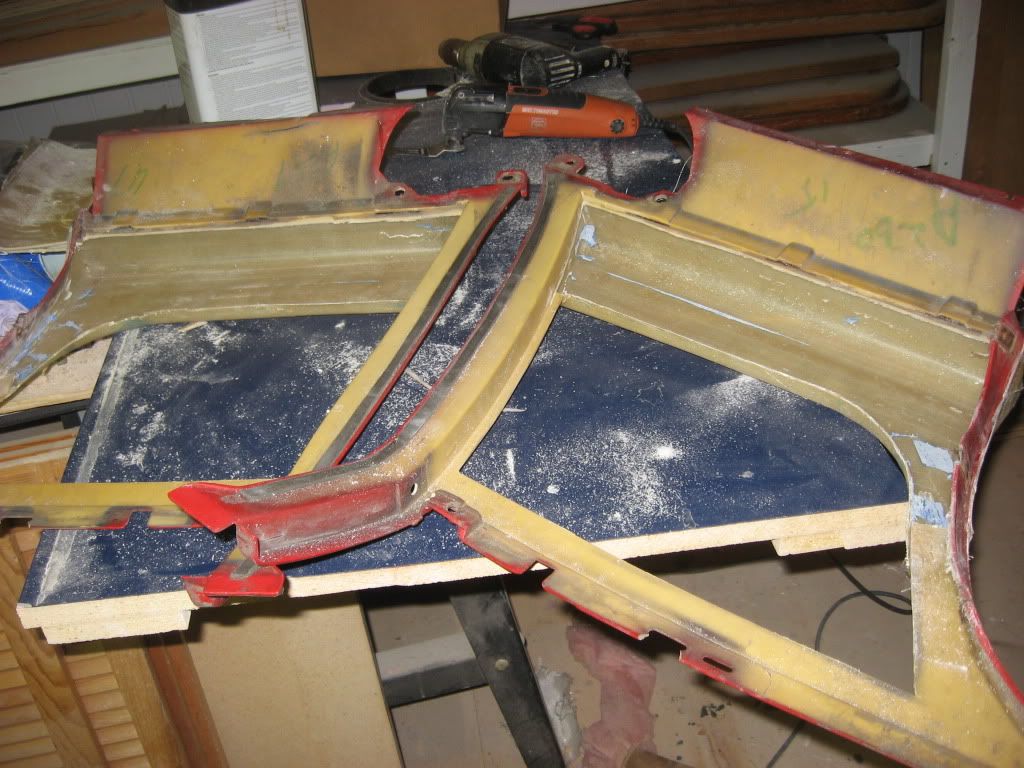

cut out the center to the shape i wanted.

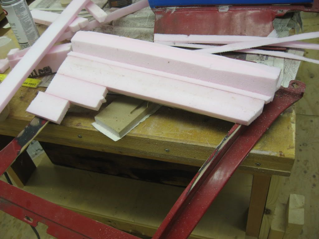

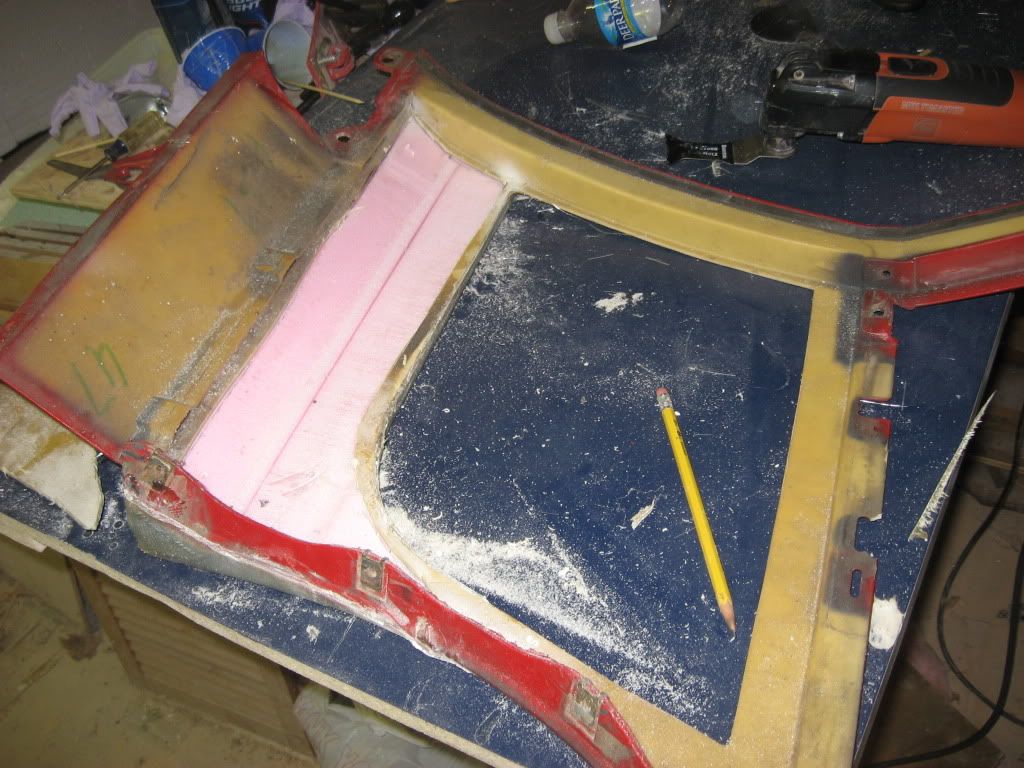

foam board and some spray glue
sanded them to the shape i wanted. i have a GT with the side skirt pannel thing so this way its goign to blend in with them

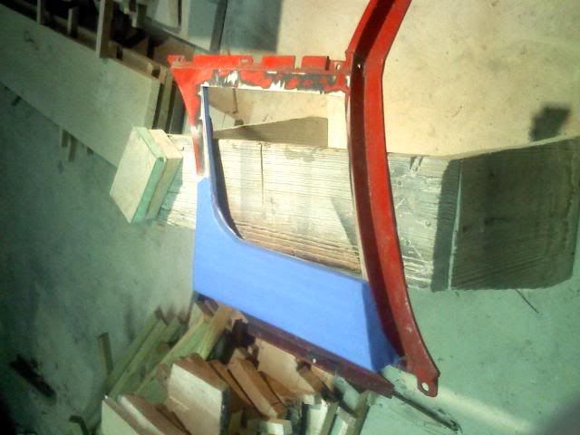

covered them with tape and got a couple layers of fiberglass on them today.
tommorrow im gonna cut the back side out of them and pull the foam and tape and put a few extra layers on the inside.
and then i can work on the center vent section.

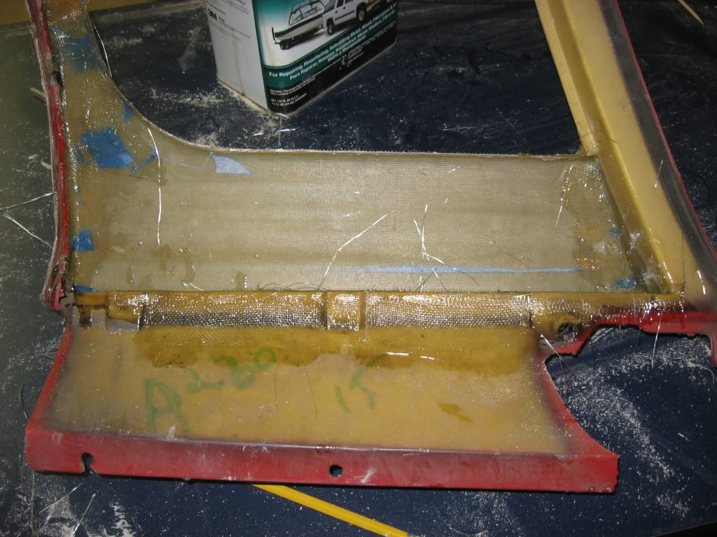

got some shots of the fiberglass on them about 4 layers i think
cut the back out and pulled out the foam and as much of the tape as i could
[IM
afteri got the foam and tape out i put a couple layers of fiberglass on the seams
G]http://i190.photobucket.com/albums/z256/1980cutlassben/IMG_2612.jpg[/IMG]
im hoping tommorrow i can get started on the vents themselves

You shouldn't be using woven cloth - you'll get a print-through. Use mat instead.
~ Paul
aka "Tha Driver"
It took years of effort, to become the mess that you see.
my other projects i sand down then put a layer of just resin over top. possible two. it gives it a very smooth surface for paint
Yeah.... that's not really a good idea either. Resin is not made to be a surface coating, & will probably crack with age. If you use mat, you can sand & prime the finished product & block for painting. I use PPG epoxy primer first, & if there's a lot of blocking needed I go over that with a high-build primer (catalyst-hardened). When the surface is smooth/flat, I seal it with the epoxy for maximum adhesion.
Just so you know, I've been doing custom fiberglass & mold work since the early '70s.

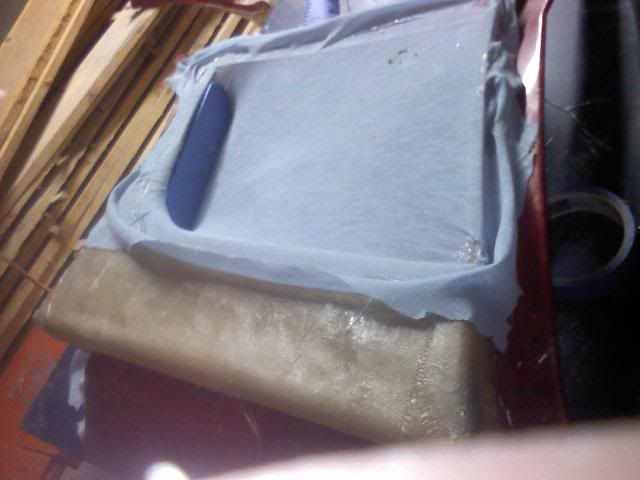

got a chance today to use some fabric to shape the vent. its held in place with superglue. peels off easy when im finished

put two layers of fiber mat over the whole surface. was clumsy and half the hairs on my arm are now plastered to my arm. feels great.

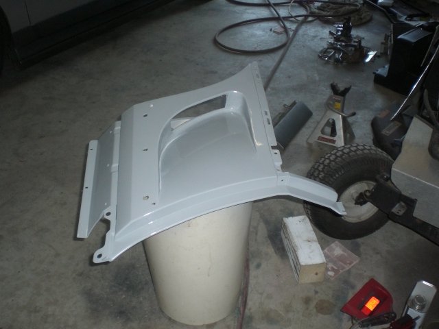

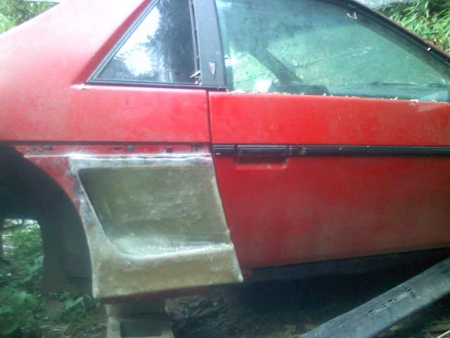

got the excess fiberglass trimmed off. did a test fit on the parts fiero and next comes the best part. sanding.......

I think it looks fantastic for a first try at it.. Love the shape too...

Question: you now have the air streaming into the scoop, heading straight for the INNER Fender (which will mostly cover it), Are you going to "duct" it anywhere for a particular purpose ?
86GTBen
Posts: 401
From: finksburg, MD, North america
Registered: May 2009
Report this Post06-27-2010 03:13 PM Click Here to See the Profile for 86GTBenSend a Private Message to 86GTBenDirect Link to This Post
not really sure. i wasnt planning on ducting them anywhere. more of just for the look of it.
I was gonna say the same thing. As cool as it looks, some air flow couldn't hurt.
