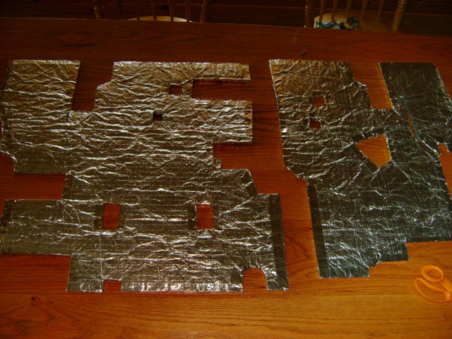

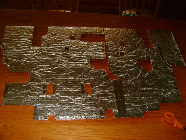

I just did this to my 88. I purchased the heat shield insulation from JC Whitney for about 40% of the cost from SummitRacing. I cut the piece in half before I installed it . It made it a lot easier to install. Once the silver tape was added it looked great.
Side by side:
Moved to show the cut:

what is the size of the pieces when its cut in two like that? having two smaller pieces makes the selection for a higher temp tolerable matt selection better. im gonna need the higher heat resisting stuff since i have some high heat plans for this car. no, not it catching on fire
I just went down from an existing cut out. I didn't take any measurement. You can see on the pictures I posted where I made the two piece cut.
