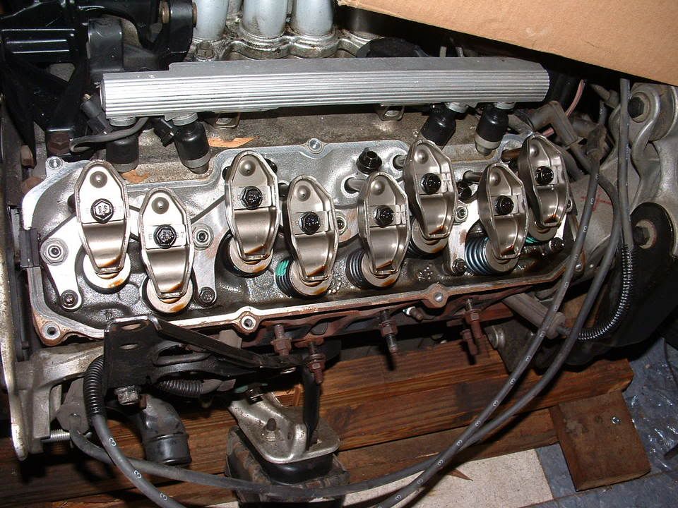

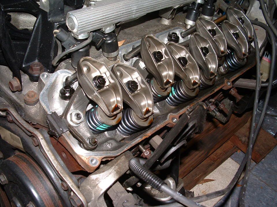

My 4.9 has the largest cam he was able to grind. Advertised duration: 282 intake/282 exhaust Duration at .050 in. cam lift: 220 intake/220 exhaust Gross valve lift: .498 in. intake/.498 exhaust Lobe separation: 110 degrees Peak horsepower rpm: 5,500 Peak torque rpm: 2,500
I am running heads shaved .050 with some port cleanup and matching, and have never had a problem with piston valve contact. I have run it up to 6200rpm, but there is no need to go that high, as there is no power to be had there.
This is NOT a drop in cam. It required machining of the valve seats and guides. I am using a late model chevy V-8 valve spring and retainers. I am not sure what they are, as I have misplaced my notes, though I am sure my cyl head guy will remember. I am running much more seat and open spring pressure, and I am using the Allante/Export steel rocker bridges to avoid pulling the rocker pivot bolts out of the aluminum. There is no valve float with this setup ( there was some with the stock engine and a higher rev limit). With this cam, you will need some longer pushrods, even with the heads shaved. I also elongated the slots on the rockers to prevent them binding on the pivots at full lift.
If that cam is one of their standard grinds, then it's the same one I'm getting. It makes sense that my numbers above would be off, as I think he was giving me lift at 1.5:1 rather than 1.6:1 And yes I've ordered the steel supports just because I don't want to mess with the aluminum ones...I've just seen too much bad news around them.
Elongating the slots on the rockers is really planning ahead.

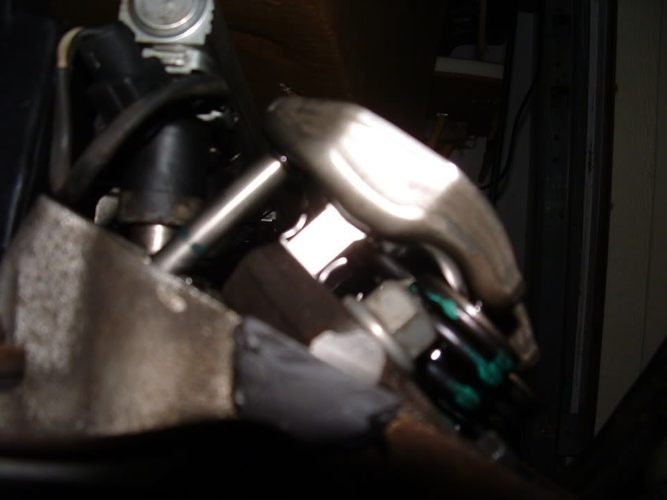

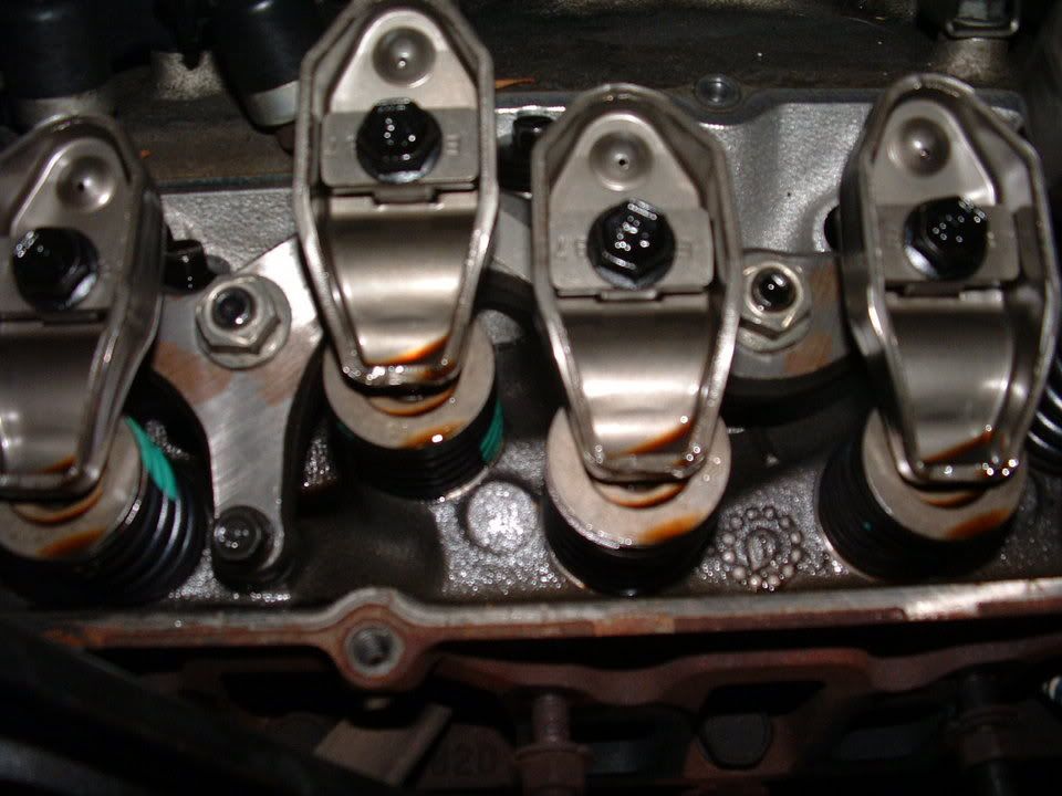

By the way, regarding an issue that scrabblegod briefly mentioned, although I don't know if you saw them in that somewhat lengthy, multi-page thread, there also are a couple of caveats there re pushrod length (of all things):
Originally posted by GT: I actually have more valvetrain noise in my engine than I feel comfortable with. I called Bud, and in his usual laid back manner he gently reminded me that he had asked me last year if I had used longer pushrods. I had told him no several times because Delta insists that my cam is a drop in. Bud laughed at me (in a nice way) and gave me a Competition Cams part number for pushrods that are .060" longer and won't flex (7823-16) and told me to give them a try. So I ordered a set. They're less than $50.00 from Summit.
So then I called Delta and asked if the "drop-in" cam ever needs longer pushrods. Now he says,"yeah on some engines you'll need longer pushrods depending on different factors. Usually about .060" longer." And I asked him if they knew about this. He said they knew it, but that not all 4.9's require longer pushrods.
Sheesh...
....I'll let you guys know what happens when I put in my new pushrods.
Originally posted by GT: Just an update on the pushrods. I installed the new pushrods last Saturday and it definitely made the valvetrain much quieter. I'd recommend them to anyone whose doing the cam swap. Bud said he puts them on all the 4.9's that he modifies the valvetrain on.
I'm sure the 4.9L still is the easiest V8 swap there is, but the cam and pushrod length issues associated with this swap suggest it may not be quite as easy and straightforward a "drop-in" as I'd once thought.
In any event, although I think your ride will be great fun when you're done with it, I wanted to ensure you're quite aware of this "longer pushrods" issue, Taijiguy.
