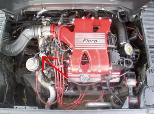

Lets clean up that EGR valve while were here. Two 13mm headed bolts and a vacuum line and it's off. Be careful not to bump around the tube that leads from the block under the EGR to the bottom of the intake manifold. They are prone to leaking.
Two bolts and the vacuum line and the EGR valve should be in your hands. Clean any carbon deposits from it with a wire wheel Check to make sure it moves up and down ok. Then push it up, seal the vacuum line with your finger and make sure the diaphram stays in the up position. Then pull your finger off and the diaphram sould return to it's normal position.
The problems that could cause the troubles like you describe are a stuck open (retracted) valve, or a valve with carbon deposits that hold it open. Usually the trouble is much worse at idle and low speed engine operation. Usually at higher speed it doesn't make as much difference.
It's easy to clean, and easy to test so might as well have at it and either prove it to be the cause, or eliminate it as the cause.
It's the big round thing right next to the arrow head
