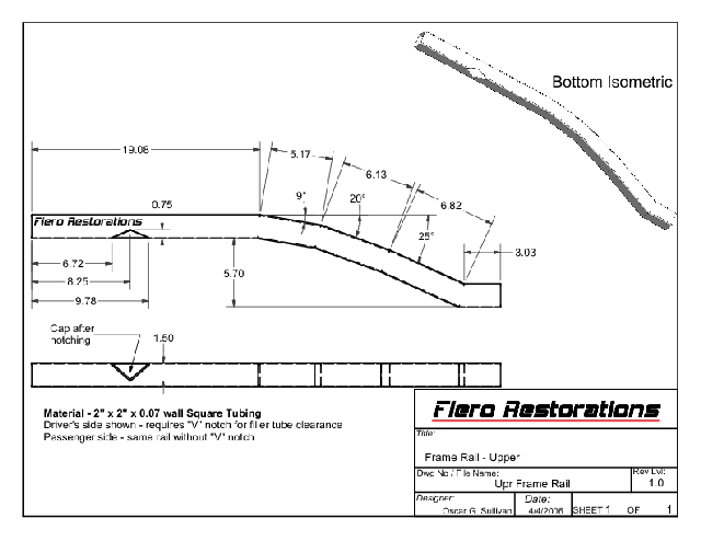

You can either do as I did in this thread here and fabricate new sheet metal parts: www.fiero.nl/forum/Forum2/HTML/102998.html or replace the entire upper frame rail with some square tubing as some folks have done using drawings by a PFF'er posted somewhere else. PM me if you are interested in more details about how I made the frame rail parts on mine.

Report this Post10-26-2010 01:09 PM Click Here to See the Profile for phonedawgzClick Here to visit phonedawgz's HomePageSend a Private Message to phonedawgzDirect Link to This Post
Not my fix but just a pic
Robert 2
Posts: 2401
From: St Hubert Quebec Canada
Registered: Jan 2006
Report this Post10-26-2010 01:55 PM Click Here to See the Profile for Robert 2Send a Private Message to Robert 2Direct Link to This Post
Not from me but , thanks to who it's coming from
