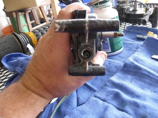

Report this Post06-20-2010 01:27 AM Click Here to See the Profile for katatakSend a Private Message to katatakDirect Link to This Post
Here's the adjustement screw and ball bearing:
It goes in the bottom of the housing:
The ball bearing sits in a "dish" in the end of the armature/wormgear shaft. You want the bearing making contact with the shaft and the adjuster screw - not snug. I just turn the adjuster screw till it makes contact with the shaft the back it of 1/8 to 1/4 turn and lock the jam nut down. You do not want very mush play n the armature shaft.

Report this Post06-20-2010 01:35 AM Click Here to See the Profile for winglessClick Here to visit wingless's HomePageSend a Private Message to winglessDirect Link to This Post
WOW! excellent, thanks alot for the pics! Ill try that tomorrow night! Much obliged!
