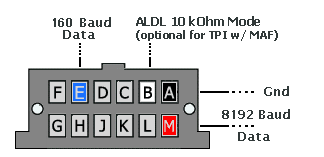

Here is the way I have mine wired up. I hope this helps:
Joe

So now there looks to be conflicting information
ALDL
This one (Fieroseverywhere) -
A to ground
B to ECM E12
G to ECM E13 and Fuel pump relay tan/wht
L/M (retty sure its really just L but I did both) to ECM A8
And this one (Joes)
A ground
B ? 10k ohm mode?
M 8192 Baud Data
E 160 Baud Data
Codes Scanning
This one (Raydar, Johnsop1, Fieroseverywhere) -
8th vin B
4th vin C
And this one (Fiero Kings) -
vin B for 1991 model year and Vin M for the cadillac 4.9 at 8192 baud.

Then whats with the C vs M thing? I thought they were car type code or something. I dont remember if that was even an option. I know after entering 8th B there are only three options remaining for the 4th vin letter.
Regardless. You will have to pardon my ignorance. But 10k ohm and then a bunch of other stuff marked on pin B is cryptic to me.
Are we in agreement that
A to ground
B to ECM E12
M to ECM A8
is correct?

Looking at the face of the ALDL connector (car side) this is what I use (right now I have no idea what pin numbers they are - when I wire I just look at the picture and put that wire in that spot) - this works on AutoXray and an Actron scanners that I have tried (note: plug 'key' on the bottom):
When running my scanner it asks for year, 8th VIN and 4th VIN, as posted, this is what to use (this is what I use) - there is no need to try and figure what the codes mean or at what baud rate xx is at (you can't change that, and in all intent and purpose you really don't care) :
8th vin B
4th vin C
My scanner will also ask if it is a 5.0l (of which you would answer no).
Install the stock chip and try a scan (the scanner doesn't care) - you might even be able to start the car, all depends on the passkey reaction (I have fluked out and started a car a few time without a bypass, but most of the time it wouldn't run).

To avoid future confusion it should look like this.
Well thats what I have. I will swap out the ECM asap when I have time and report back with the results.
Thanks

My chip is a burn by rockcrawl (92 deville). He had problems flashing it as well. It took him two tries, so I am somewhat suspect that the chip is the problem. Without him around and given what someone said about stickpony there really are not alot of options. I wonder if I could get Joe (rockcrawl) to give me or someone else somewhat of a basic rundown on how to mod the values in the bin file to adjust for idle, wheel size, fan temps, etc. Unless of course you want to step up stickpony and show us that you can provide the same service reliably and in a timely manner. Not trying to call you out, just seems that there is a real opportunity here. People are cautious though.
I also think having the base bin file that he uses, assuming he has no interest in selling them anymore, in the (relatively) public domain of PFF and other fiero resource sites would be invaluble. Maybe stickpony would be willing to share how the bin works. I would think that regardless of whether people know how most would still choose to have someone else do it, alot of that having to do with the buy in regarding a prom burner.
Also I am going to have to agree that although the caddy diag system is built for the thing it just seems like it would be a huge hassle to get to work correctly in a fiero, not to mention it adds a fairly large amount of other stuff that you need to complete a swap. I actually considered going carbed to avoid all this hassle but decided that if I was going to do that then I would just do a 350 instead. Partly its the technology that makes the 4.9 so great and helps people achieve mpg numbers in the high twentys and low 30s definately one of the deciding factors when deciding on a swap to be used as a daily driver.
Jscott where is your 02 located. Mine is on the rear manifold. I went heated because I didnt know where I was going to put it.
