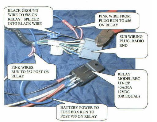

Below is an illustration of what I did.
You you need to 12V of power to the factory sub amplifier. The stock Fiero did just that. The method pictures below will only supply the voltage to the amp when radio and key is on.
I have a factory sub system, wiring adapter harness going from the older style radio
to use the newer delco cd radio.
I wanted get things set-up so the factory sub would turn on when the radio turns on.
So i installed a relay.This is what i did.

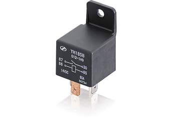

i found this picture earlier and i am going to do this. i also found a pic of the plug that i need it. Where did you get the relay from? What kind is it?
Edit: found it on radioshack's website. Model 275-001 12vdc/40a spst

That'll work
Radio Shack has them $6.99
