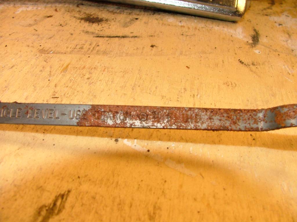

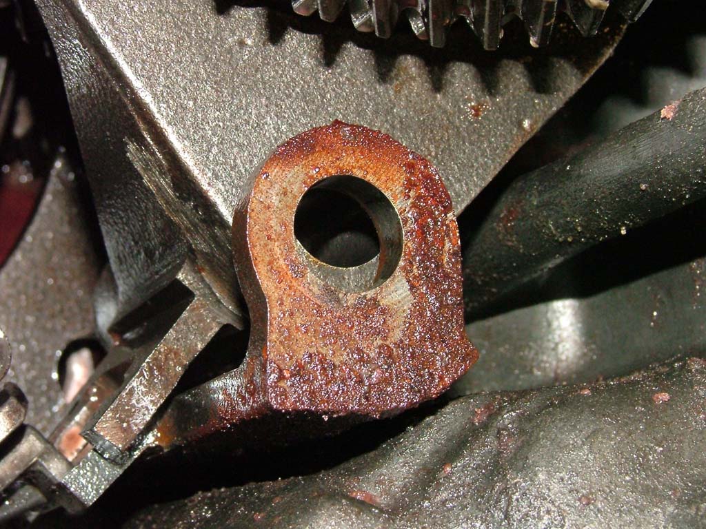

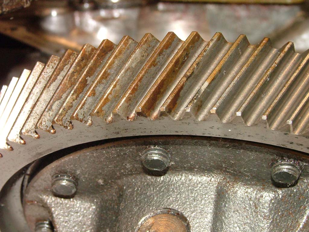

Unfortunately it is a moot point as this junkyard transmission has seen better days. It had residual ATF fluid in it which isn't a problem in itself but the fluid had been drained and it sat without fluid in it for quite some time and some moisture found it's way inside the case. Both the diff gear and the output shaft have some rust and pitting on them and I don't feel comfortable using them as there will be reduced life as result. I took pictures and will post them here later tonight.
For anyone reading this, could the ATF be partially to blame for the corossion on these components? How does the oil film of ATF compare to 5W30 motor oil or syncromesh? Just curious for MDS such that he can possibly use the info to get his money back on the transmission.

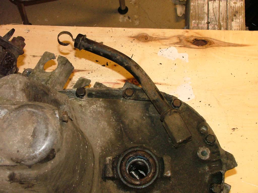

does it have the FWD shift levers or the fiero? are the fiero shift cable mounts on it or just the FWD vehicle ones?
the surefire way to identify it would be the sticker thats on it( if there is one ). it will be a series on numbers and letters, and "NA" or "DJ" will be in the part number printed on the sticker if it is a fiero econobox

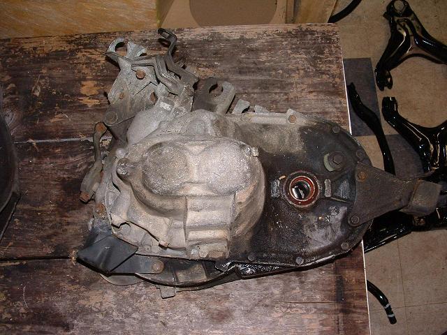

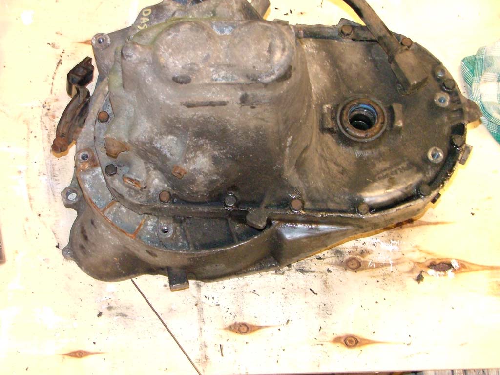

Ok, First off. I think this transmission is from a Citation because it has a cable drive for the speedo and a dipstick to check the fluid level. For some reason I did not take a picture of the speedo drive but here is the dipstick. The first indication of what I would find inside this transmission presented itself when I pulled the dipstick out of curosity. After I wrote my last post I noticed that the dipstick calls out Dextron II fluid. This is what I found when I opened the case. The white milky fluid is moisture. Also note the magnet in the upper right corner of the picture is covered in metal debris. This was supposed to be a low mileage unit but the amount of debris tells a different story. This is the component which had the most corrosion. This is the Diff Gear. The dark spots are pitted. Other side of the same teeth. Then this is the output shaft again the dark spots are pitting. Also notice the teeth look like they are polished in the center. This is wear and another indication that this was not a low mileage unit. So after finding this I put it all back together in case MDS needs it to get his money back from the junkyard.

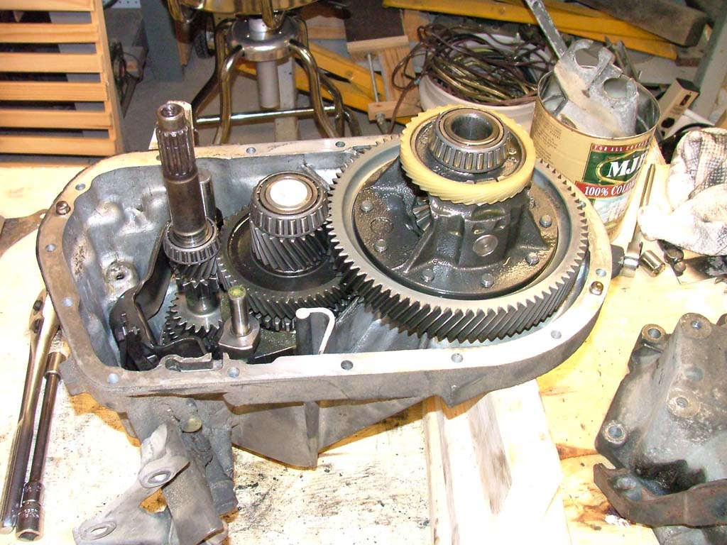

I also opened up my 3.65 unit and this is how one of these transmissions is supposed to look like inside.

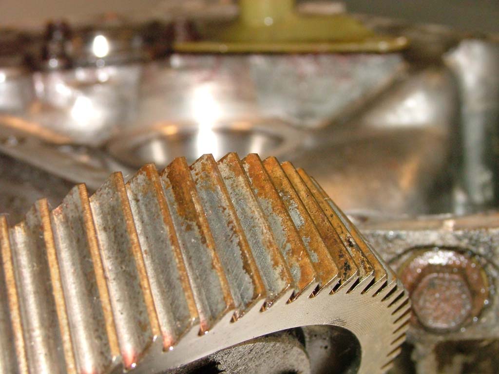

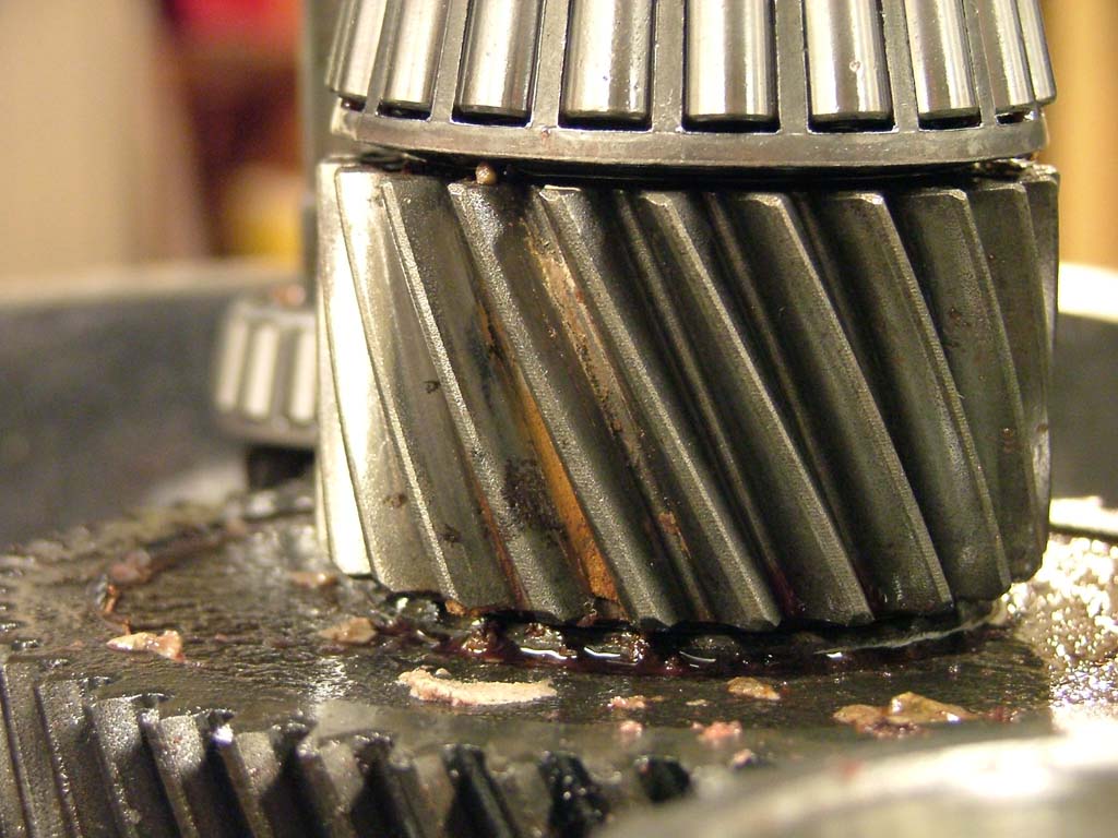

Originally posted by Jefrysuko: Then this is the output shaft again the dark spots are pitting. Also notice the teeth look like they are polished in the center. This is wear and another indication that this was not a low mileage unit. So after finding this I put it all back together in case MDS needs it to get his money back from the junkyard.
Have you tried cleaning it up with emory paper? It might surprise you... IE, you can stll see the machine marks on the tips of the teeth. That gunk should just polish out. That doesn't look like bad wear on those teeth at all. What does the wear look like on your 3.65 final?
[This message has been edited by Will (edited 01-02-2010).]
Yes I agree the wear does not look that bad but this was supposed to be a 40k mile unit and the wear patterns indicate otherwise. What concerned me was the pitting which was hard to capture in the photos. We did clean it up a little which is what revealed the pitting and the more we cleaned the more we found.
The wear on the 3.65 unit was almost unnoticable. There was no polishing on the surface of the teeth. IIRC it was supposed to be a 70-80K mile unit. It appeared to have had motor oil in it as well which is what I expected from a Fiero Unit.
I brought up to Jeff on the phone that although the car showed 42k miles, if the transmission in the car had a cable driven speedo, it could have had 200k on it for all we know plus what was on the transmission when it was installed. I'm starting to hate transmissions.

All 85-86 4-speeds are the M17 version with a 3.65 FD ratio. That version has more ribs to the case which make it easily identifiable as well.
If you want to verify gear ratios look at my spreadsheet under the "Overall Gearbox Ratio" columns. The number listed is the amount of turns of the input shaft are required for one rotation of the Diff. When MDS did this exercise with his transmission in 4th gear he got approximately 2.7 turns and not the 2.42 turns he was expecting which told him he did not have the MY8 version.
You can see a couple extra ribs that are not present on the Citation version. It isn't anywhere near as ribbed as the Fiero V6 version, but different nonetheless.
