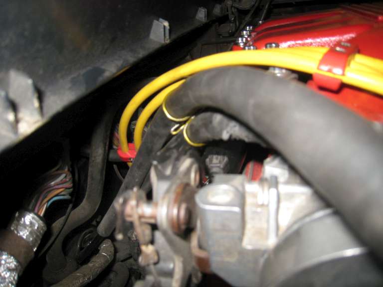

Here was my last 2.8/Isuzu swap. If you rotate the rubber air intake down slightly, the cables can run over the top. Notice the one cable by the throttle body is wire tied to the vent tube to keep it away from the throttle cable.
