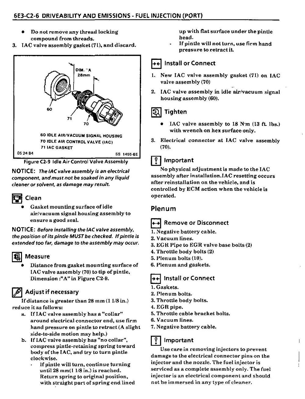

Did you set the IAC before you installed it? The ECM automatically adjusts the IAC, but only if it is installed correctly. See below ↓
If not that then I would look for a vacuum hose that came loose.

hhhmmm..i did not but i will
i did a vacuum leak test last night by removing the iac and plugging the hole...the car shut down immediately...it's my understanding that this means no vacuum leaks....aside from adjusting the iac as stated above which i will be doing tonight, anyone have any other suggestions on what else i should check while i'm at it? thanks
