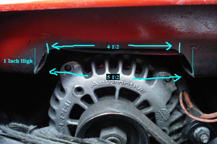

James Bond 007
Posts: 8872
From: California.U.S.A.
Total ratings: 263
Report this Post08-08-2009 08:13 PM Click Here to See the Profile for James Bond 007Send a Private Message to James Bond 007Direct Link to This Post
Just be carefull not to cut too deep,the trunk lid release wireing is inside there.Wait for pics to load (and if anybudy asks,I moved the wire thats touching the alternater).

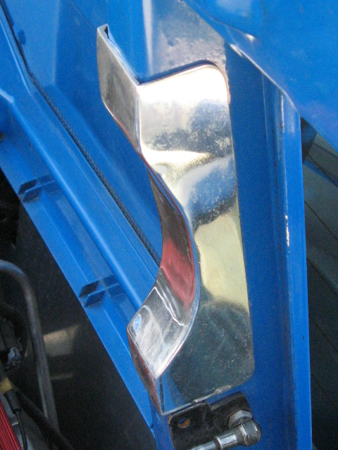

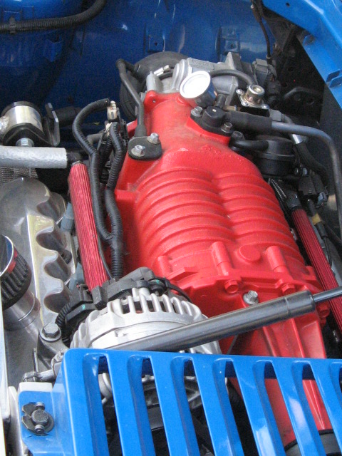

Report this Post08-08-2009 10:17 PM Click Here to See the Profile for MountainHiBlue87GTSend a Private Message to MountainHiBlue87GTDirect Link to This Post
Folks:
Here is how we did it:
Regards,
David
