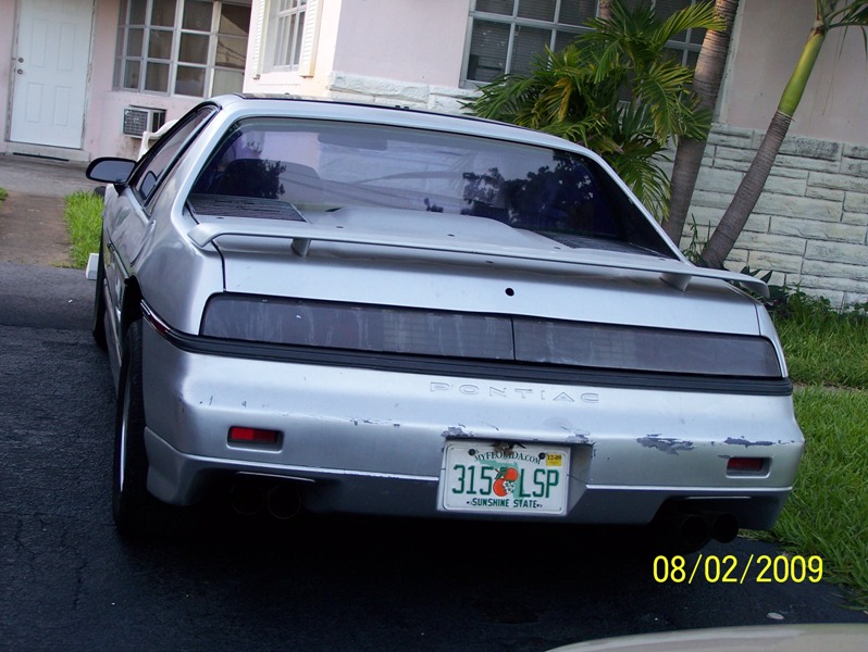

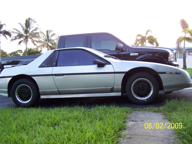

ok heres some updates with what i was able to do today
i was able to get the Notchback clip off and with the help of a friend able to get the Fastback clip to clip in right under the roof (you do this first right?)
i did not bolt in anything at all on the fastback, its simply tucked under the roof with the 3 studs sitting inside their respective hole
this is the hood just sitting on top of the engine (in case it rains)
wondering if after the hood is mounted will it close? This is an 84 notch trunk interior untouched

bonus pics, with the bumper just sitting, gonna try to cut down the bracket a bit more i think the GT bumper will fit fine now it lines up much better already and nothings even bolted in,

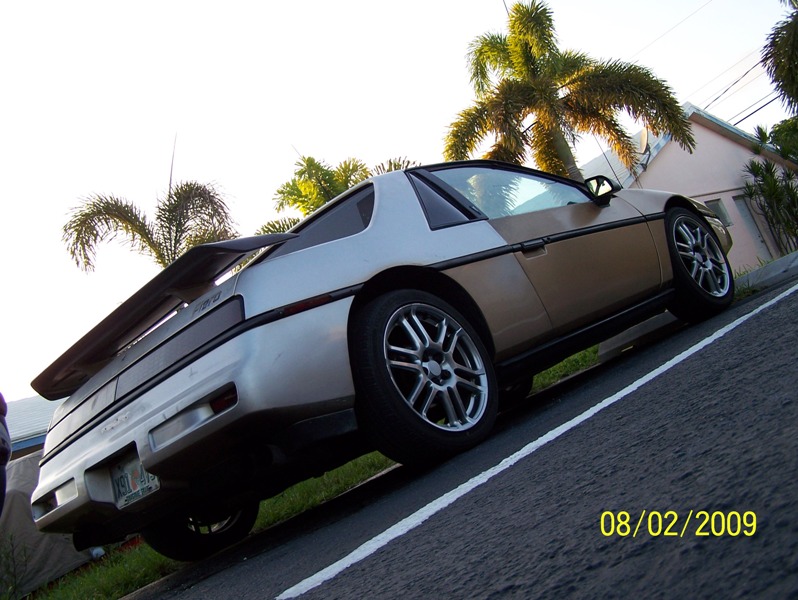

more updates, this thing is coming along slowly but surely
me after finally lining up the fastback with everything else
had to "re adjust" the old 84 Vent bracket to make this one fit and screw in/out like the old ones
Fastback clip bolted in
for the trunklid to fit i need to cut two tiny little corners that are unseen on the outside, they are in the very very back right under the window glass, i have to cut a tiny bit off so the trunklid can fit, also i think i need to drill two holes for the tensioner bolts to go in, im going to need help from my dad to get this on correctly though
Took it to the gas station down the street just like this to put some gas in it since the tank was nearly empty and i had some guy check it out and talk fieros with me for about 20 minutes, apperently he had one in the 80s and his girlfriend had a GT in the early 90s.

got everything to line up and bolt down today, fasback clip, vents, trunklid, gt bumper
had to make spacers and bend and cut some metal off the 84 bumper bracket to make it fit but for now it will work untill i get the GT rear bumper brackets
