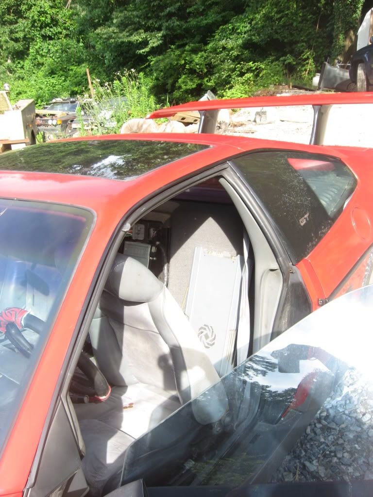

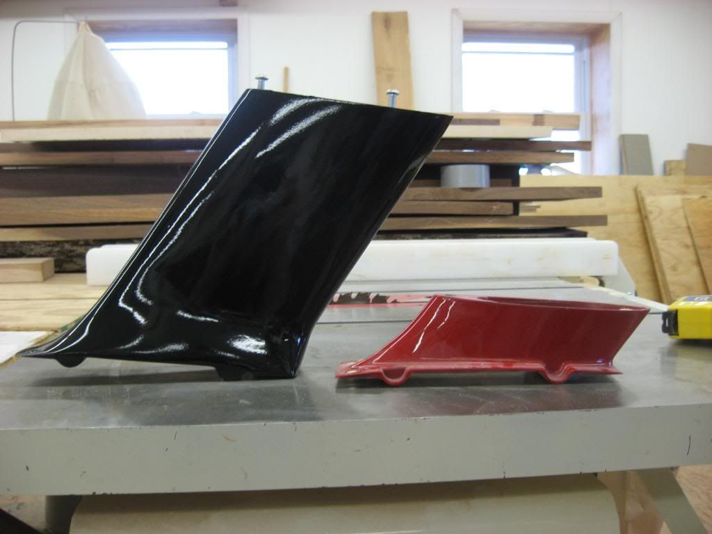

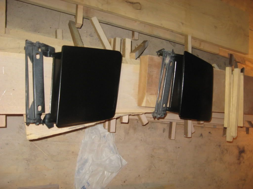

i recently finished the spoiler stands and got them on in this thread
https://www.fiero.nl/forum/Forum2/HTML/100837.html

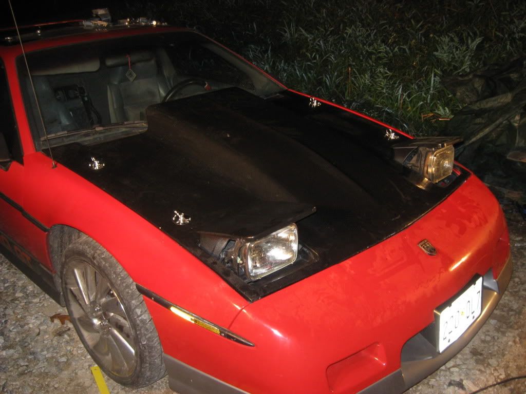

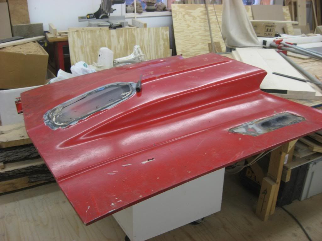

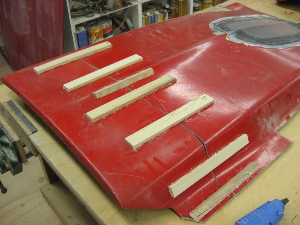

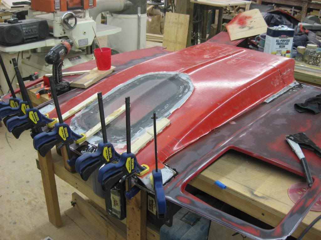

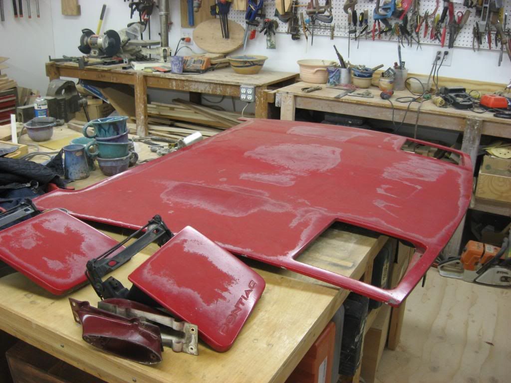

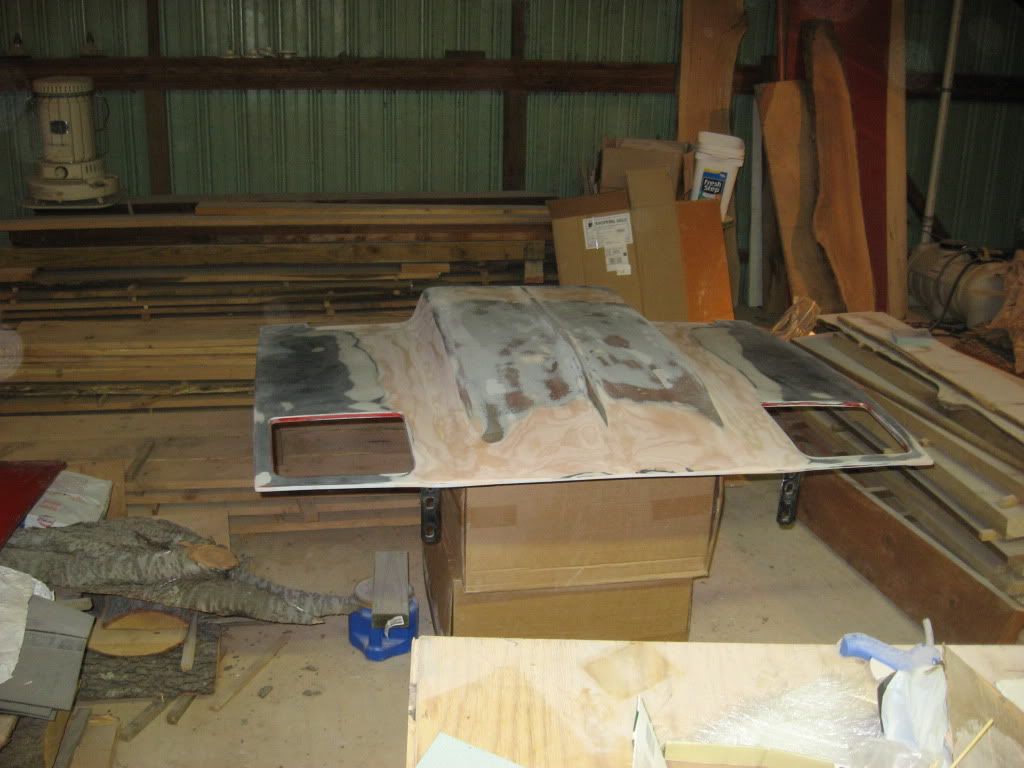

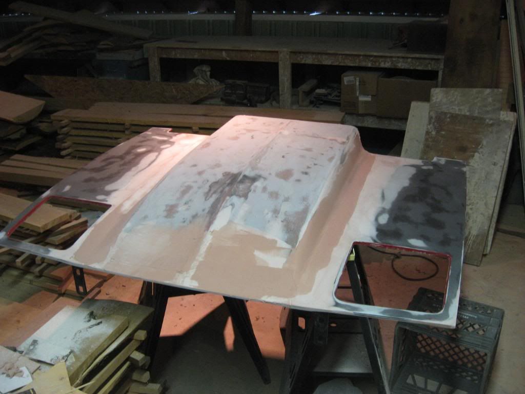

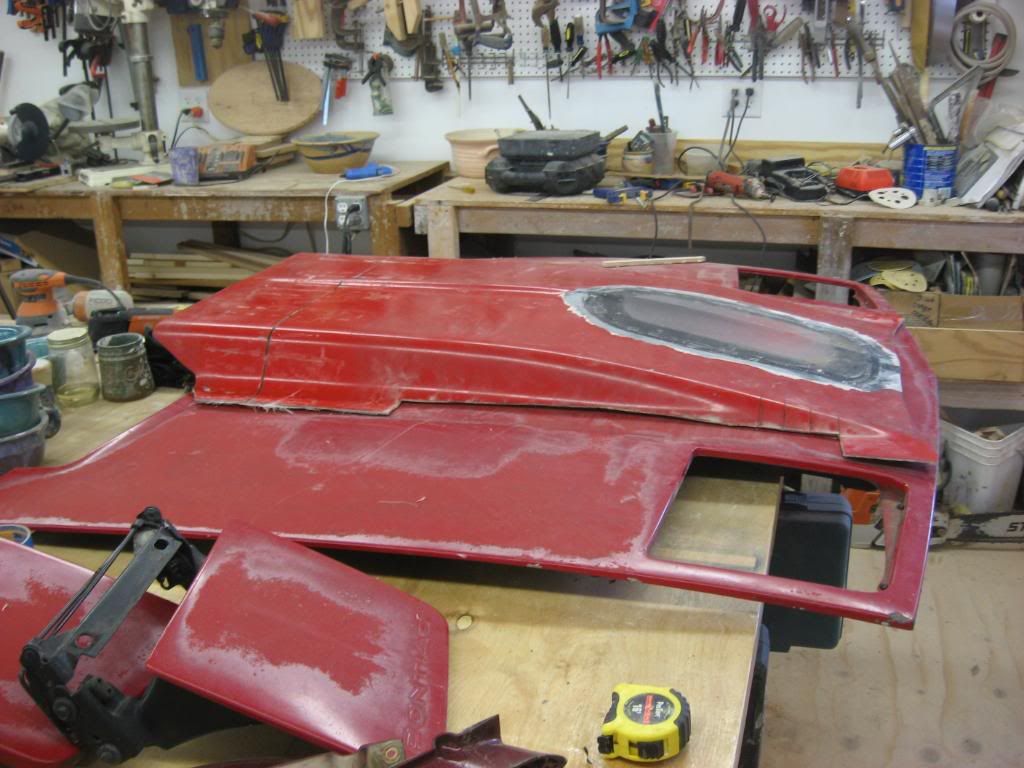

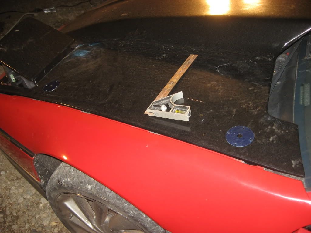

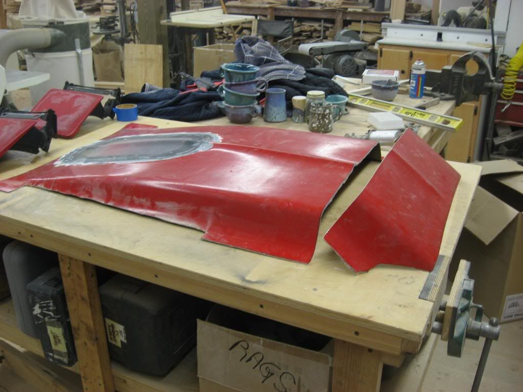

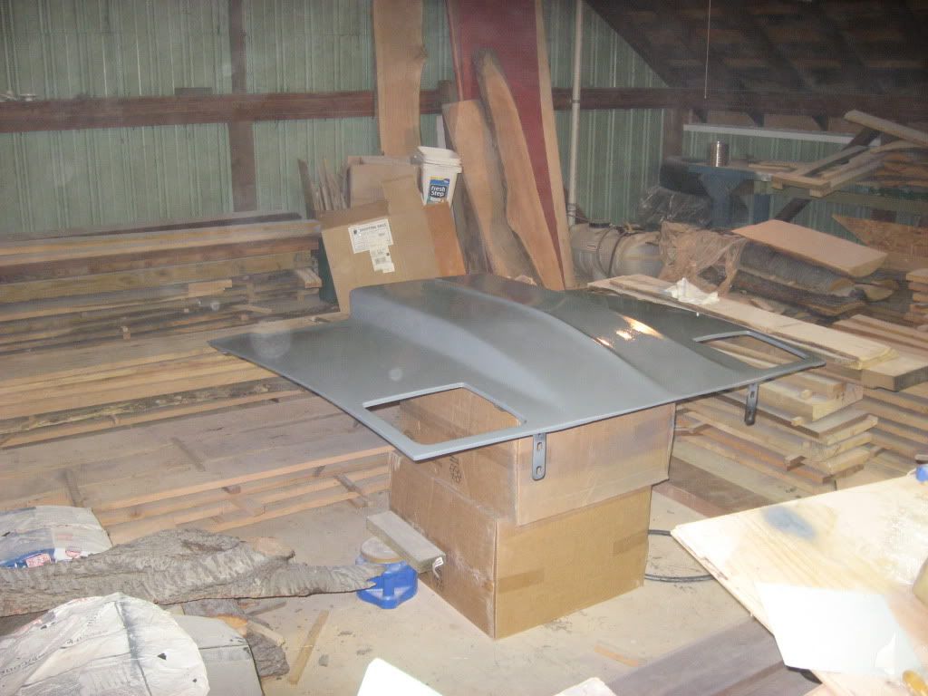

currently i am almost done on my new hood. im putting on a 4 inch cowl induction that was donated from an old hood i had on my cutlass until i sold the car.
had to shorted the cowl a couple inches
i finally had some time this week after work to get alot done on it. finished up the countless hours of sanding and got a coat of primer on
i went out to pick up a can of black paint so hopefully i could finish up this weekend. every time i looked they had the paint i wanted. went in last night and it was sold out. gotta love that. so maybe sometime this week ill get it painted and on the car.

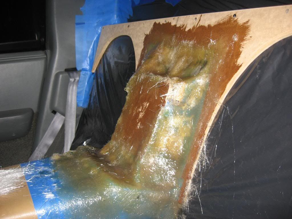

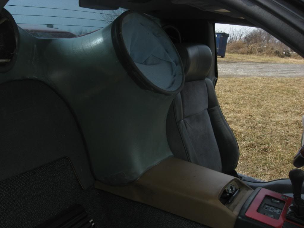

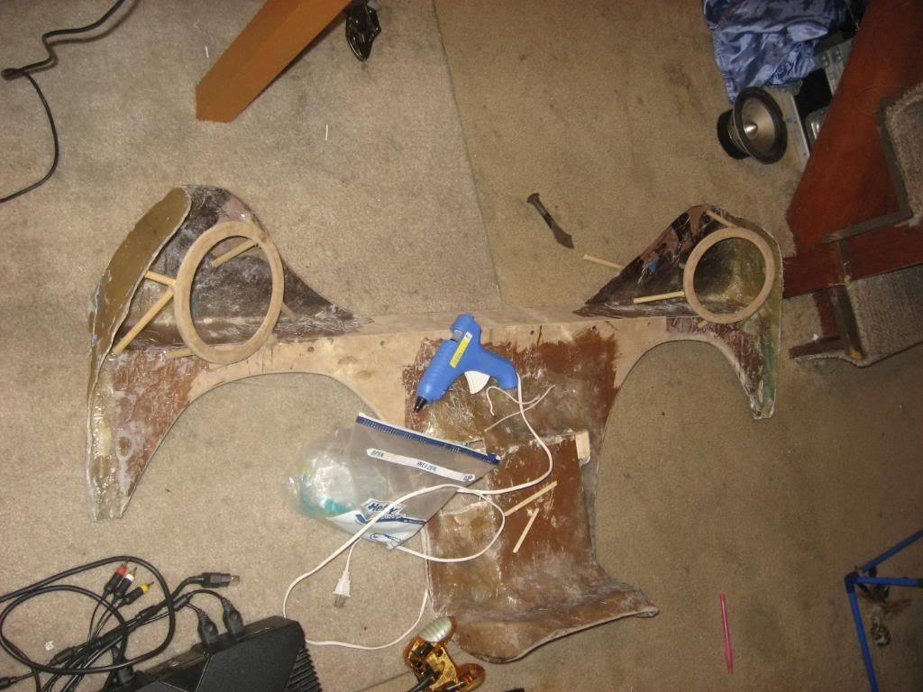

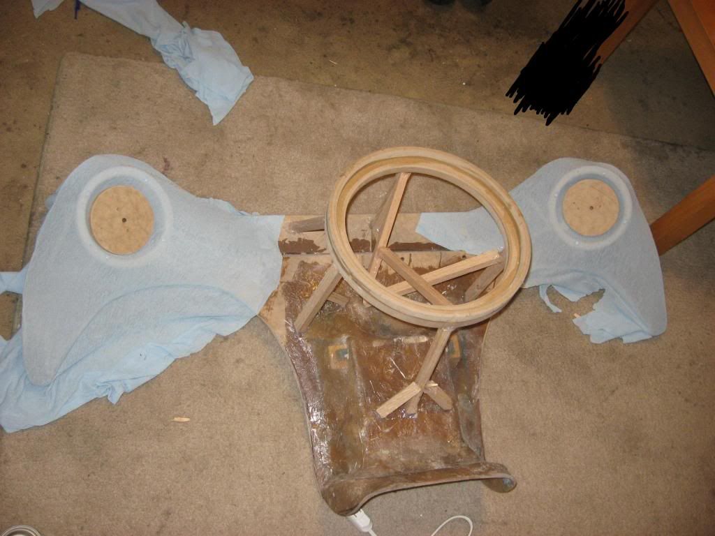

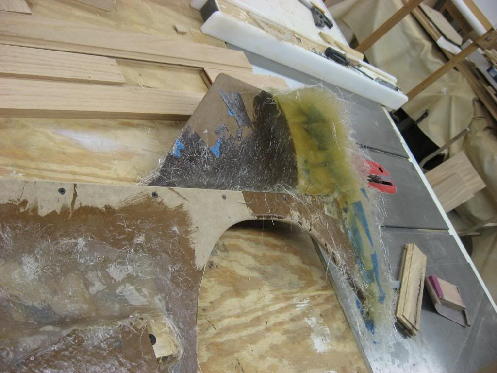

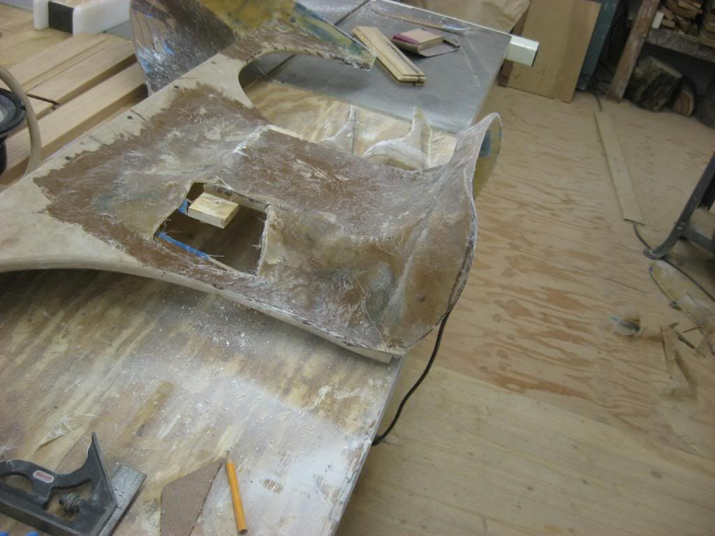

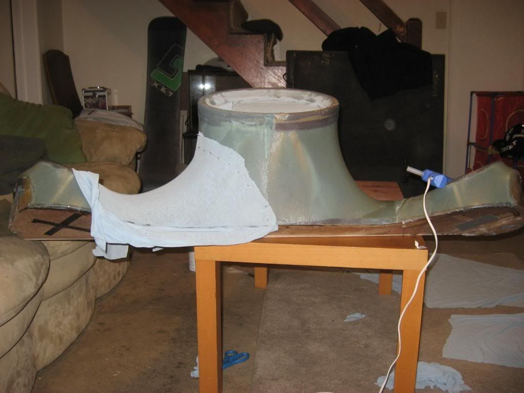

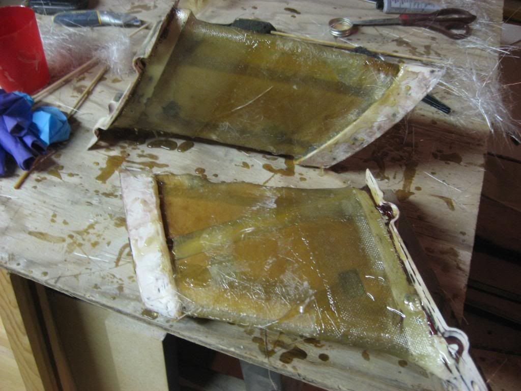

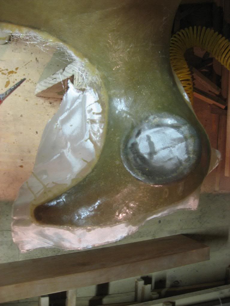

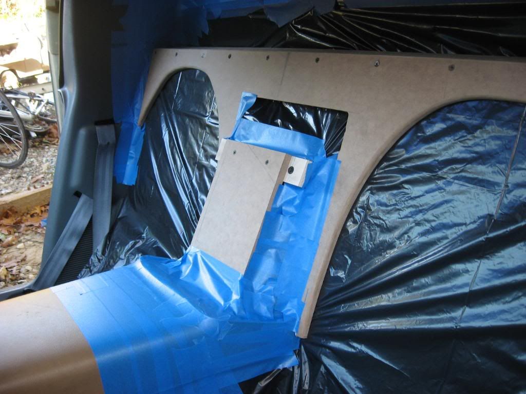

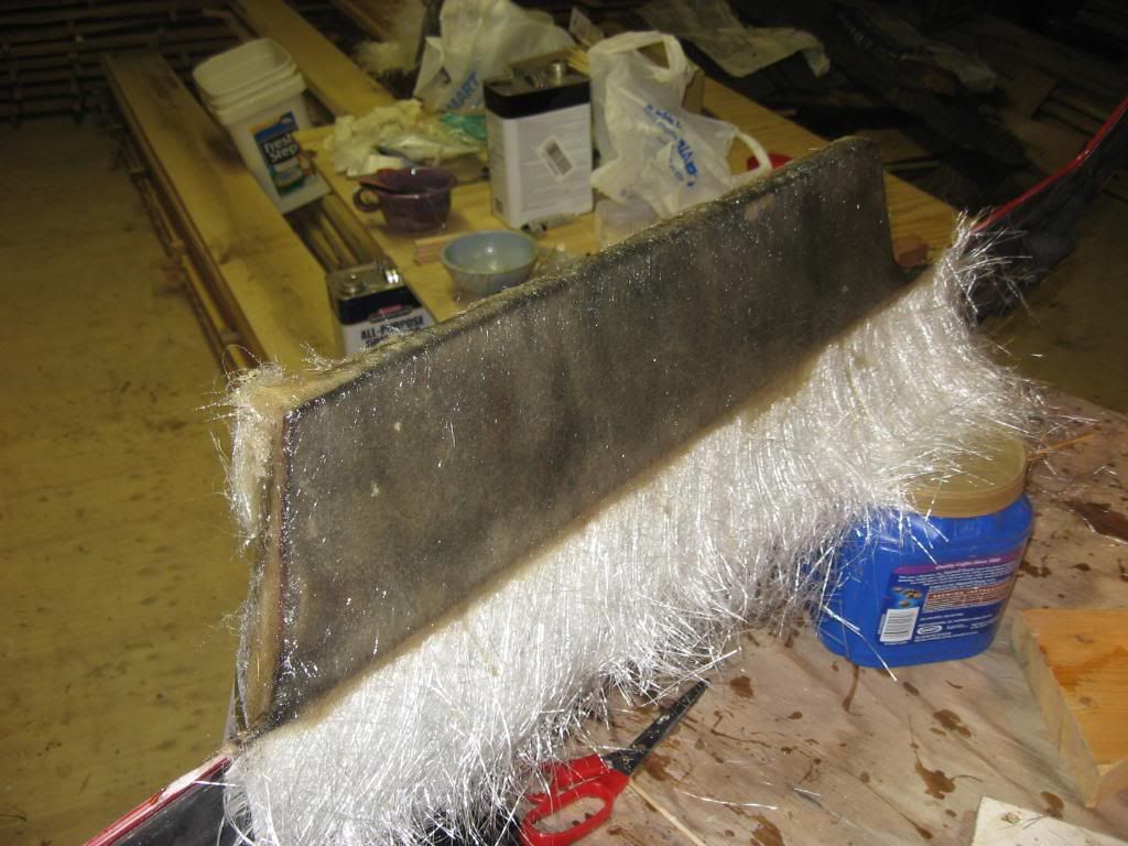

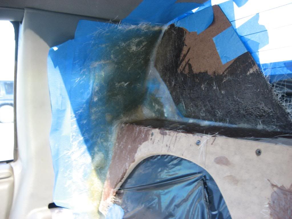

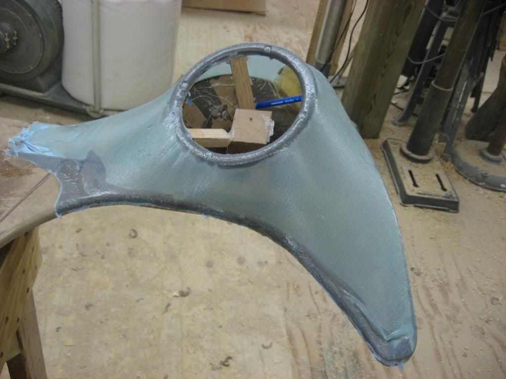

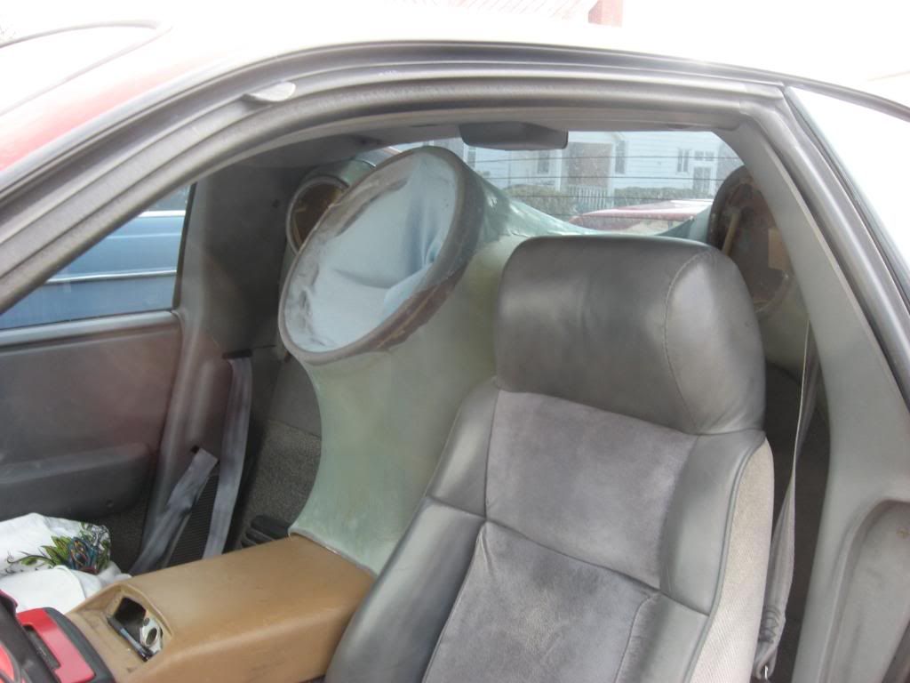

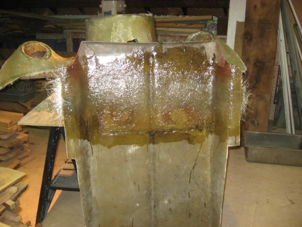

about december i decided to put a system in my fiero. still not finished but its defintly getting there. due to moving and other things this project was put on the back burner. tommorrow ill post a pic of the sub. 12" FI Q subwoofer.
i started off with a base to get the basic shape and to fiberglass on.

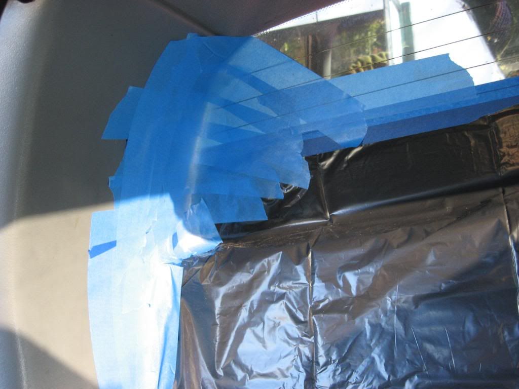

taped and covered everything so i wouldnt drip resin over my interior.
once a couple layers were laid down i let it cure for a couple days before trimming off the excess
the hole is a spot i had to redo because of a large bubble.

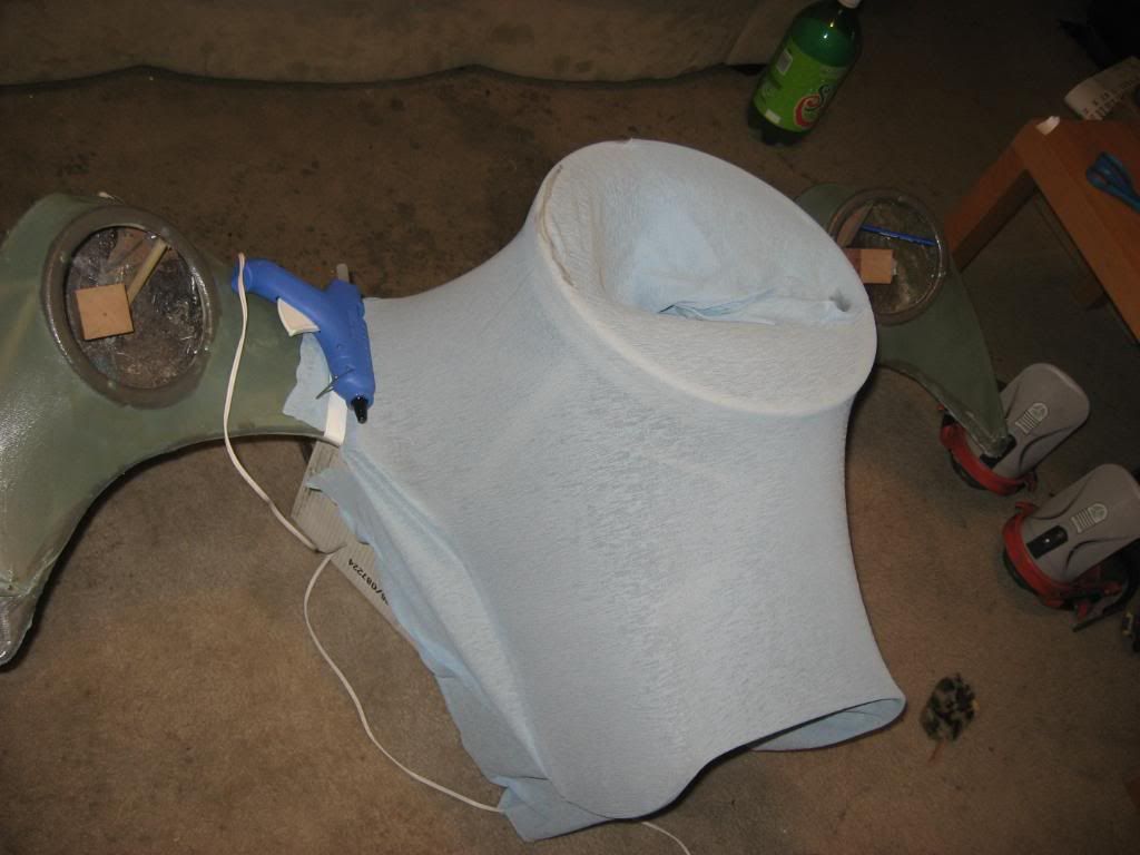

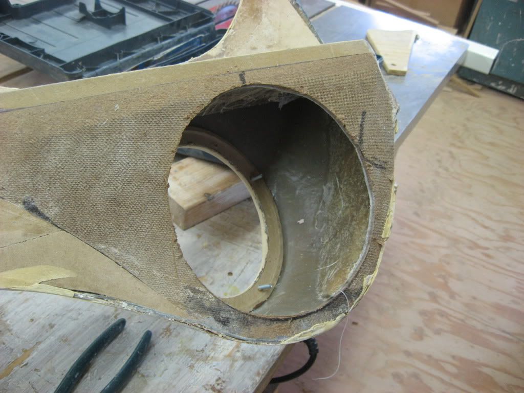

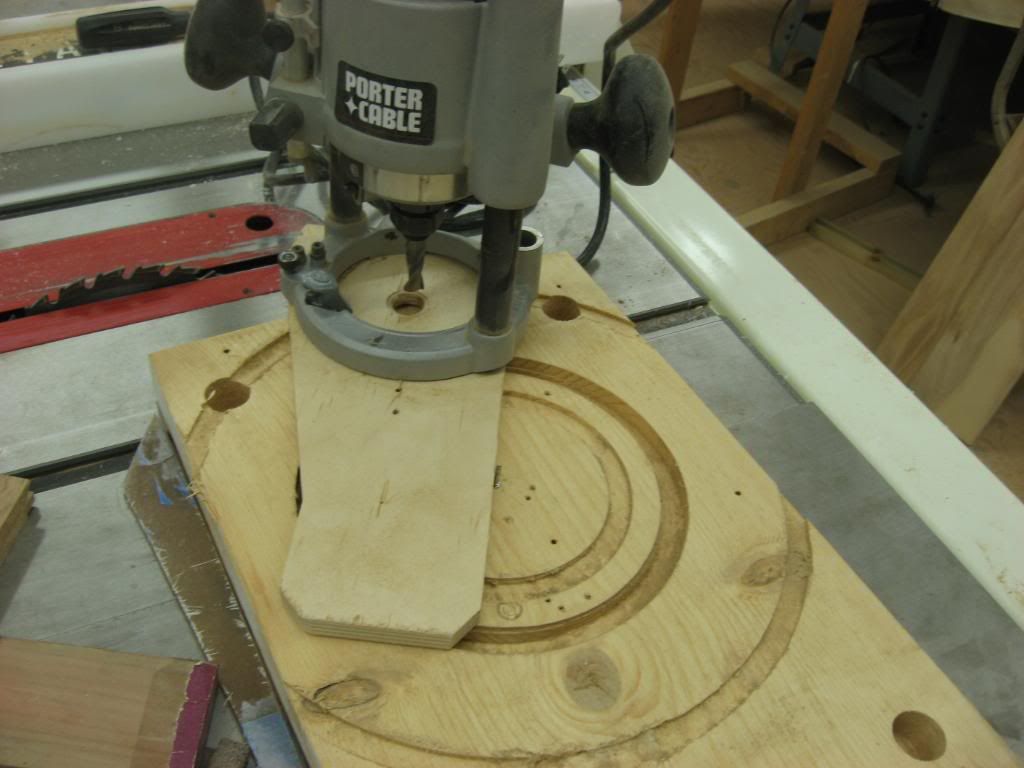

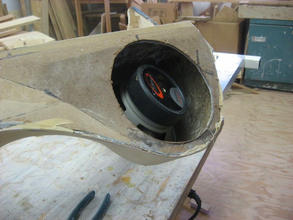

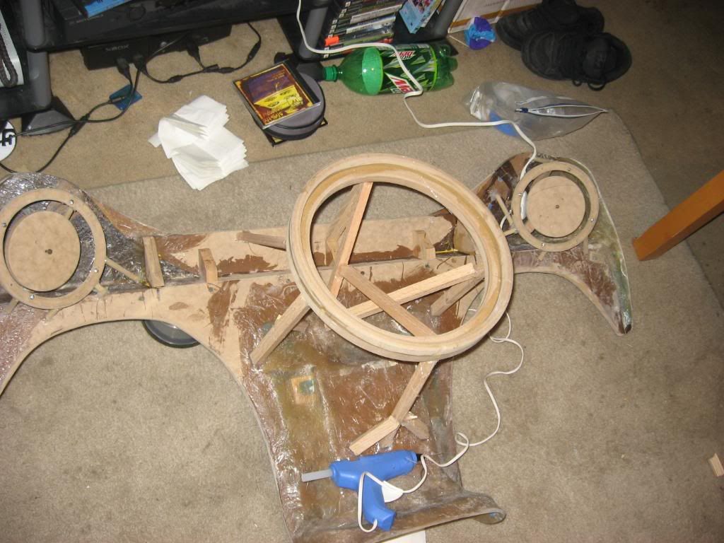

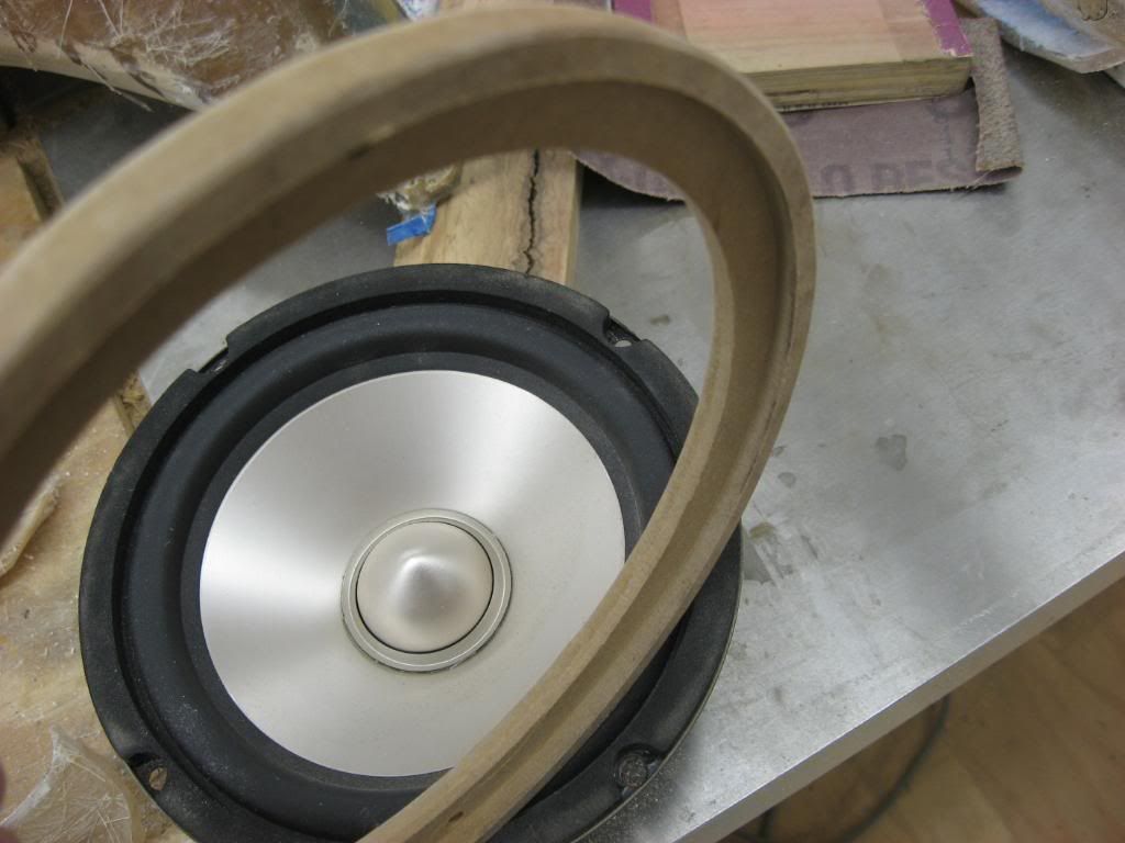

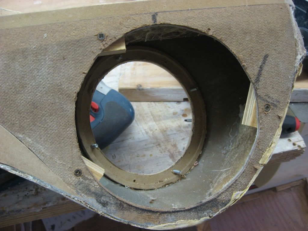

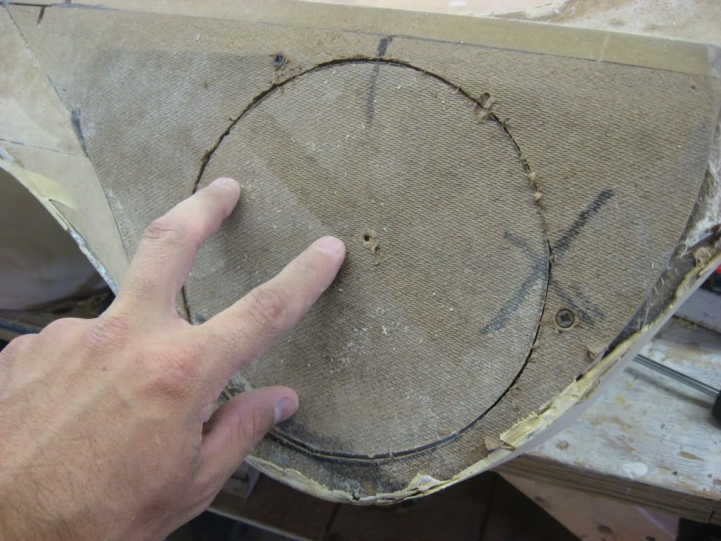

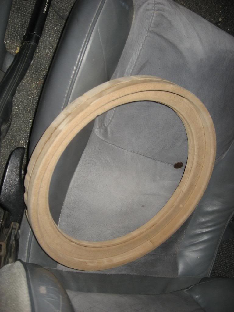

i made my own jig to cut out my speaker and sub rings
once everything was trimmed to where i wanted i started to mount the rings. hot glue is a great help here

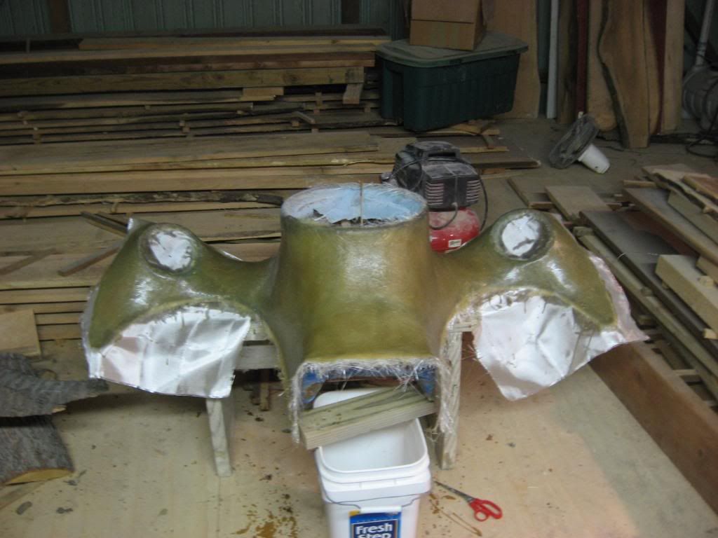

once everything was test fitted and put in place the covering began. i used the cheap fabric from joe annes. finding a fabric that stretches both ways is very important
after i got all the wrinkles i put a coat of resin on and this gives a good base to start layering the fiber cloth on.

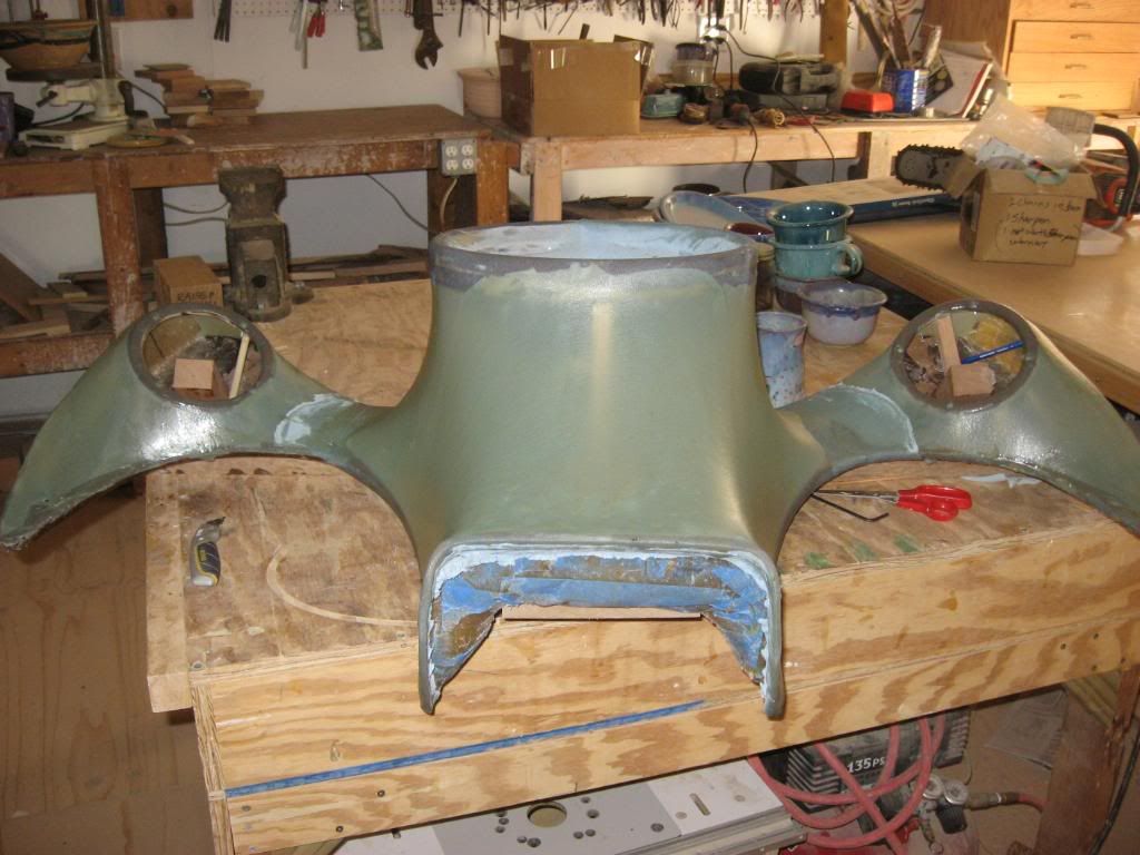

i wanted to give it a better curve and also pick up a bit of internal volume so i added on
after i got it tot he shape i wanted i started putting on layers of cloth
its about 3/8 thick and thicker in parts. i havent gotten a chance to work on it recently because i have spent time working on my hood. it has a layer of body filler that needs sanding but thats a week or so off.

That is NUCKING FUTZ!!!
You are a mad man... its a good thing that Fiero door windows don't have a frame... you would blow them out I have to say that is one of the more agressive speaker setups I have seen... Claytonto had something similarily wacky in his car for a while as well...

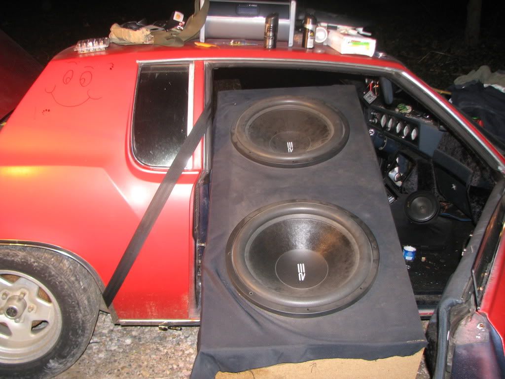

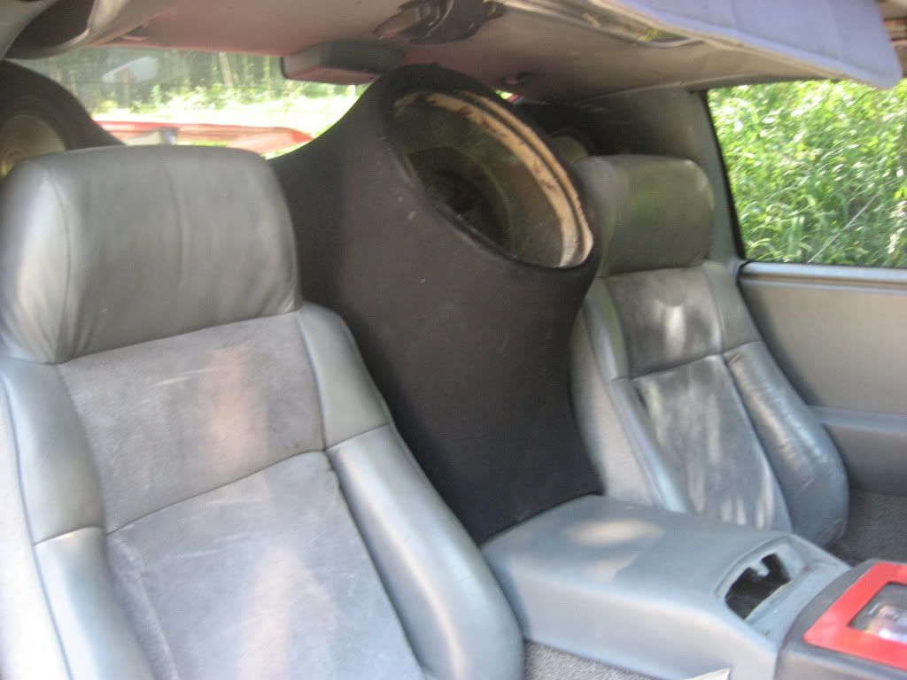

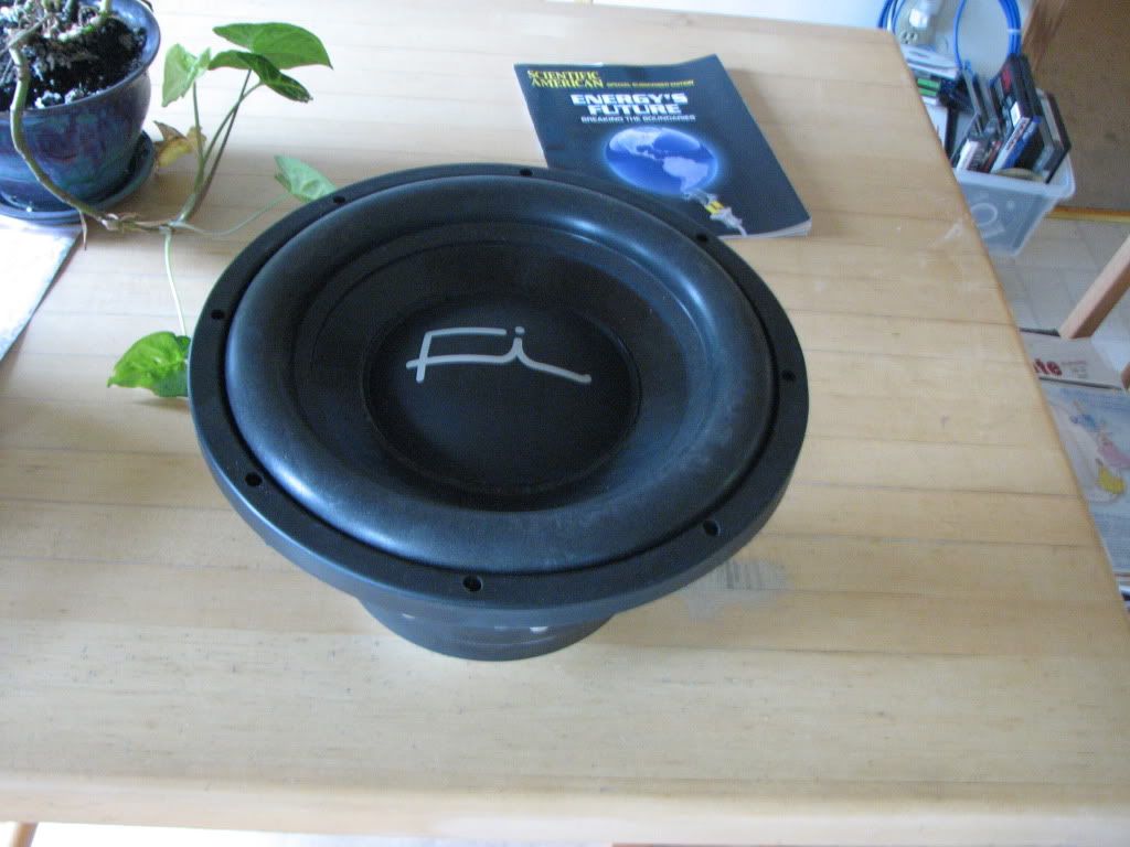

yea i didnt want it to stick out as much but i picked out the FI sub i wanted and that was the only way i could get it to fit.
this was my old system in my 80 cutlass. 2 18" RE SX subs. the box was 18 cubic feet and took up from right behind the seats to almost the whole trunk. this one blew out my rear window

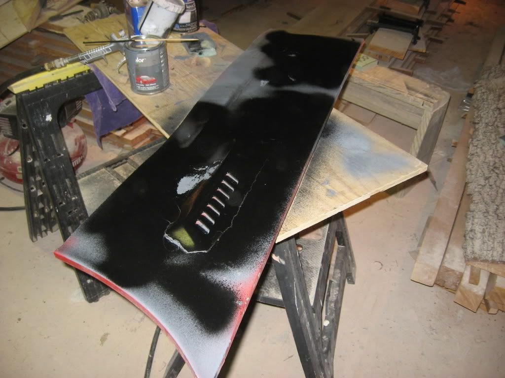

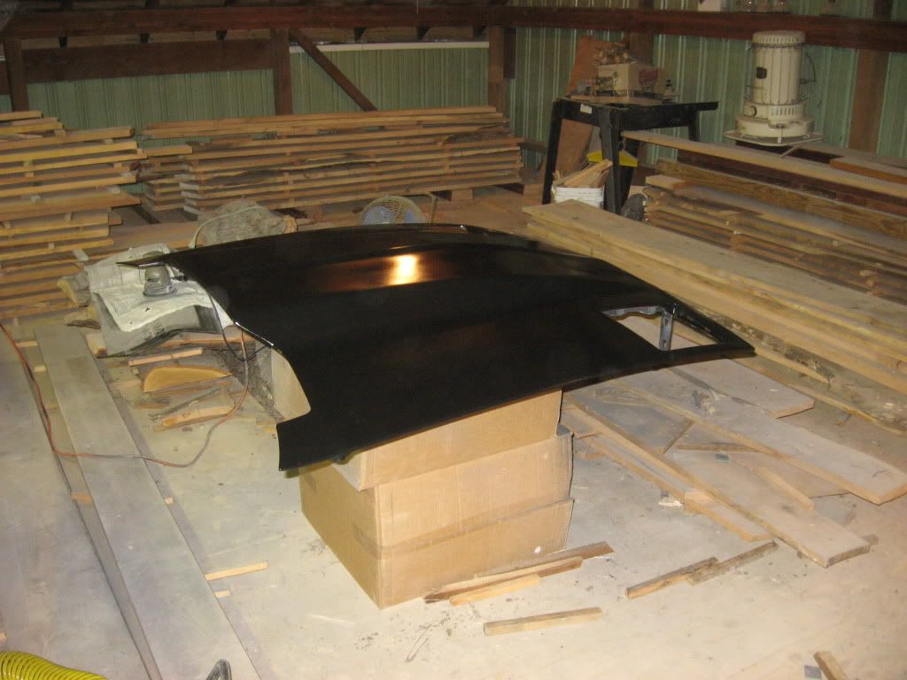

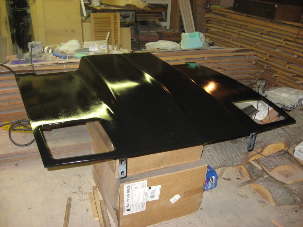

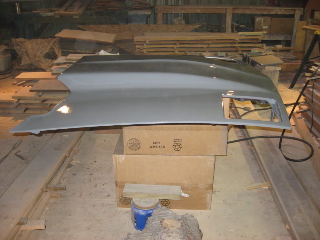

finally got a chance to paint her!
this was part of the old hood the cowl came from that i was using to get the gun set up the way i wanted. i didnt realize i left my camera sitting on there so it got a little over spray on it. my B.
im gonna go out and get a can of clear coat tommorrow and some 1500-2000 grit wet/sand paper. getting down to the short strokes

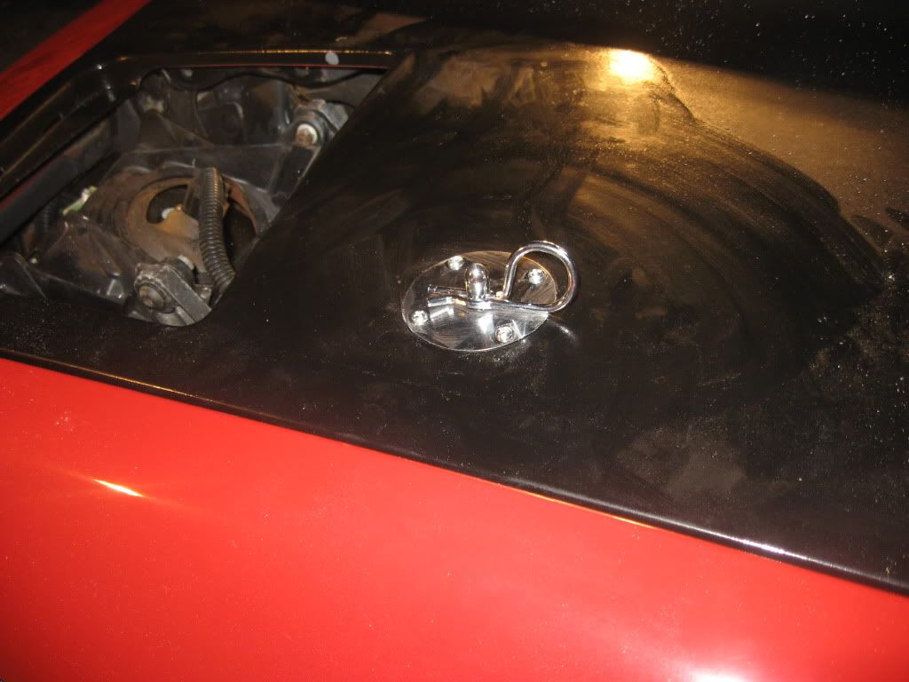

finally got a chance to get the new hood on. bit of a pain. but its on there.

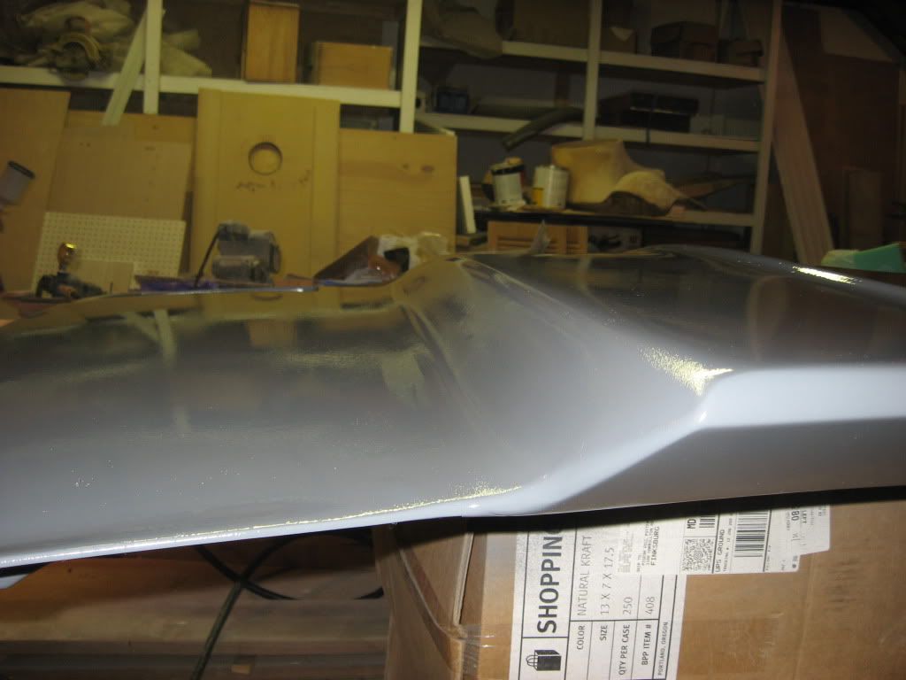

i think im going to go with this paint scheme because to me right now the hood looks a little outta place. and i think this will help tie everything together

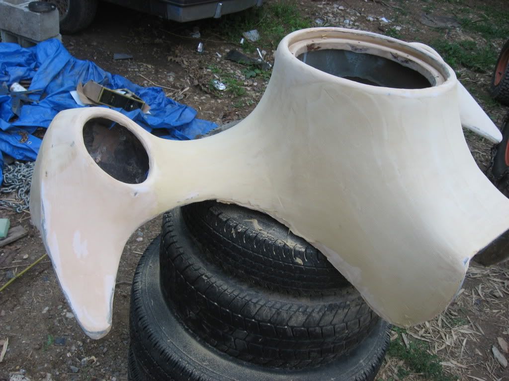

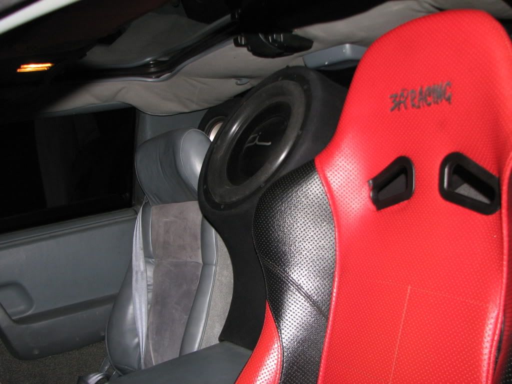

finally getting some time to work on finishing my sub box
here is the 29LB bad boy. 12" FI Q. i have a cadence Z7000 amp that will put 1500rms at a one ohm load. but im only going to wire it to a 2 ohm
load so she'll only get 750 rms. even still she is gonna sing
i have a layer of body filler on the enclusure. the only next step is do i want to go crazy sanding it out completly or fabric the box and save a ton of time.

got a layer on and the serious sanding has begun.

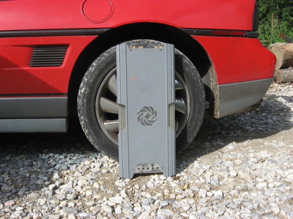

Cadence Z7000
1 x 50W @ 4 ohms
1 x 750W @ 2 ohms
1 x 1500W @ 1 ohms
its almost too long to fit behind the seat once i get the sub box in there too

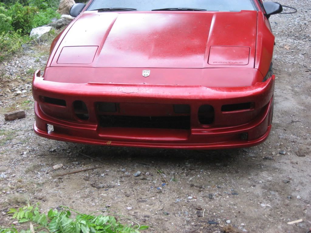

picked up a bumper from a local shop for cheap and thus begins a new project. im using an old fiero with no title to build it on so mine wont be tied up in the process. the bumper actually came from a car that won quite a few trophies until someone bumped a car in front of them and cracked it. im hoping to get a start on it soon

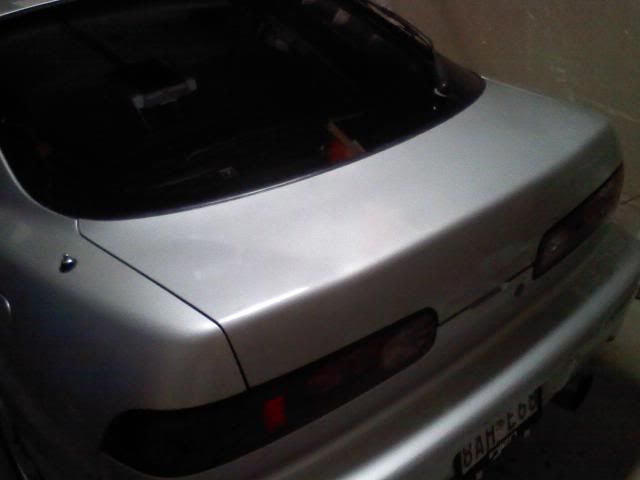

spent some time over the last couple days repainting my friends trunk. he took the spoiler off and wanted the mounting holes patched up. all together 8 holes patched up.
3 on each side then 2 small ones where the acura emblem was mounted. i do not like using metallic paint. its a pain to use.
we taped off the rubber trim on the hatch by the trunk then stuck tooth picks under it so it pushed it up away from the trunk while i painted it. im gonna go back tommorrow and wet sand and buff.
and BOO YAH his parents are gonna let me use their garage when i want to paint my car! pretty sweet trade in my opinion

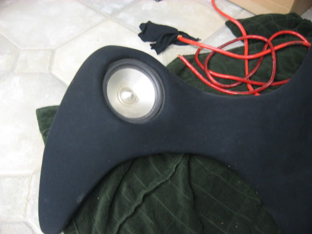

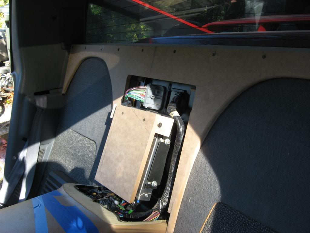

finally got around to working on the sub enclosure and speaker pods.
i screwed in little blocks to hold the piece in place.
took me almost 2 hours and 4 episodes of MASH to get the fabric on there just right. used spray glue.
i have it mounted in my car now and all that is left is hook up the wiring for the amp and sub. i need to find my old fuses in the attic and im set. should only take another hour or so once i get everything i need to finish. the speakers are hooked up and i love how they sound. they're right behind your head so i actually have the volume lower then i used to and i have hear it a lot better.

thanks! not gonna lie i know some of my mods are a bit tacky but im having a lot of fun doing them and learning a ton as i go. i learned so much about fiberglass from the sub box alone.
just got the driver seat mounted. had to cut and trim the bracket but luckily no welding was required just drilling new holes.
the sub is finally in there too! and oh does it pound. however i like to have all the settings turned down as much as possible so it adds to the music instead of over powering it. its sick listening to red hot chili peppers you can hear flea slapping every note.
