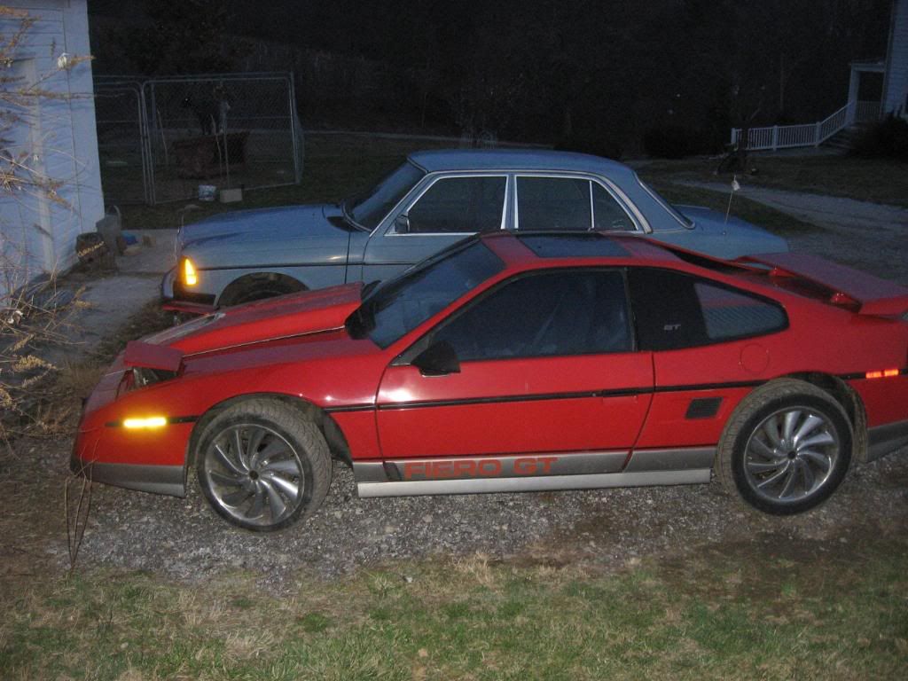

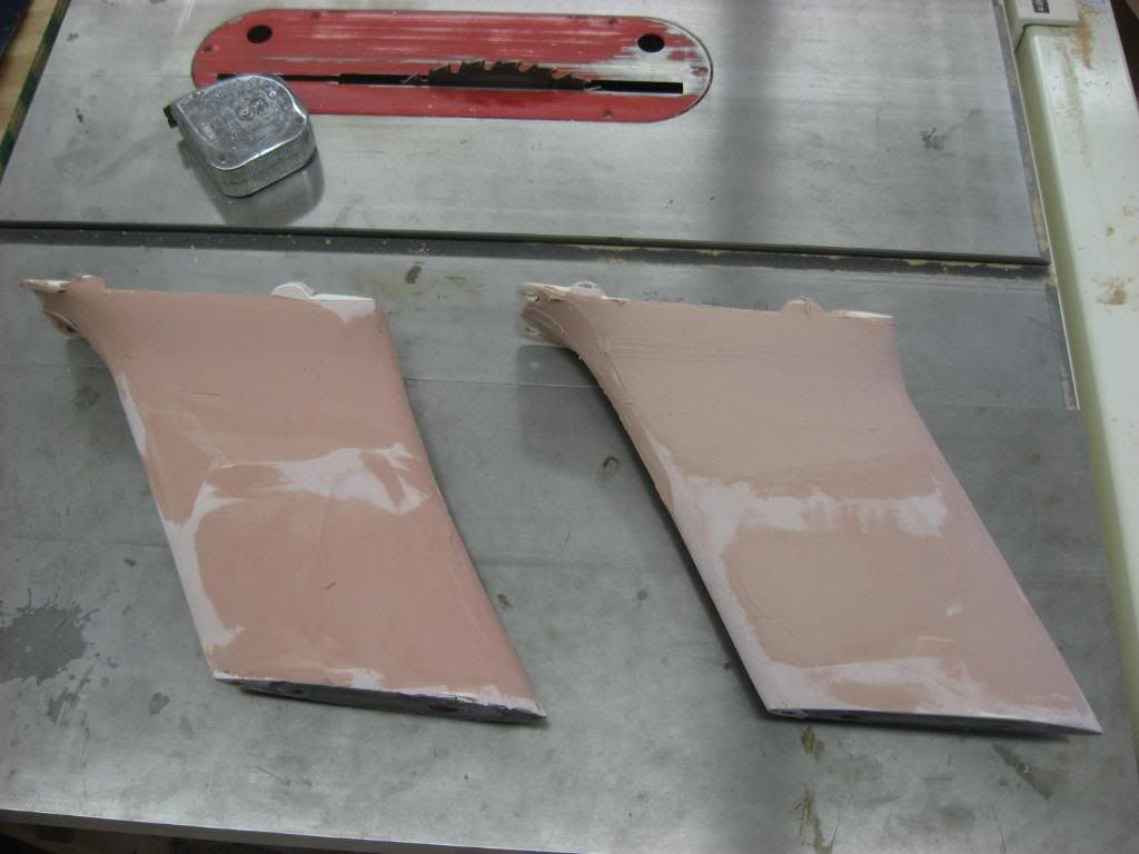

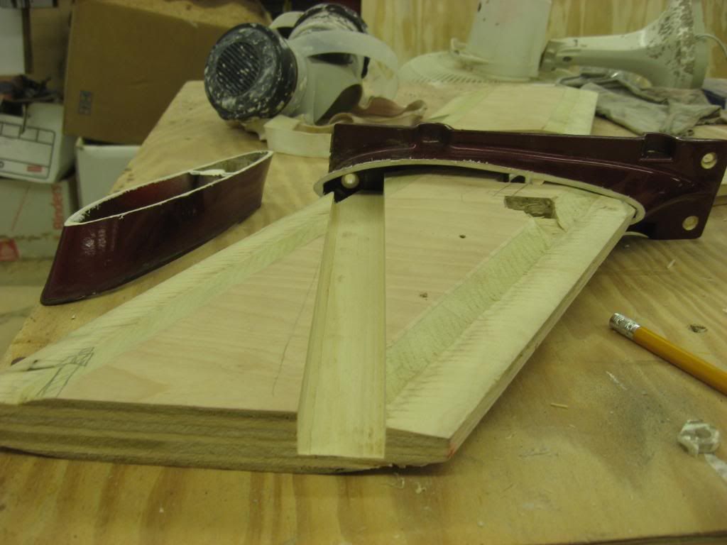

I must say that I am not a fan of giant wing stands. But, to each his own, and looks like you did a great job on yours. Very nice craftsmanship on your part. And welcome to the forum. Some great folks here. Nice looking car also.

thanks. had her for almost a year now. got quite a few other projects for her im working on that ill post on here soon

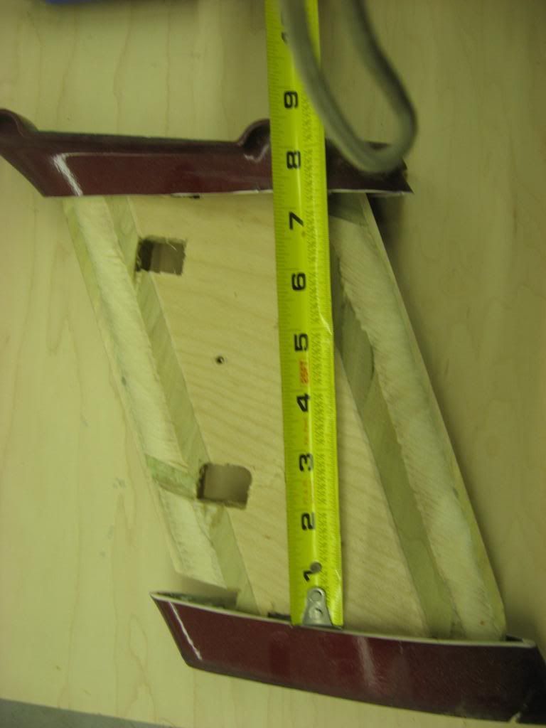

jebus, how tall are those things?
edit: i keep looking at the angle on the wing, it looks like the fronts a bit higher then the rear? or is it just the angle the pic was taken?

Nice work, very nice.
Not exactly my cup of tea. But, hey, to each his own. What matters is if you are pleased with the results.
Your workmanship appeared to be outstanding of those photos you shared.

they bring it up even with the roof.

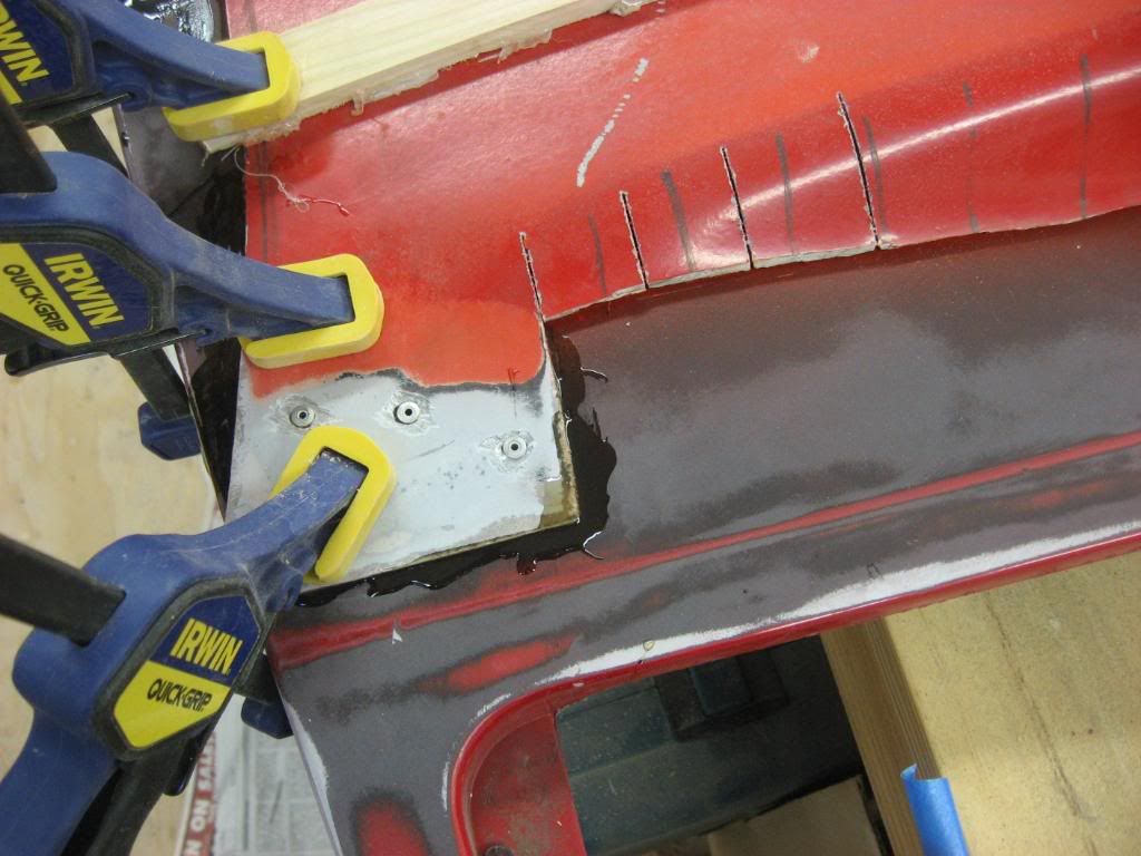

i had to shorten the cowl 5 inches to make it fit on the shorter fiero hood
used hot glue and wooden strips to make sure everything lined up while i put a layer of fiberglass on the inside

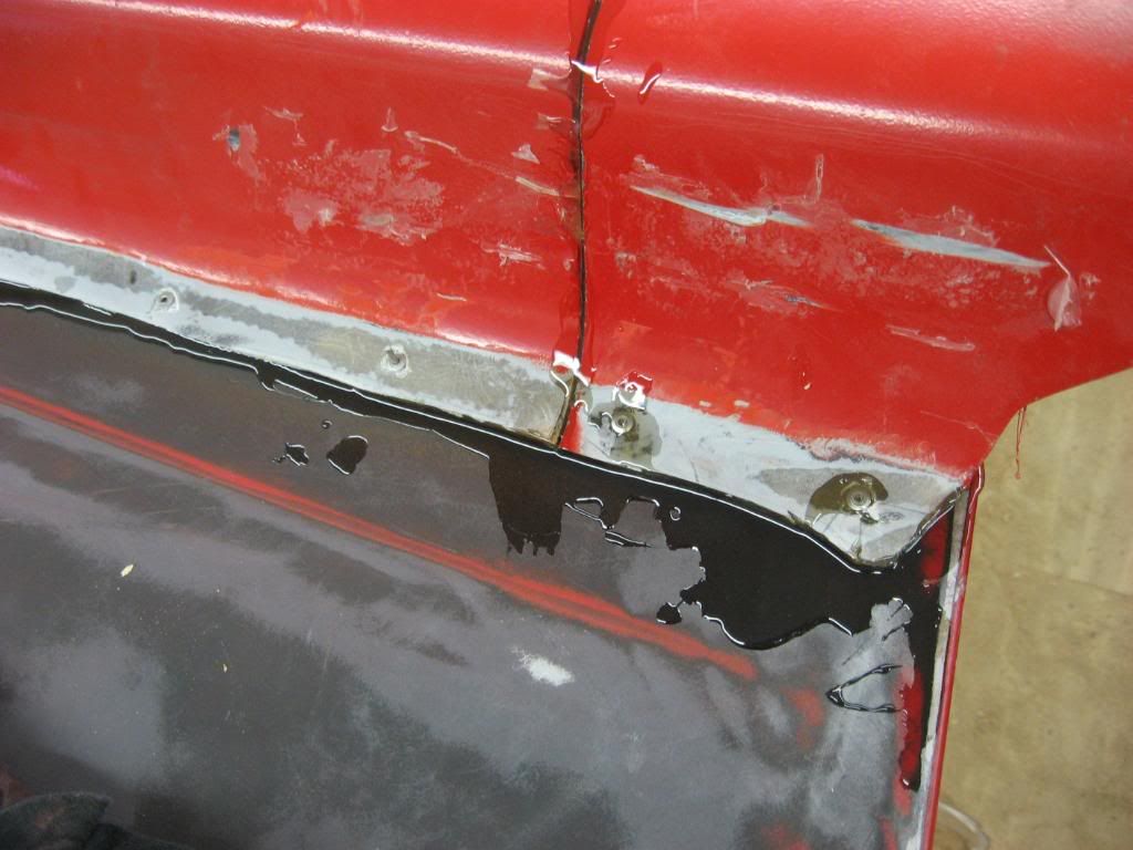

riveted and put a good bit of fiberglass resin to hold everything in place

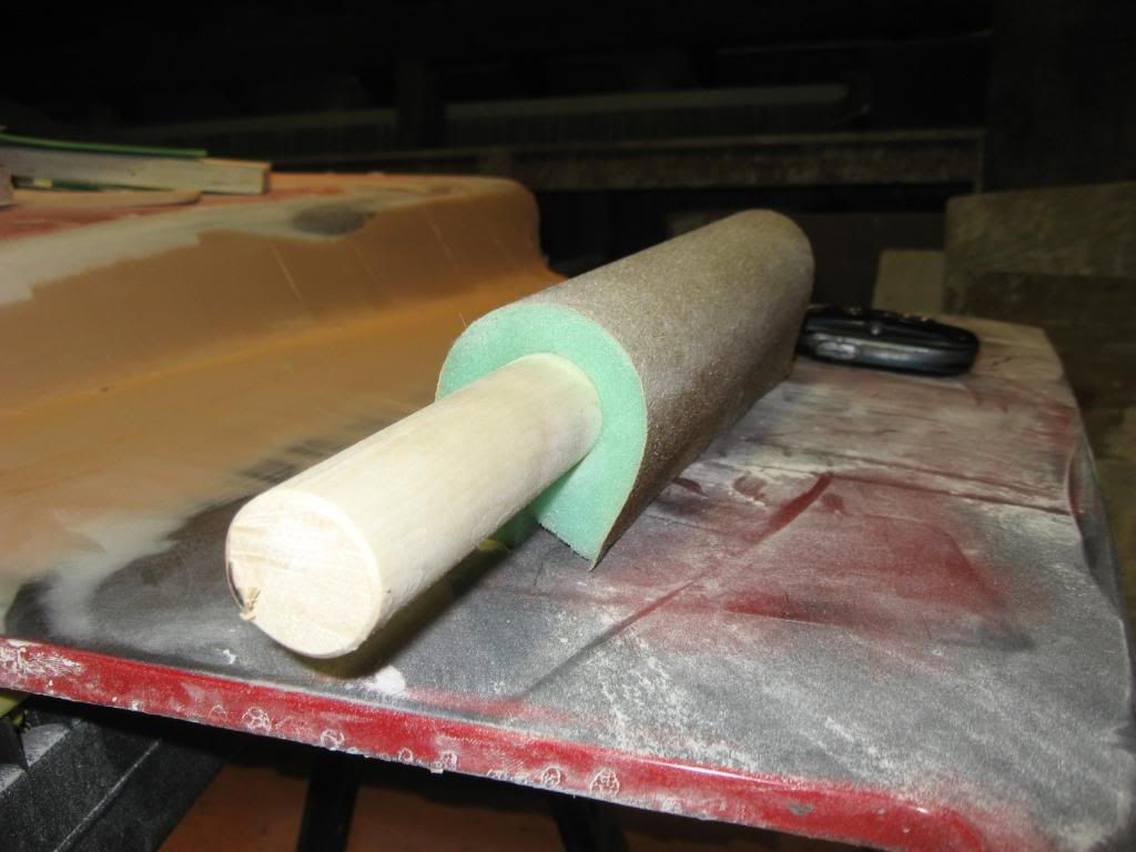

made myself a sanding thingy out of a dowl some 3/4 inch foam from the fabric store and some spray adhesive. works amazing
