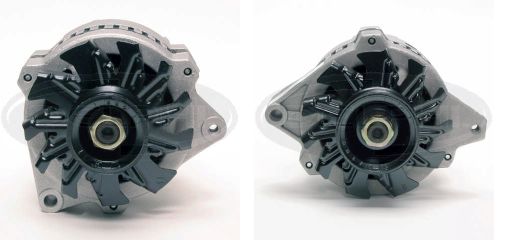

Did you get the right unit? 2.5L on left, 2.8L on right.
edit: The unit on left is for 87-88 2.5L only. All other years/models should take the one on right.
Ogre's cave has a bunch of information about the conversion and side by side photos of the CS and SI units. The mounting should be identical.
