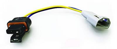

This is the adapter already made with both ends from Summit. + for you Spark1 but you already have one from me.

Thanks, TK. It’s certainly cheaper and maybe better (depending on the skill of the installer) to just replace the connector but the adapter makes the job much easier. Also gives the option of quickly putting the old unit back in if something goes wrong.
One downside to this conversion is that If the battery indicator lamp fails, the CS will not turn on. This is unlike the factory installed CS’s that use a third wire (I) to assure turn on. (The black wire shown in Hudini’s pic).

Yeah, I always watch for the lamp at bulb test but you can add a resistor across the bulb circuit that will make it charge in case the bulb burns out.
