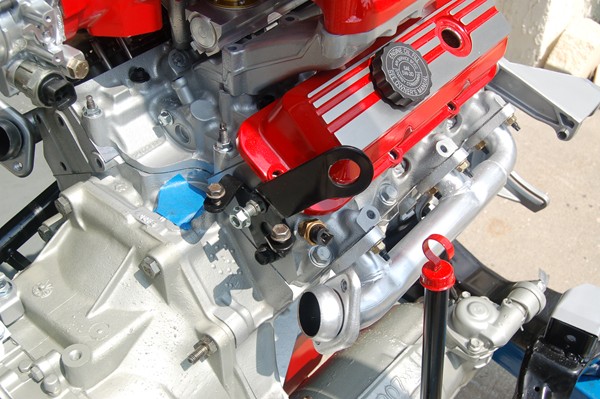

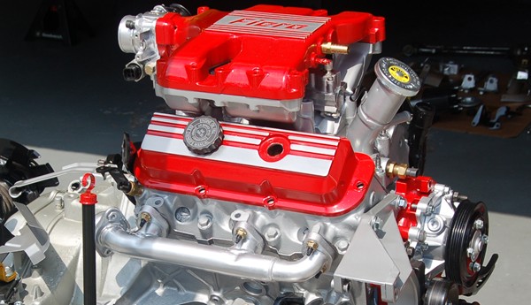

Nothing but VHT on my 3.4 rebuild, including the headers.
As others have mentioned already, meticulous cleaning and degreasing and prep are ESSENTIAL to good long lasting results.
In 800+ miles since the rebuild my headers have dulled down a little from heat, but are still just as silver.
The intake and valve covers were painted with a slight difference. They were cleaned and prepped and then shot with VHT red and then coated with high temp clear gloss wheel paint and baked in the oven at 200 degrees for a couple of hours. The finish is still high gloss and nearly "bulletproof".
I personally prefer painting my engine parts, as it is much easier to strip paint than powder coating if /when necessary and refinish the parts.

Thank You
I'm a little anal about building a *clean* engine.
Too bad most all of the effort is hidden once it's installed in the car.
More results from using VHT paints:

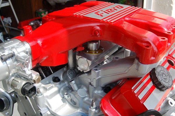

Note the casting lines have been removed from the upper intake manifold and the CSI and TB coolant lines have been deleted.
That also cleans up a lot of the original "clutter" of the engine.
I should have removed the casting lines from the middle intake manifold too...(oh well, another future project..)
Edit to add:
As ulanstan and others have mentioned, and I can't stress enough, PREPARATION of your parts is ESSENTIAL to long lasting, quality paint on engine parts.
All my engine parts were stripped to bare metal using TalStrip brand paint stripper, (VERY NASTY stuff), and then cleaned again with acetone. Most parts were further cleaned with steel wool, washed with detergent and hot water, blown dry with compresed air and then solvent cleaned *again* with acetone and air dried. *Then* painted.
One key trick to VHT paint is to lay on the first couple of passes as a light mist spray and then build up, finishing with a moderately "wet" coat. Don't try to coat the parts in one pass.
It dries extremely fast, and you don't need a lot of paint. You just need to lay it on evenly. Oven cure it and behold what beauty you have created
[This message has been edited by randye (edited 12-07-2008).]
