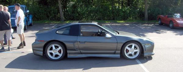

Here is a pic of Fie Ro.
He still has one of the nicest modded cars:
?? sorry, whats the point of your post? I think i missed something.

Report this Post11-16-2008 11:29 PM Click Here to See the Profile for HudiniSend a Private Message to HudiniDirect Link to This Post
I still don't know if the Fiero spare tire serves as accident protection. (I think the jury is still out on that one.)
Do people have pictures of heavy front end damage, where one can tell if/and how the tire is deformed. (i.e.: surprise meets with trees, or other cars. )
Maybe that would help.
