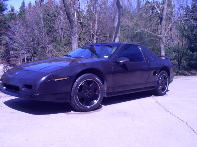

Here are some pics I took right before I washed it today. I should have taken them after I washed it.... no matter it'll be a lot better looking shortly..... I hope!

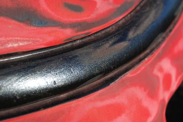

The questions I have are regarding body work. I took pictures of the areas that need attention and what I need help with is what products I should use to repair each place.
This spot I think the picture is pretty self explanatory.
Then there's this crack in the passenger side fender:
And then some surface cracking on the bumpers:
Could this be fixed with High Build 2K primer?
And the last thing I've noticed so far; a chip on the hood:

On the bumpers you have to strip off ALL of the cracked paint, if you don't want it to come back.
On repairs you have to use the correct product for the type of material the part is made of. That's different for SMC fiberglass & the plastic the fenders & such are made from.
The doors, fenders, & 1/4 panels are RRIM. I think the rockers/ground effects are TPO, They may have a product that works on both. Grind (slowly so as not to melt) the back of the crack with 24 grit, 1" around it (at least). If you don't have a grinder then hand sand with 24 grit, but you'll need a grinder later. Mix the repair material with a little chopped (with scissors) fiberglass mat for strength, & apply to the area about 1/8" thick (minimum) behind the crack. Once that dries, grind out the front of the crack in a "V" & fill in with the same repair material. Mat is not needed but dosen't hurt. Finish as you would any body repair.
For the SMC (hoods & top peices) use "Vette panel adhesive/filler".

Evercoat part # 870 to fill (instead of bondo) fiberglass & SMC panels. It says on the can to use "SMC panel adhesive # 994 or #995 to bond SMC panels".
SEM 39337to bond SMC to SMC or SMC to metal (requires a fairly expensive gun).
SEM 39708 for "RIM, PUR, TPUR, and other flexable parts". I assume that also means RRIM. (RIM are the rubber bumpers, RRIM are the doors, fenders, & 1/4 panels).

725franky
Posts: 69
From: Emmett, MI, USA
Registered: Apr 2008
Report this Post10-27-2008 05:15 AM Click Here to See the Profile for 725frankySend a Private Message to 725frankyDirect Link to This Post
What grit do you guys usually sand your primer with (I was thinking like 320)? Also can I just use the High Build 2K primer I have or do I *need* a base primer (like epoxy)?

725franky
Posts: 69
Report this Post10-31-2008 07:11 AM Click Here to See the Profile for 725frankySend a Private Message to 725frankyDirect Link to This Post
This is what the Formula looked like at the beginning of last night
Then I took the passenger side fender off:
And this is what I found on the back side of the fender:
They used some sort of mesh & resin to repair the crack. Now the question is do I just put filler on the front side, smooth it out and use it; or, do I need to somehow remove the repair and re-do it myself (so I can be sure it's right)?
What does everyone do to "repair" the "molding part of the bumper? There are a lot of scratches / gouges on it. Should I fill it or just leave it?

darkhorizon
Posts: 12279
From: Flint Michigan
Registered: Jan 2006
Total ratings: 451
Report this Post10-31-2008 08:58 AM Click Here to See the Profile for darkhorizonSend a Private Message to darkhorizonDirect Link to This Post
They make a plastic bondo type filler that I have been using on my trim pieces...
I am also repainting my 88coupe right now, I took nearly all the panels off as a bunch of my friends are working on it with me, so it makes it alot easier. Painting the front and rear will be easier off the car too.
I am going with a black epoxy primer, a high build urethane surfacer, and then going to use that black epoxy primer as a sealer. Going with a matrix/ppg strong black then a gallon and a half of MS20 high performance clearcoat. $480 at the paint store... Not bad, but not as cheap as lacquer.
