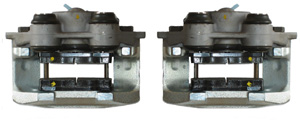

Here's my brake problem & plans to fix it. Please let me know if I'm on the right track
Problem:
Left front caliper is sticking every now & then. When I apply the brakes harder than normal (ie: someone cut you off) the caliper won't release fully. I can feel the car pulling to the left, when I park, I can smell the hot brake pads. In fact, have seen them smoking. It is taking longer to stop, so it's time to take action.
The 88 Formula has 105k miles on it.
The plan to fix:
1. Order from www.CalpersOnline.com , front & rear loaded caliper sets
Loaded 1988 Front $ 125.00 (no core charge)
Loaded 1988 Rear $ 150.00 ( $200 core charge )
2. Order from Advanced Auto Left & right brake line (p/n H38653 & H38644)
3. Order from www.Fierostore.com (4) 1988 rotors
Would you all do anything different ? I've seen posts about using front calpers on rear. Not sure I want to get rid of E-brake.
( Not looking to spend ton''s of money - Hey, I'm a Fiero owner)

Looks like you have everything covered, new calipers and hoses all around.
Be sure to flush your system out and get rid of all the old junk in the lines and master.

That looks good. Looks like you have everything covered.
It sounds like just a rubber line and maybe the caliper slides need to be greased. You can try that fix for under 50 bucks (new line and pads), before spending all of that.

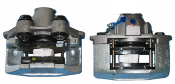

** update **
Took the wheel off today & inspected the situation.
As photo's show, the slides were dry, & pads are about half way done.
Used a high temp lube on them. Will see if this works, will order hose next if needed.
