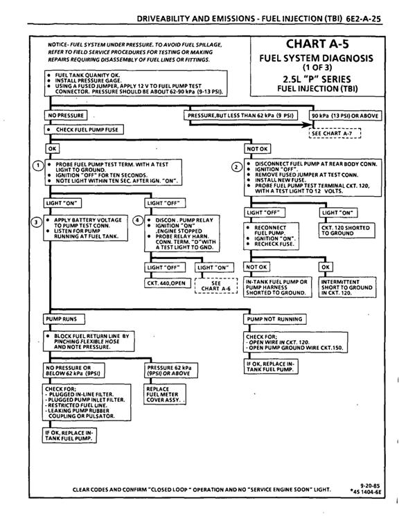

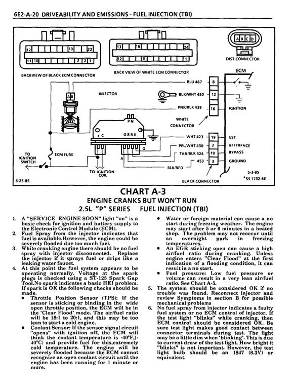

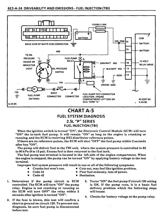

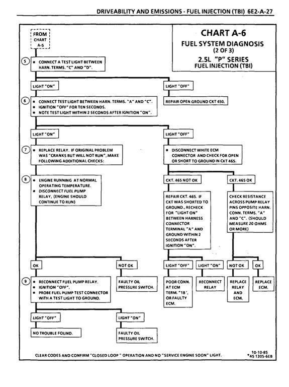

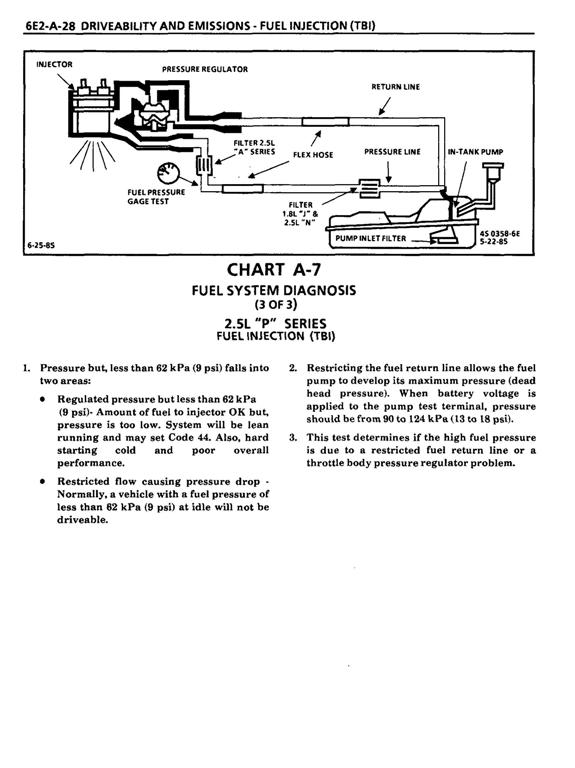

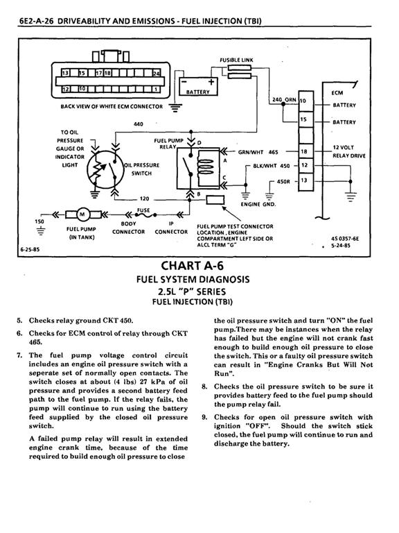

These may help. They are from a 86 service manual.
OUCH! Large pics
