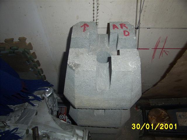

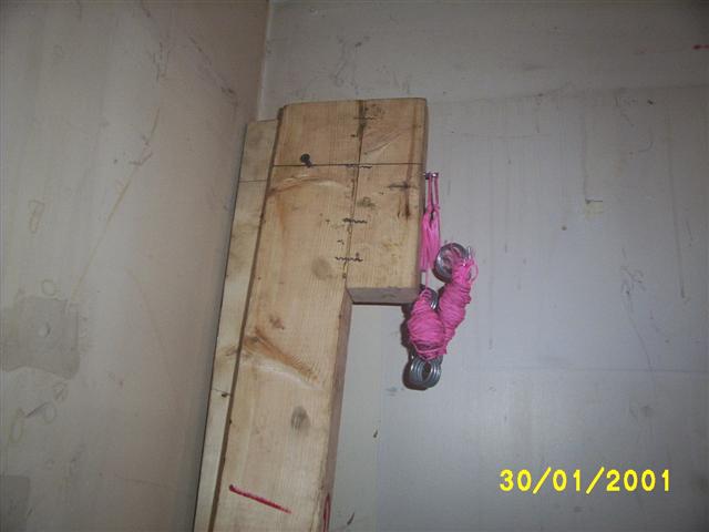

You beat me to the line , i was gonna send him yours.
BTW i did it on my car . looks alright so far .
I used deck block with 2x4 and at each end i added a piece of 8 inches long and 2 1/2 thick to get right at the center of the hub .
They are very stable and you can give a lot of tension on the string too without moving them
And for the adjustment you just slide the 2x4 in the slot
Ho and before i forget thanks for rating me good Dodgerunner

I like those block! I usually slip the board though a hole in a block to add some weight so I can pull the string tight.
Pardon my ignorance
[This message has been edited by Robert 2 (edited 05-27-2008).]

for the guy above: what is meant is that he likes the cement blocks because they
allow for added tension on the string when you slip the 2x4 in.

OK now i understand he should had said " slot " instead of " hole " cause there is a hole in the block too
This is what i'm saying in my answer up there .
It's the hole that got me confused
I was wondering how can you pass a 2x4 in a 1 1/2 dia hole
sorry
