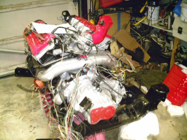

My84
Posts: 221
From: Billings, Mt
Registered: May 2008
Report this Post05-20-2008 12:42 AM Click Here to See the Profile for My84Click Here to visit My84's HomePageSend a Private Message to My84Direct Link to This Post
here a a couple of Oil Pan Shots. Tell me what u think.
Both of those are looking toward the passenger side of the car, or toward the #1 cylender.
If anyone has a clue what might have gone wrong post here.
tomorrow ill post pics of what it looks like inside, gonna make comments to those pics.
let the guessing game begin.
Thanks Steven

So sorry to read about your Iron Duke demise. I may have a solution for you I am with in days of pulling the entire power train out of my 85 Fiero Se to install this.
So I have a clean no rust cradle with a 2.8 V6 with less than 15000 on a complete rebuild a 5 speed Isusu tranny (bad 5th gear) and shifter with cables, complete wiring harness and ECM, complete exhaust with the exhaust manifolds rewelded and hogged out, and the entire rear suspension that I do not need anymore.
I live in Coeur d'Alene, Idaho which about 300 miles from you.
If you are interested contact me either PM of email me at sokolja@adelphia.net.
By the way the picture is of my 96 3.4 DOHC on an 88 cradle with a Beratta Getrag tranny that I am installing
