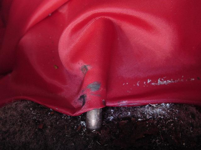

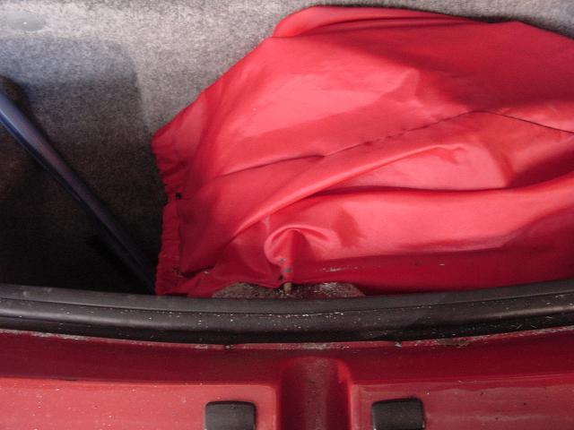

the relay does click.
I couldn't hear it until I took it out from under the dash,
but it's clicking away every time I bump the trunk switch.
This leads me to think
that big darn nylon bag
I threw in there is blocking the latch,
and the ground.
That means I'll go the way of key extraction.
It's possible the latch was obstructed
by the nylon bag and couldn't release
when I tried "hot-wiring" the solenoid . .. hopefully a key will be able to unlock it.

Or the bag is blocking the strike from grounding. Without in grounding it's not going to fire.
Not sure it there is somewhere to touch to make a ground externally.

Guess it depends on how much stuff is in the trunk, someone else said they pushed the drain plug up that is in the bottom of the trunk. They then pushed up the side of the liner and where able to reach the latch.
You might be able to do that to get a ground up to touch the latch.
Might need skinny arms.

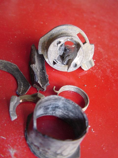

well i got the cylinder out
i read that's the easy part
putting that horse-shoe clip back on might take a few hours
Now i have a question:
stamped not on the cylinder, but the thin part which levers the arm connecting the cylinder to the control of the lock,
there is stamped a letter, followed by four numbers
BXXXX
is this the key code?
I have to figure out how to get the key out,
now that i have the cylinder in my hand.
It doesn't look easy to disassemble.

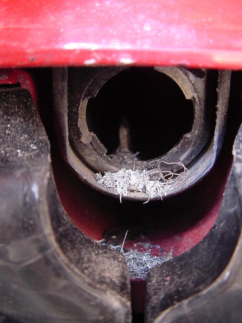

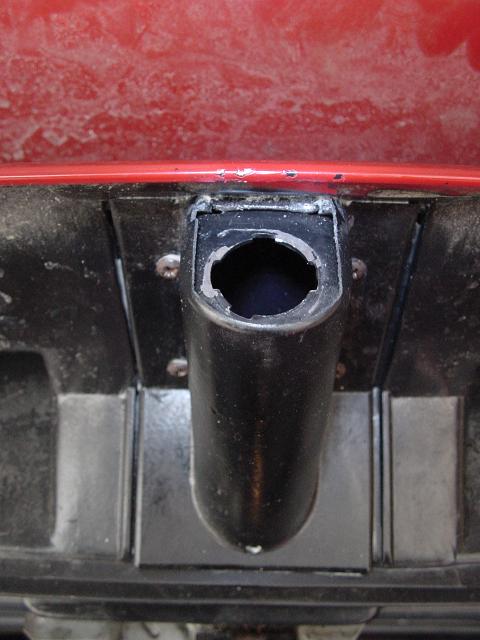

Now I got my stuff, and here are some pictures to tell the rest:
Yes- that is a stretched out spring from the lock cylinder. Rod in background.
WELL LOOKS LIKE I FOUND THE PROBLEM
darn it! gotta be more careful. now i know- it's grounded!
This is what I am working with to install the new lock.
The damage does not look too severe;
the plastic that broke from the lock
might even come with the lock- if not where can I get that?
Anything else you see I will need to replace?
Pic of the parts I mangled . . .
The black plastic might come with the new lock, and the metal sleeve looks salvageable,
although it also looks like it might come with the new lock.
I'll use some red nail polish to touch up those nicks.

Report this Post03-11-2008 12:46 AM Click Here to See the Profile for KutaClick Here to visit Kuta's HomePageSend a Private Message to KutaDirect Link to This Post
That's a really good idea.
I had no idea my bag obstructed the
bolt when I threw it in there, or when
I closed the trunk. It was dark in the
garage, and the excess material got
in the way sometime after I threw it
in.
Since it was not thick nylon, the
trunk closed fine. Now I know.
I can only think it's grounded that way
so you don't fire the solenoid when it's
already open- but I've had it mis-fire &
had to push teh trunk closed again just
so it could fully open
So I might do that too. Ground is close enough!
