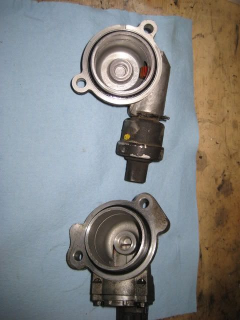

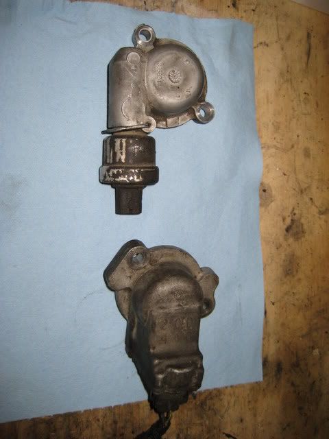

Well, this is the best I can do for you. I pulled the cap off the 4T60 that is in the car. I don't have the TH125 cap anymore so the below pictures show the cap you want on the left and the pulse type that won't work on the right. BTW this is my first time posting picts so forgive me if it doesn't come out right.

Dang ahawkman!! I didn't mean for you to take yours apart!!
But thanks, that's what I wanted to know. So I really DIDN'T find the right one today.
The one I need looks almost identical to the 125 except the mounting holes. Too bad tomorrow is Sunday or I would have the last piece of my puzzle.
Thanks again!!
BTW, pictures are perfect!!

Thats the first time Ive actually ever seen the right cover! Thanks!
