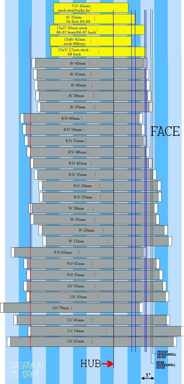

The Diamond wheels used on the 88 Formulas and GTs...
The '88 front wheels are 15 x 6 x 37mm
The '88 rear wheels are 15 x 7 x 30mmAny source that tells you otherwise is wrong. Flat out wrong.
The Online Service Guide........ Is wrong.
Steven Snyder's belief that the 88 fronts have a 42mm offset........ Is wrong.
Joe Torma's diagram posted by 3.6lvvt6spdgt........ Is wrong.
