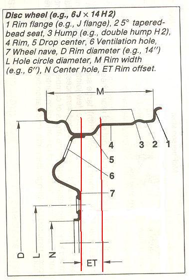

here is a sketch

This may help also. https://www.fiero.nl/forum/Forum1/HTML/058236.html
Not my diagrams. I believe credit goes to Joe Torma.
