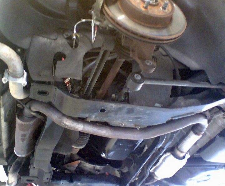

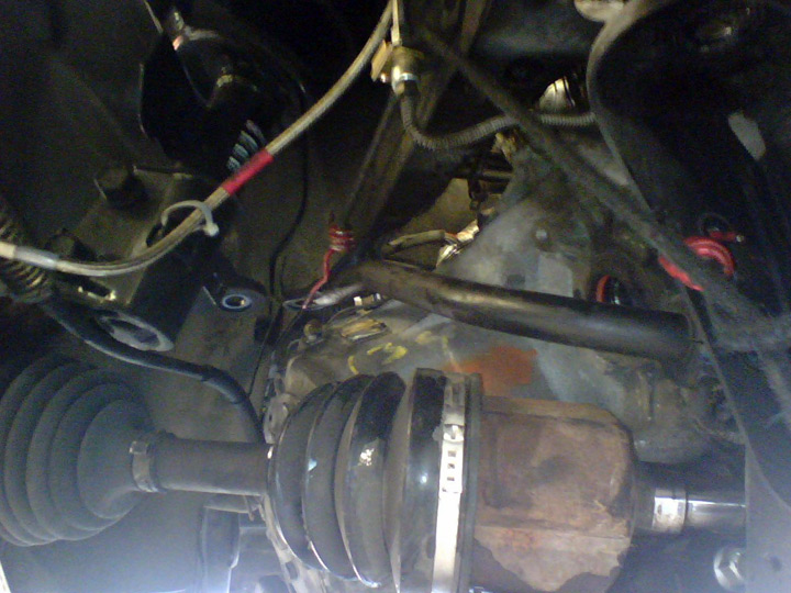

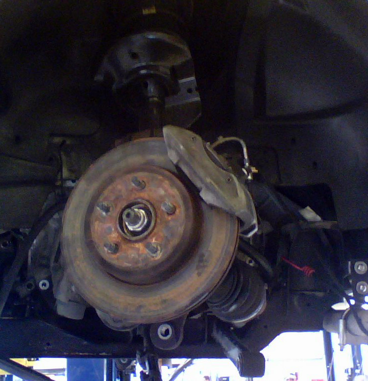

Here are some picts of a fiero that is getting a new fork put in.
Good luck!
